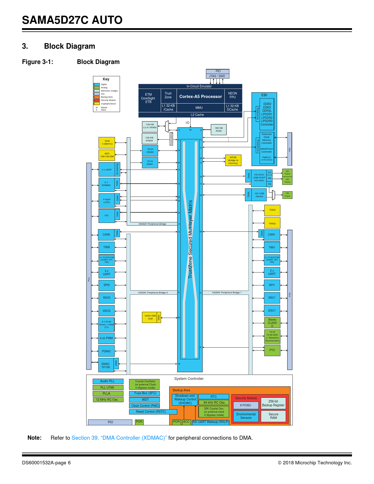

SAMA5D27C AUTO. Block Diagram. Figure 3-1:. Key. Cortex-A5 Processor. Note:
SAMA5D27C AUTO Block Diagram Figure 3-1: Key Cortex-A5 Processor Note:
link to page 675
SAMA5D27C AUTO 3. Block Diagram Figure 3-1: Block Diagram
PIO JTAG / SWD
Key
Digital In-Circuit Emulator Analog Memories, bridges PIO Trust NEON ETM EBI Backup Area Zone
Cortex-A5 Processor
FPU CoreSight Security Module ETB Cryptoprocessor DDR2 L1 32-KB L1 32-KB M Master MMU DDR3 S Slave ICache DCache DDR3L L2 Cache LPDDR1 LPDDR2 Scrambling LPDDR3 I/D 128 KB Controller L2 or SRAM 160 KB S M S ROM Reduced 128 KB Static S S SHA SRAM Memory Controller 1/256/512 Scrambling S 16-ch NANDFlash M Scrambling PIO DMA0 Controller AES 128/192/256 AESB PMECC M (9 KB SRAM) 16-ch (Bridge to M S DMA1 memory) 2 x QSPI S HS PC Scrambling HS EHCI Trans M DMA USB HOST PB HS HS HSIC 2 x Trans M S PA SDMMC DMA HS USB HS M DMA Device Trans M 4-layer DMA M LCDC TDES M ISC DMA H64MX Peripheral Bridge S TRNG S M CAN0 DMA CAN1 DMA TWI0 TWI1 2 x FLEXCOM 3 x FLEXCOM (USART, SPI, (USART, SPI, TWI) TWI) 3 x 2 x UART UART O rustZone Secured Multilayer Matrix PI T PIO SPI0 SPI1 H32MX Peripheral Bridge 0 S S H32MX Peripheral Bridge 1 PIO SSC0 SSC1 PI O I2SC0 I2SC1 SHA1/256 M ICM DMA Stereo 6 x 32-bit CLASS Timers + PWM D (TC) 12-ch 12-bit ADC 4-ch PWM (+ Resistive Touchscreen) S PDMIC PTC EMAC M DMA 10/100 System Controller Audio PLL Crystal Oscillator (or external Clock PLL UTMI in Bypass mode) Backup Area PLLA Fuse Box (SFC) Shutdown and RTC Security Module 12 MHz RC Osc. WDT Wakeup Control 256-bit (SHDWC) 64 kHz RC Osc. Clock Control (PMC) 8 PIOBU Backup Register 32K Crystal Osc. Reset Control (RSTC) (or external clock Environmental Secure in Bypass mode) Sensors RAM PIO POR POR ACC RX UART Wakeup (RXLP)
