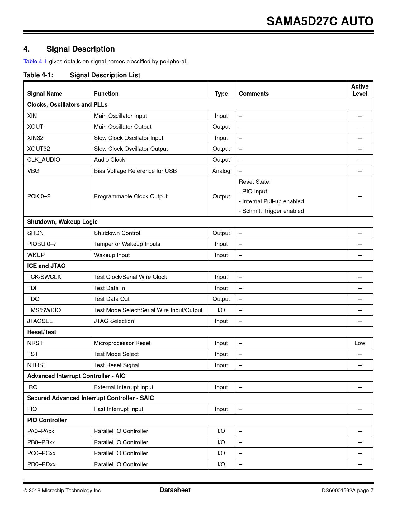

SAMA5D27C AUTO 4. Signal Description
Table 4-1 gives details on signal names classified by peripheral.
Table 4-1: Signal Description List Active Signal Name Function Type Comments Level Clocks, Oscillators and PLLs
XIN Main Oscillator Input Input – – XOUT Main Oscillator Output Output – – XIN32 Slow Clock Oscillator Input Input – – XOUT32 Slow Clock Oscillator Output Output – – CLK_AUDIO Audio Clock Output – – VBG Bias Voltage Reference for USB Analog – – Reset State: - PIO Input PCK 0–2 Programmable Clock Output Output – - Internal Pull-up enabled - Schmitt Trigger enabled
Shutdown, Wakeup Logic
SHDN Shutdown Control Output – – PIOBU 0–7 Tamper or Wakeup Inputs Input – – WKUP Wakeup Input Input – –
ICE and JTAG
TCK/SWCLK Test Clock/Serial Wire Clock Input – – TDI Test Data In Input – – TDO Test Data Out Output – – TMS/SWDIO Test Mode Select/Serial Wire Input/Output I/O – – JTAGSEL JTAG Selection Input – –
Reset/Test
NRST Microprocessor Reset Input – Low TST Test Mode Select Input – – NTRST Test Reset Signal Input – –
Advanced Interrupt Controller - AIC
IRQ External Interrupt Input Input – –
Secured Advanced Interrupt Controller - SAIC
FIQ Fast Interrupt Input Input – –
PIO Controller
PA0–PAxx Parallel IO Controller I/O – – PB0–PBxx Parallel IO Controller I/O – – PC0–PCxx Parallel IO Controller I/O – – PD0–PDxx Parallel IO Controller I/O – –  2018 Microchip Technology Inc.
