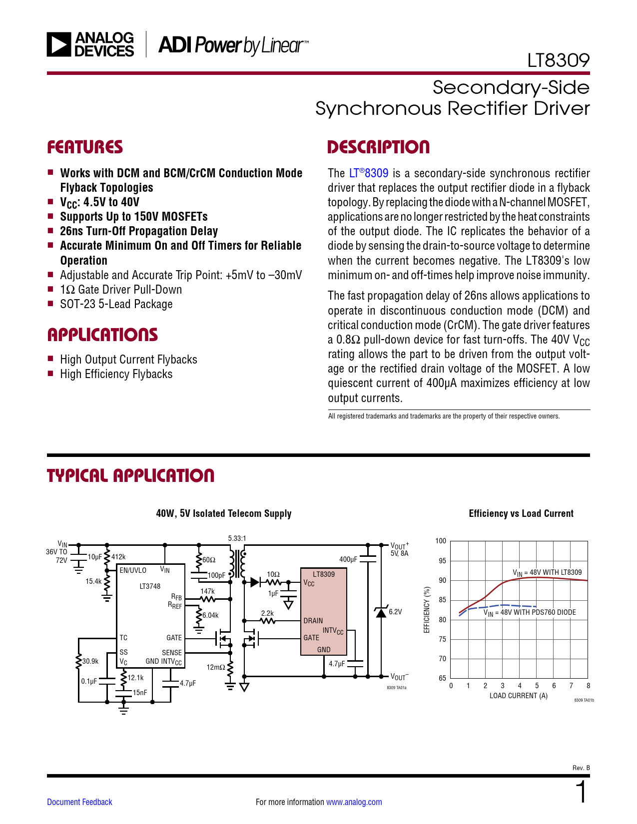

TYPICAL APPLICATION 40W, 5V Isolated Telecom Supply Efficiency vs Load Current
