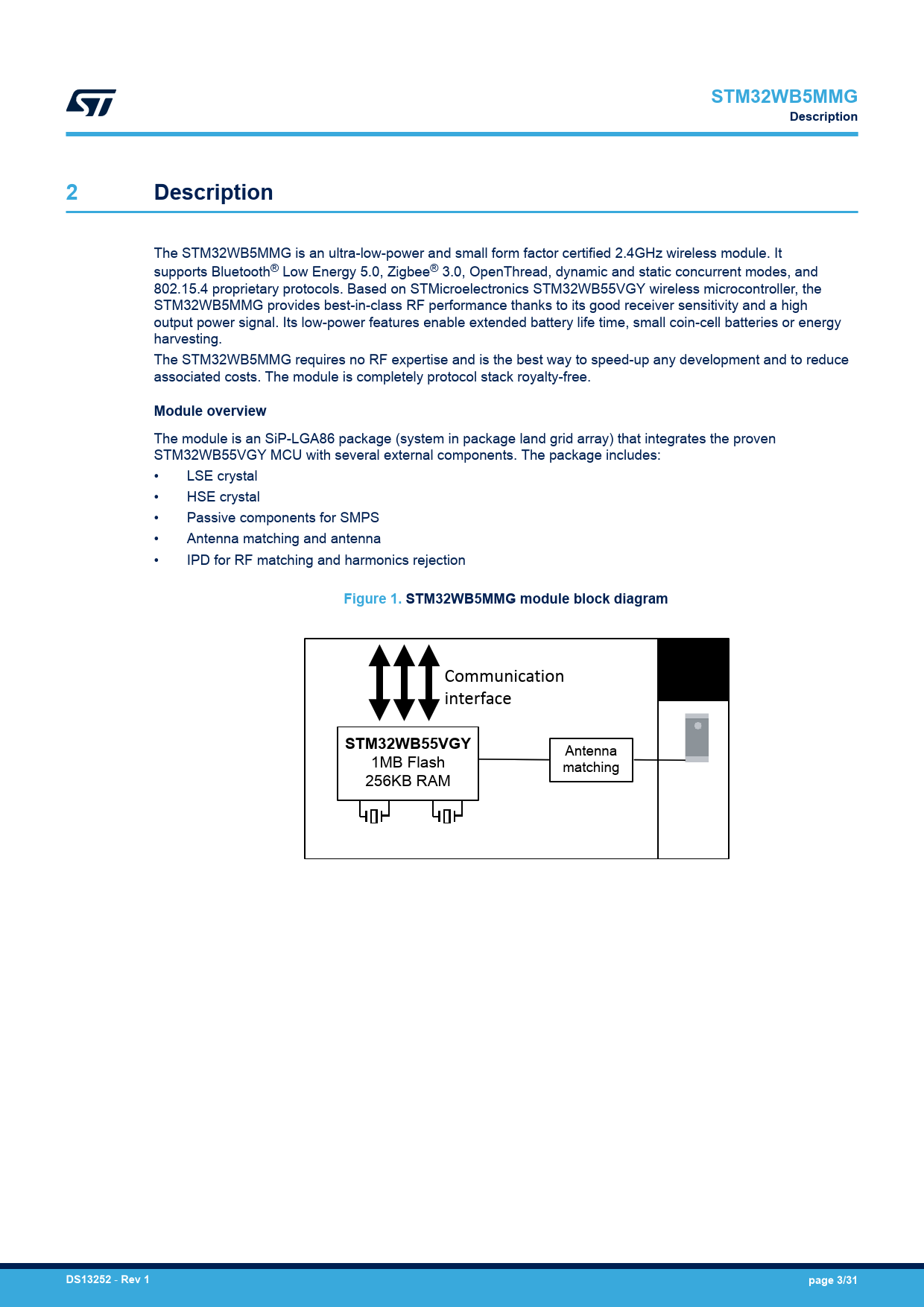

STM32WB5MMG Description 2 Description
The STM32WB5MMG is an ultra-low-power and small form factor certified 2.4GHz wireless module. It supports Bluetooth® Low Energy 5.0, Zigbee® 3.0, OpenThread, dynamic and static concurrent modes, and 802.15.4 proprietary protocols. Based on STMicroelectronics STM32WB55VGY wireless microcontroller, the STM32WB5MMG provides best-in-class RF performance thanks to its good receiver sensitivity and a high output power signal. Its low-power features enable extended battery life time, small coin-cell batteries or energy harvesting. The STM32WB5MMG requires no RF expertise and is the best way to speed-up any development and to reduce associated costs. The module is completely protocol stack royalty-free.
Module overview
The module is an SiP-LGA86 package (system in package land grid array) that integrates the proven STM32WB55VGY MCU with several external components. The package includes: • LSE crystal • HSE crystal • Passive components for SMPS • Antenna matching and antenna • IPD for RF matching and harmonics rejection
Figure 1. STM32WB5MMG module block diagram
Communication interface
STM32WB55VGY
Antenna 1MB Flash matching 256KB RAM
DS13252
Rev 1 page 3/31
