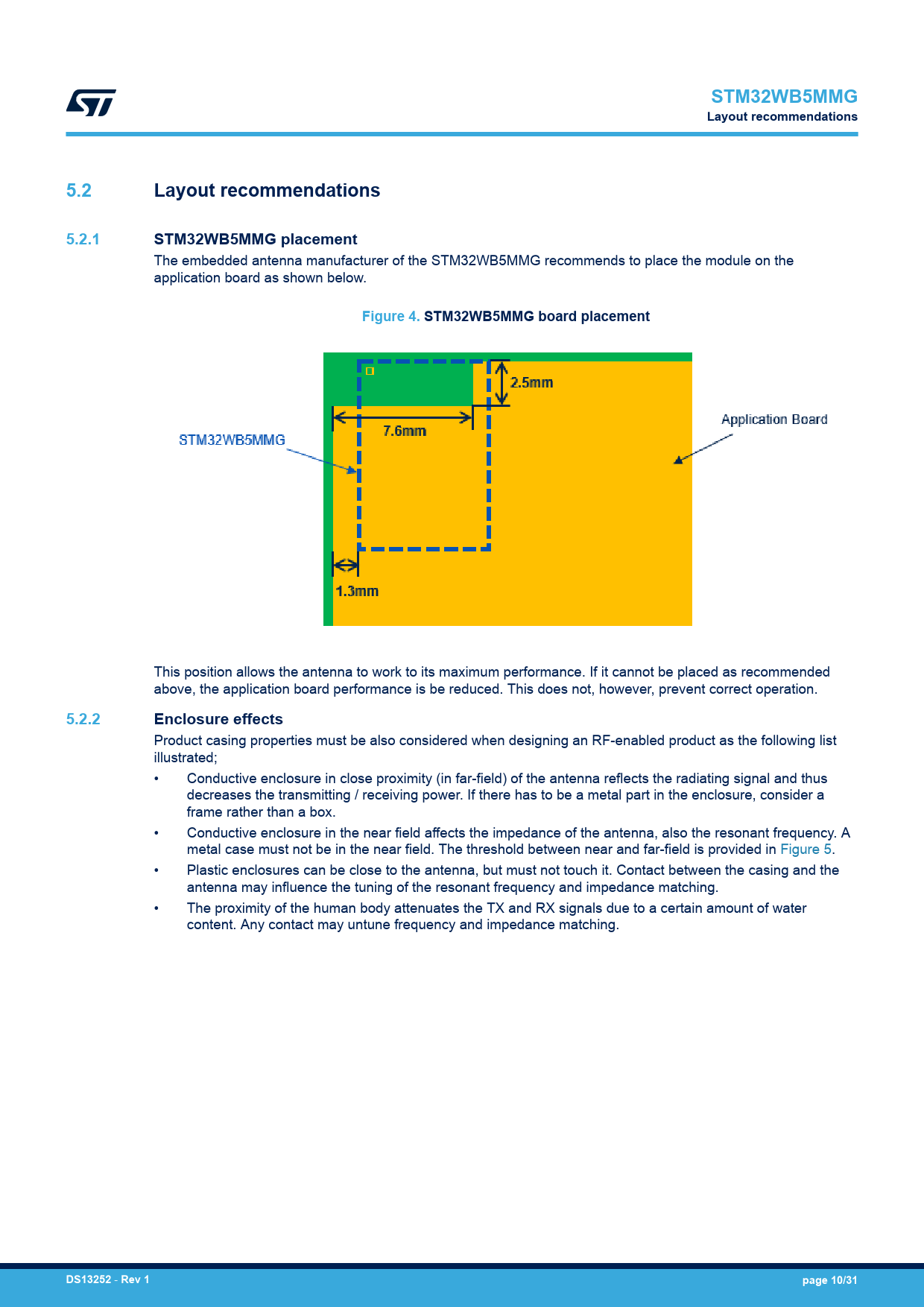

STM32WB5MMG Layout recommendations 5.2 Layout recommendations 5.2.1 STM32WB5MMG placement
The embedded antenna manufacturer of the STM32WB5MMG recommends to place the module on the application board as shown below.
Figure 4. STM32WB5MMG board placement
This position allows the antenna to work to its maximum performance. If it cannot be placed as recommended above, the application board performance is be reduced. This does not, however, prevent correct operation.
5.2.2 Enclosure effects
Product casing properties must be also considered when designing an RF-enabled product as the following list illustrated; • Conductive enclosure in close proximity (in far-field) of the antenna reflects the radiating signal and thus decreases the transmitting / receiving power. If there has to be a metal part in the enclosure, consider a frame rather than a box. • Conductive enclosure in the near field affects the impedance of the antenna, also the resonant frequency. A metal case must not be in the near field. The threshold between near and far-field is provided in Figure 5. • Plastic enclosures can be close to the antenna, but must not touch it. Contact between the casing and the antenna may influence the tuning of the resonant frequency and impedance matching. • The proximity of the human body attenuates the TX and RX signals due to a certain amount of water content. Any contact may untune frequency and impedance matching.
