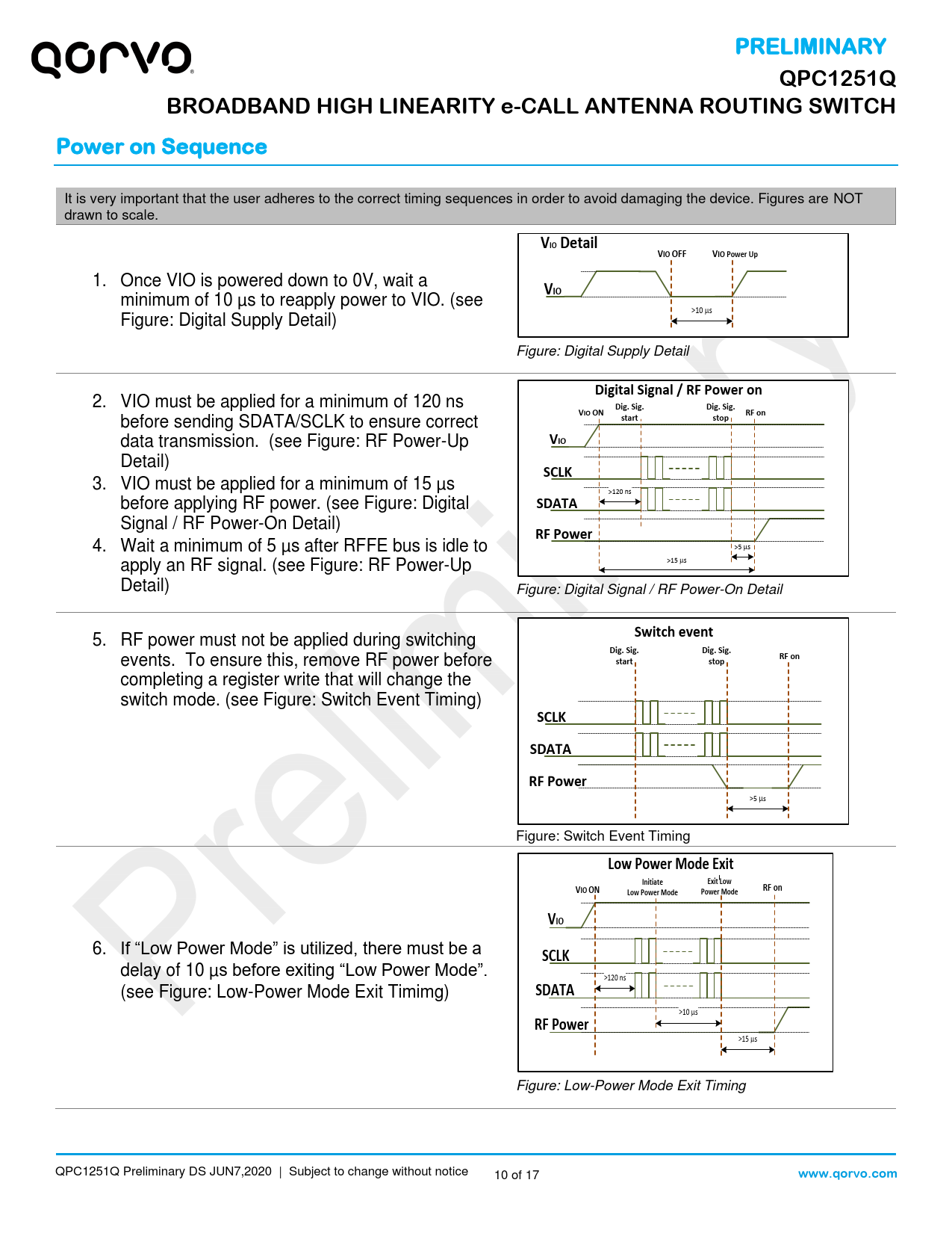

PRELIMINARY QPC1251Q BROADBAND HIGH LINEARITY e-CALL ANTENNA ROUTING SWITCH Power on Sequence
It is very important that the user adheres to the correct timing sequences in order to avoid damaging the device. Figures are NOT drawn to scale.
VIO Detail VIO OFF VIO Power Up
1. Once VIO is powered down to 0V, wait a
VIO
minimum of 10 µs to reapply power to VIO. (see >10 ms Figure: Digital Supply Detail) Figure: Digital Supply Detail
Digital Signal / RF Power on
2. VIO must be applied for a minimum of 120 ns
Dig. Sig. Dig. Sig. VIO ON RF on
before sending SDATA/SCLK to ensure correct
start stop
data transmission. (see Figure: RF Power-Up
VIO
Detail)
SCLK
3. VIO must be applied for a minimum of 15 µs >120 ns before applying RF power. (see Figure: Digital
SDATA
Signal / RF Power-On Detail)
RF Power
4. Wait a minimum of 5 µs after RFFE bus is idle to >5 ms apply an RF signal. (see Figure: RF Power-Up >15 ms Detail) Figure: Digital Signal / RF Power-On Detail
Switch event
5. RF power must not be applied during switching
Dig. Sig. Dig. Sig.
events. To ensure this, remove RF power before
RF on start stop
completing a register write that will change the switch mode. (see Figure: Switch Event Timing)
SCLK SDATA RF Power
>5 ms Figure: Switch Event Timing
Low Power Mode Exit Initiate Exit Low VIO ON Low Power Mode Power Mode RF on VIO
6. If “Low Power Mode” is utilized, there must be a
SCLK
delay of 10 µs before exiting “Low Power Mode”. >120 ns (see Figure: Low-Power Mode Exit Timimg)
SDATA
>10 ms
RF Power
>15 ms Figure: Low-Power Mode Exit Timing
