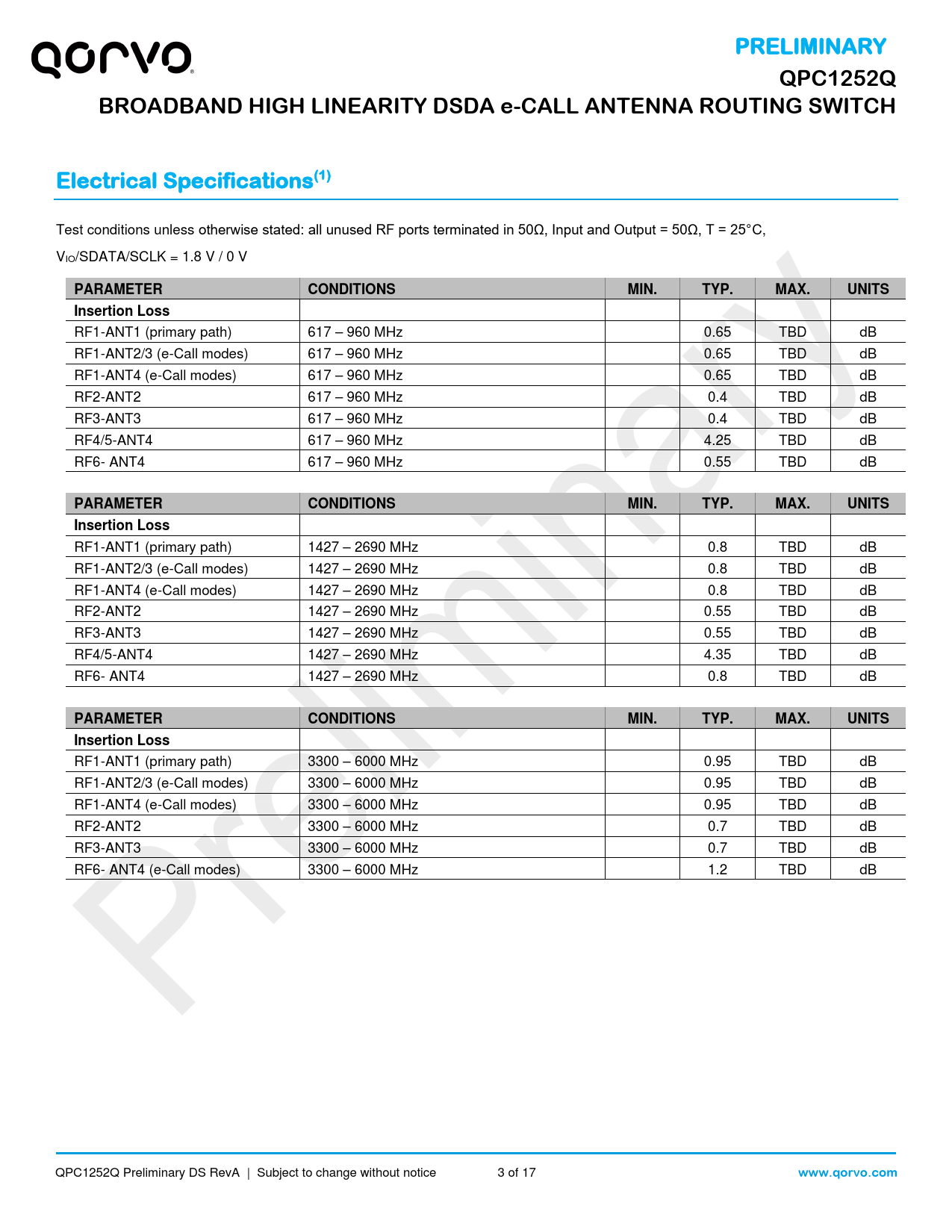

PRELIMINARY. QPC1252Q. BROADBAND HIGH LINEARITY DSDA e-CALL ANTENNA ROUTING SWITCH. Electrical Specifications(1). PARAMETER
PRELIMINARY QPC1252Q BROADBAND HIGH LINEARITY DSDA e-CALL ANTENNA ROUTING SWITCH Electrical Specifications(1) PARAMETER
Test conditions unless otherwise stated: all unused RF ports terminated in 50Ω, Input and Output = 50Ω, T = 25°C, VIO/SDATA/SCLK = 1.8 V / 0 V
PARAMETER CONDITIONS MIN. TYP. MAX. UNITS Insertion Loss
RF1-ANT1 (primary path) 617 – 960 MHz 0.65 TBD dB RF1-ANT2/3 (e-Call modes) 617 – 960 MHz 0.65 TBD dB RF1-ANT4 (e-Call modes) 617 – 960 MHz 0.65 TBD dB RF2-ANT2 617 – 960 MHz 0.4 TBD dB RF3-ANT3 617 – 960 MHz 0.4 TBD dB RF4/5-ANT4 617 – 960 MHz 4.25 TBD dB RF6- ANT4 617 – 960 MHz 0.55 TBD dB
RF1-ANT1 (primary path) 1427 – 2690 MHz 0.8 TBD dB RF1-ANT2/3 (e-Call modes) 1427 – 2690 MHz 0.8 TBD dB RF1-ANT4 (e-Call modes) 1427 – 2690 MHz 0.8 TBD dB RF2-ANT2 1427 – 2690 MHz 0.55 TBD dB RF3-ANT3 1427 – 2690 MHz 0.55 TBD dB RF4/5-ANT4 1427 – 2690 MHz 4.35 TBD dB RF6- ANT4 1427 – 2690 MHz 0.8 TBD dB
RF1-ANT1 (primary path) 3300 – 6000 MHz 0.95 TBD dB RF1-ANT2/3 (e-Call modes) 3300 – 6000 MHz 0.95 TBD dB RF1-ANT4 (e-Call modes) 3300 – 6000 MHz 0.95 TBD dB RF2-ANT2 3300 – 6000 MHz 0.7 TBD dB RF3-ANT3 3300 – 6000 MHz 0.7 TBD dB RF6- ANT4 (e-Call modes) 3300 – 6000 MHz 1.2 TBD dB QPC1252Q Preliminary DS RevA | Subject to change without notice 3 of 17
