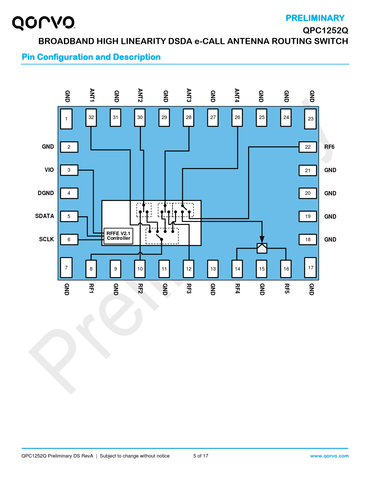

Preliminary Datasheet QPC1252Q (Qorvo) - 5
ManufacturerQorvo
DescriptionBroadband High Linearity DSDA e-Call Antenna Routing Switch
Pages / Page17 / 5 — PRELIMINARY. QPC1252Q. BROADBAND HIGH LINEARITY DSDA e-CALL ANTENNA …
File Format / SizePDF / 976 Kb
PRELIMINARY. QPC1252Q. BROADBAND HIGH LINEARITY DSDA e-CALL ANTENNA ROUTING SWITCH. Pin Configuration and Description. GND. RF6
PRELIMINARY QPC1252Q BROADBAND HIGH LINEARITY DSDA e-CALL ANTENNA ROUTING SWITCH Pin Configuration and Description GND RF6
PRELIMINARY QPC1252Q BROADBAND HIGH LINEARITY DSDA e-CALL ANTENNA ROUTING SWITCH Pin Configuration and Description G A G A G A G A G G G N N N N N T N T N T N T N N N D 1 D 2 D 3 D 4 D D D
1 32 31 30 29 28 27 26 25 24 23
GND
2 22
RF6 VIO
3 21
GND DGND
4 20
GND SDATA
5 19
GND RFFE V2.1 SCLK Controller
6 18
GND
7 8 9 10 11 17 12 13 14 15 16
G RF G RF G RF G RF G RF G N N N N N N D 1 D 2 D 3 D 4 D 5 D
