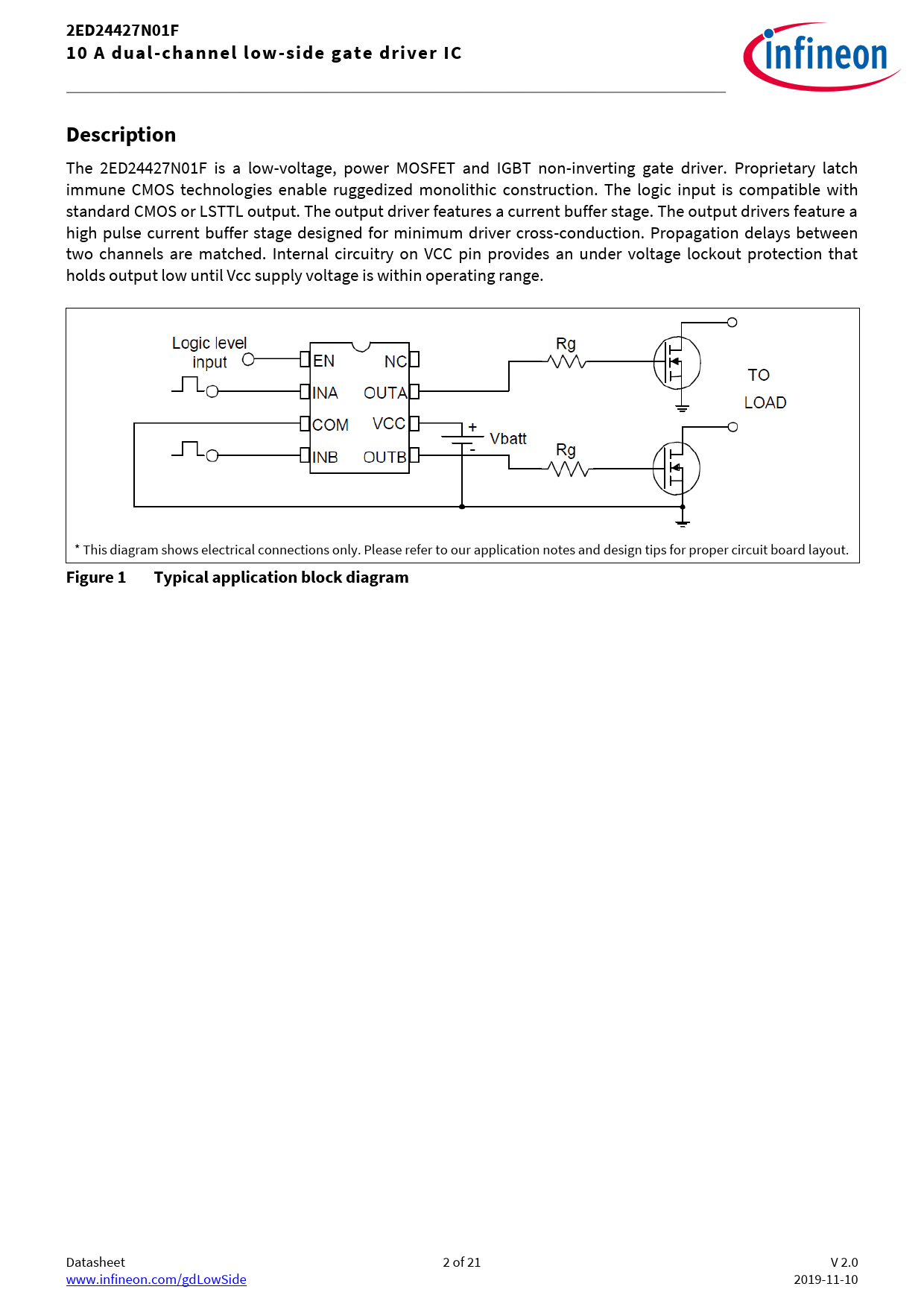

2ED24427N01F. 10 A dual-channel low-side gate driver IC. Description. Figure 1. Typical application block diagram
2ED24427N01F 10 A dual-channel low-side gate driver IC Description Figure 1 Typical application block diagram
The 2ED24427N01F is a low-voltage, power MOSFET and IGBT non-inverting gate driver. Proprietary latch immune CMOS technologies enable ruggedized monolithic construction. The logic input is compatible with standard CMOS or LSTTL output. The output driver features a current buffer stage. The output drivers feature a high pulse current buffer stage designed for minimum driver cross-conduction. Propagation delays between two channels are matched. Internal circuitry on VCC pin provides an under voltage lockout protection that holds output low until Vcc supply voltage is within operating range. * This diagram shows electrical connections only. Please refer to our application notes and design tips for proper circuit board layout.
