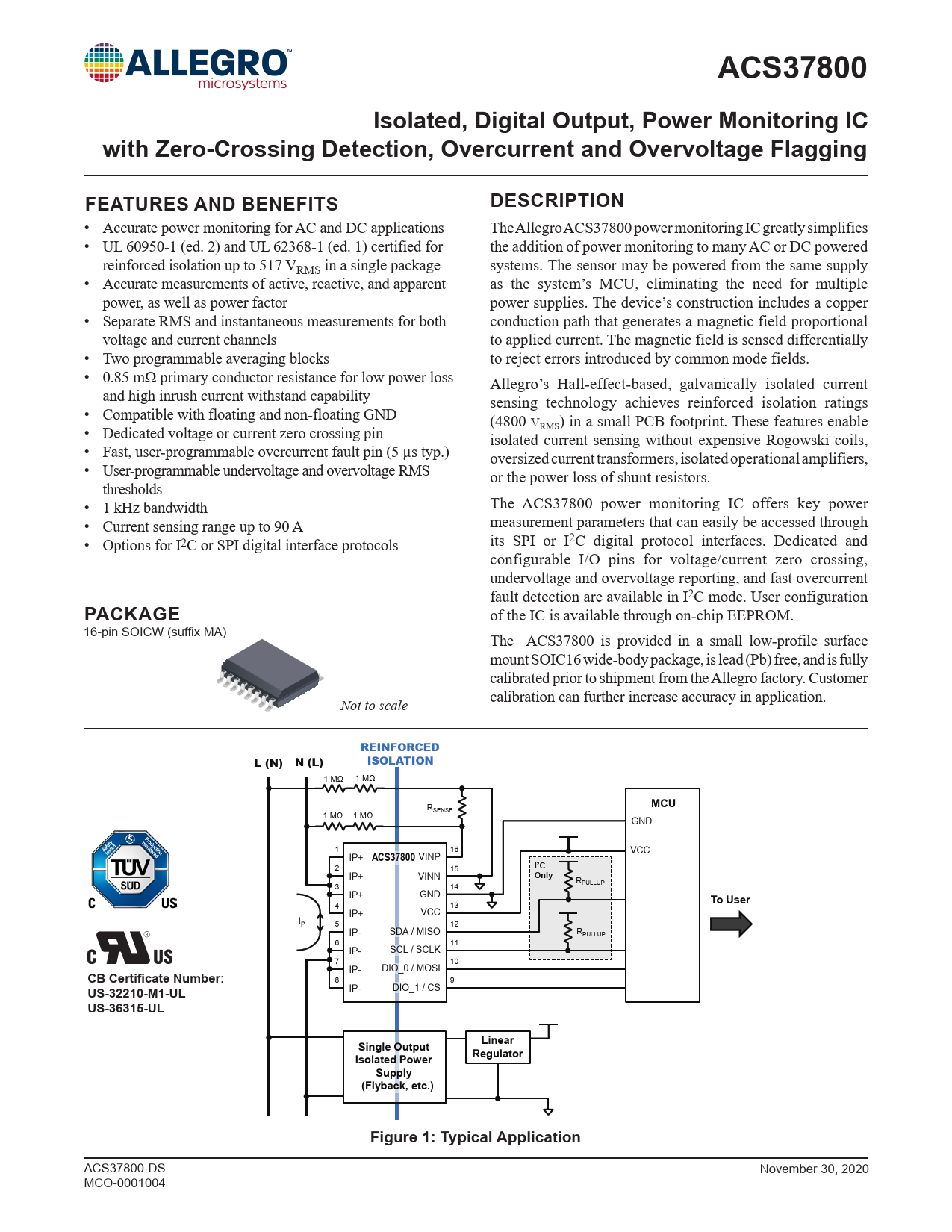

ACS37800 Isolated, Digital Output, Power Monitoring IC with Zero-Crossing Detection, Overcurrent and Overvoltage Flagging FEATURES AND BENEFITS DESCRIPTION
• Accurate power monitoring for AC and DC applications The Allegro ACS37800 power monitoring IC greatly simplifies • UL 60950-1 (ed. 2) and UL 62368-1 (ed. 1) certified for the addition of power monitoring to many AC or DC powered reinforced isolation up to 517 VRMS in a single package systems. The sensor may be powered from the same supply • Accurate measurements of active, reactive, and apparent as the system’s MCU, eliminating the need for multiple power, as well as power factor power supplies. The device’s construction includes a copper • Separate RMS and instantaneous measurements for both conduction path that generates a magnetic field proportional voltage and current channels to applied current. The magnetic field is sensed differentially • Two programmable averaging blocks to reject errors introduced by common mode fields. • 0.85 mΩ primary conductor resistance for low power loss Allegro’s Hall-effect-based, galvanically isolated current and high inrush current withstand capability sensing technology achieves reinforced isolation ratings • Compatible with floating and non-floating GND (4800 VRMS) in a small PCB footprint. These features enable • Dedicated voltage or current zero crossing pin isolated current sensing without expensive Rogowski coils, • Fast, user-programmable overcurrent fault pin (5 µs typ.) oversized current transformers, isolated operational amplifiers, • User-programmable undervoltage and overvoltage RMS or the power loss of shunt resistors. thresholds The ACS37800 power monitoring IC offers key power • 1 kHz bandwidth measurement parameters that can easily be accessed through • Current sensing range up to 90 A its SPI or I2C digital protocol interfaces. Dedicated and • Options for I2C or SPI digital interface protocols configurable I/O pins for voltage/current zero crossing, undervoltage and overvoltage reporting, and fast overcurrent fault detection are available in I2C mode. User configuration

REINFORCED L (N) N (L) ISOLATION
1 MΩ 1 MΩ R
MCU
1 MΩ 1 MΩ SENSE GND 1 16 VCC IP+
ACS37800
VINP 2 15
I2C
IP+ VINN
Only
R 3 14 PULLUP IP+ GND
To User
4 13 IP+ VCC IP 5 12 IP- SDA / MISO RPULLUP 6 11 IP- SCL / SCLK 7 10 IP- DIO_0 / MOSI
CB Certificate Number:
8 9 IP- DIO_1 / CS
US-32210-M1-UL US-36315-UL Linear Single Output Regulator Isolated Power Supply (Flybac , k etc.) Figure 1: Typical Application
