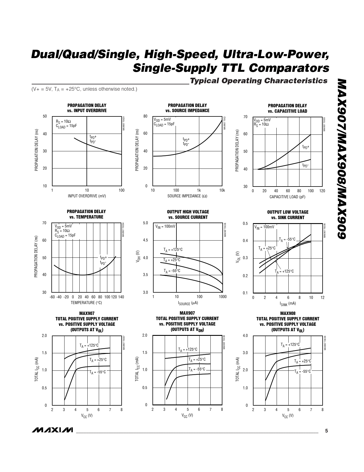

Dual/Quad/Single, High-Speed, Ultra-Low-Power,. Single-Supply TTL Comparators MAX907/MAX908/MAX909
Dual/Quad/Single, High-Speed, Ultra-Low-Power, Single-Supply TTL Comparators MAX907/MAX908/MAX909 Typical Operating Characteristics
(V+ = 5V, TA = +25°C, unless otherwise noted.)
PROPAGATION DELAY PROPAGATION DELAY PROPAGATION DELAY vs. INPUT OVERDRIVE vs. SOURCE IMPEDANCE vs. CAPACITIVE LOAD
50 80 70 V R OD = 5mV V S = 10Ω OD = 5mV C C LOAD = 15pF R LOAD = 15pF S = 10Ω MAX907 TOC01 MAX907 TOC2 MAX907 TOC03 40 60 60 tPD+ t tPD+ PD- tPD- tPD+ 30 40 50 tPD- PROPAGATION DELAY (ns) 20 20 PROPAGATION DELAY (ns) 40 PROPAGATION DELAY (ns) 10 0 30 1 10 100 10 100 1k 10k 0 20 40 60 80 100 120 INPUT OVERDRIVE (mV) SOURCE IMPEDANCE (Ω) CAPACITIVE LOAD (pF)
PROPAGATION DELAY OUTPUT HIGH VOLTAGE OUTPUT LOW VOLTAGE vs. TEMPERATURE vs. SOURCE CURRENT vs. SINK CURRENT
70 5.0 0.5 VOD = 5mV VIN = 100mV VIN = 100mV RS = 10Ω CLOAD = 15pF MAX907 TOC04 MAX907 TOC05 MAX907 TOC06 60 4.5 0.4 TA = -55°C T T A = +125°C A = +25°C (V) (V) 50 tPD+ OH 4.0 0.3 T OL t V A = +25°C V PD- TA = -55°C TA = +125°C 40 PROPAGATION DELAY (ns) 3.5 0.2 30 3.0 0.1 -60 -40 -20 0 20 40 60 80 100 120 140 1 10 100 1000 0 2 4 6 8 10 12 TEMPERATURE (°C) ISOURCE (µA) ISINK (mA)
MAX907 MAX907 MAX908 TOTAL POSITIVE SUPPLY CURRENT TOTAL POSITIVE SUPPLY CURRENT TOTAL POSITIVE SUPPLY CURRENT vs. POSITIVE SUPPLY VOLTAGE vs. POSITIVE SUPPLY VOLTAGE vs. POSITIVE SUPPLY VOLTAGE (OUTPUTS AT V (OUTPUTS AT V OL) OH) (OUTPUTS AT VOL)
2.0 2.0 4.0 T T A = +125°C A = +125°C MAX907 TOC07 T MAX907 TOC08 MAX907 TOC09 A = +125°C 1.5 1.5 3.0 T T A = +25°C A = +25°C TA = +25°C (mA) (mA) (mA) CC CC CC 1.0 1.0 T T A = -55°C 2.0 T A = -55°C A = -55°C TOTAL I TOTAL I TOTAL I 0.5 0.5 1.0 0 0 0 2 3 4 5 6 7 8 2 3 4 5 6 7 8 2 3 4 5 6 7 8 V V CC (V) CC (V) VCC (V)
