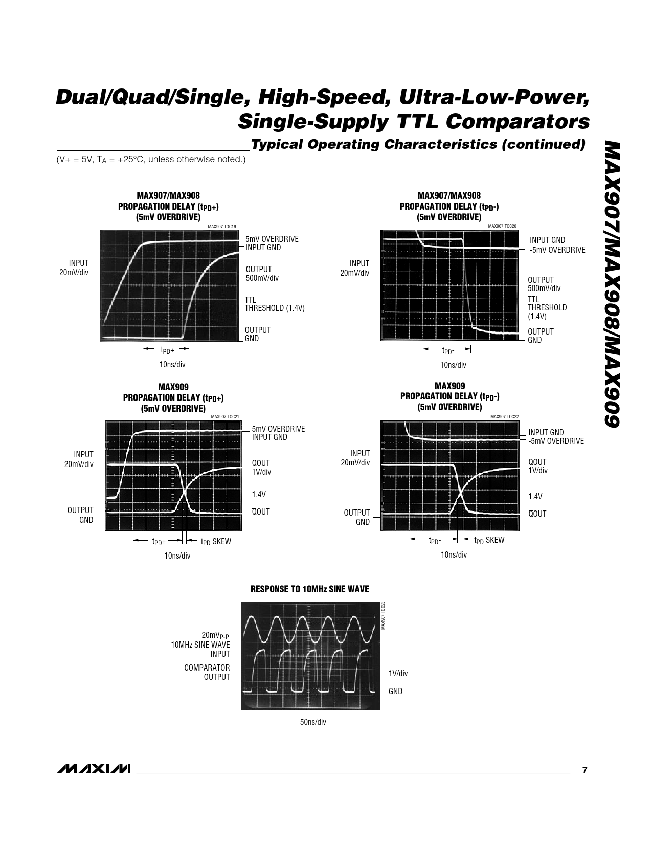

Dual/Quad/Single, High-Speed, Ultra-Low-Power,. Single-Supply TTL Comparators MAX907/MAX908/MAX909
Dual/Quad/Single, High-Speed, Ultra-Low-Power, Single-Supply TTL Comparators MAX907/MAX908/MAX909 Typical Operating Characteristics (continued)
(V+ = 5V, TA = +25°C, unless otherwise noted.)
MAX907/MAX908 MAX907/MAX908 PROPAGATION DELAY (tPD+) PROPAGATION DELAY (tPD-) (5mV OVERDRIVE) (5mV OVERDRIVE)
MAX907 TOC19 MAX907 TOC20 5mV OVERDRIVE INPUT GND INPUT GND -5mV OVERDRIVE INPUT INPUT 20mV/div OUTPUT 20mV/div 500mV/div OUTPUT 500mV/div TTL TTL THRESHOLD (1.4V) THRESHOLD (1.4V) OUTPUT OUTPUT GND GND tPD+ tPD- 10ns/div 10ns/div
MAX909 MAX909 PROPAGATION DELAY (tPD+) PROPAGATION DELAY (tPD-) (5mV OVERDRIVE) (5mV OVERDRIVE)
MAX907 TOC21 MAX907 TOC22 5mV OVERDRIVE INPUT GND INPUT GND -5mV OVERDRIVE INPUT INPUT 20mV/div QOUT 20mV/div QOUT 1V/div 1V/div 1.4V 1.4V OUTPUT QOUT OUTPUT QOUT GND GND tPD+ tPD SKEW tPD- tPD SKEW 10ns/div 10ns/div
RESPONSE TO 10MHz SINE WAVE
MAX907 TOC23 20mVP-P 10MHz SINE WAVE INPUT COMPARATOR 1V/div OUTPUT GND 50ns/div
