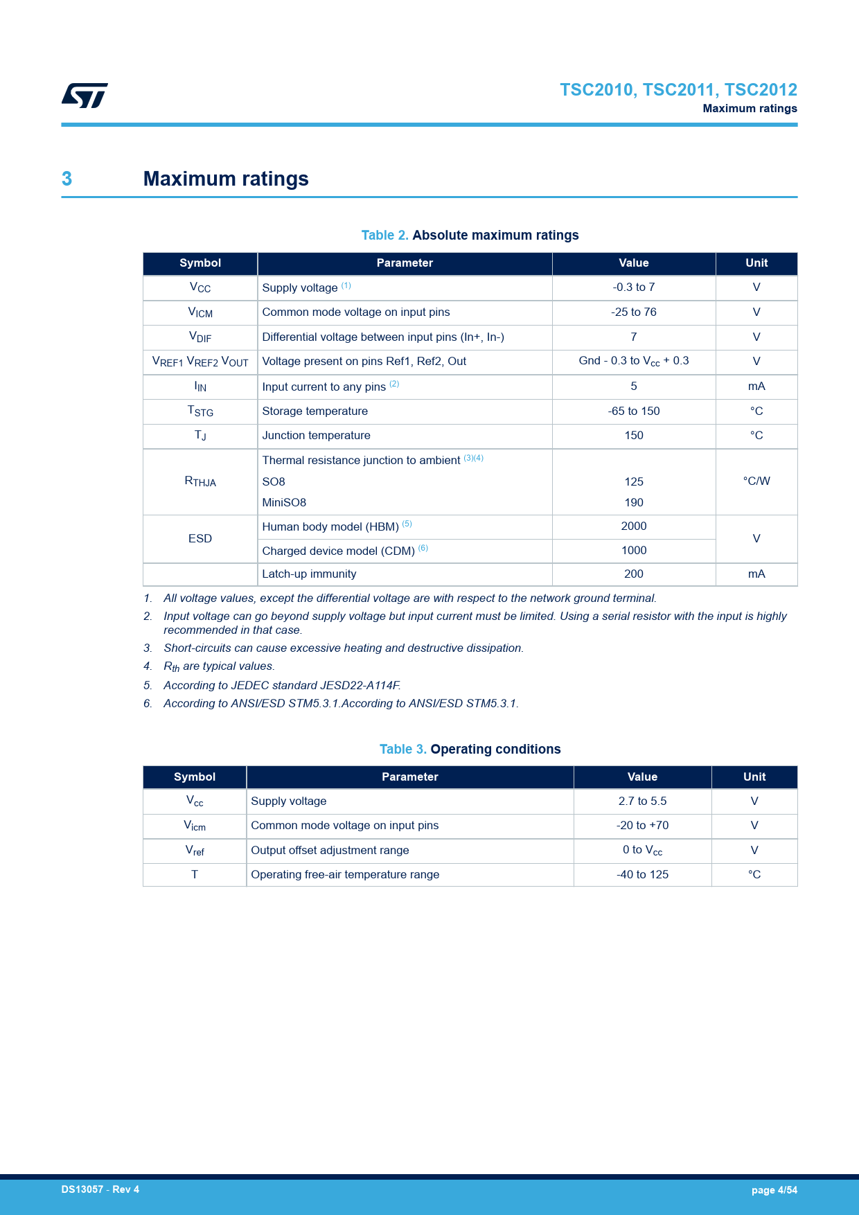

TSC2010, TSC2011, TSC2012 Maximum ratings 3 Maximum ratings Table 2. Absolute maximum ratings Symbol Parameter Value Unit
VCC Supply voltage (1) -0.3 to 7 V VICM Common mode voltage on input pins -25 to 76 V VDIF Differential voltage between input pins (In+, In-) 7 V VREF1 VREF2 VOUT Voltage present on pins Ref1, Ref2, Out Gnd - 0.3 to Vcc + 0.3 V IIN Input current to any pins (2) 5 mA TSTG Storage temperature -65 to 150 °C TJ Junction temperature 150 °C Thermal resistance junction to ambient (3)(4) RTHJA SO8 125 °C/W MiniSO8 190 Human body model (HBM) (5) 2000 ESD V Charged device model (CDM) (6) 1000 Latch-up immunity 200 mA 1. All voltage values, except the differential voltage are with respect to the network ground terminal. 2. Input voltage can go beyond supply voltage but input current must be limited. Using a serial resistor with the input is highly recommended in that case. 3. Short-circuits can cause excessive heating and destructive dissipation. 4. Rth are typical values. 5. According to JEDEC standard JESD22-A114F. 6. According to ANSI/ESD STM5.3.1.According to ANSI/ESD STM5.3.1.
Table 3. Operating conditions Symbol Parameter Value Unit
Vcc Supply voltage 2.7 to 5.5 V Vicm Common mode voltage on input pins -20 to +70 V Vref Output offset adjustment range 0 to Vcc V T Operating free-air temperature range -40 to 125 °C
