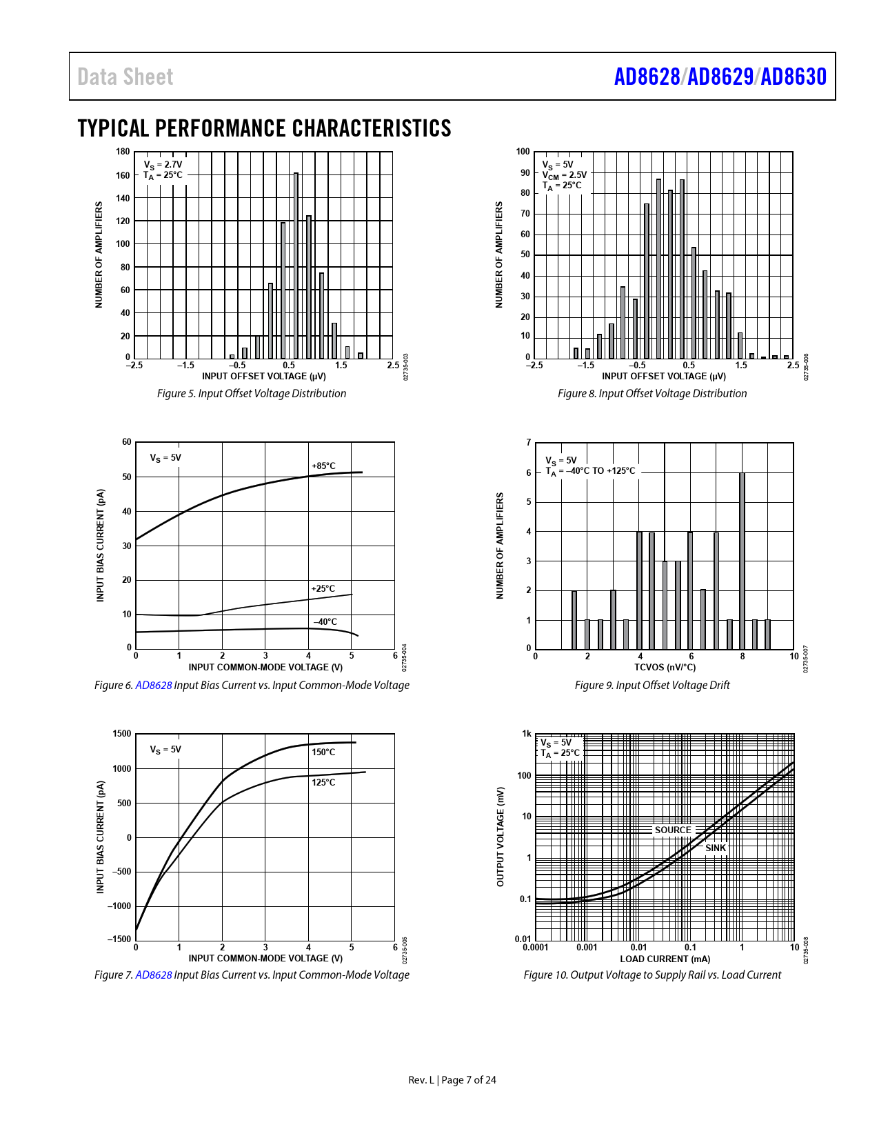

Data Sheet. AD8628. /AD8629/. AD8630. TYPICAL PERFORMANCE CHARACTERISTICS. 180. 100. VS = 2.7V. VS = 5V. 160. A = 25°C. VCM = 2.5V. TA = 25°C
Data Sheet AD8628 /AD8629/ AD8630 TYPICAL PERFORMANCE CHARACTERISTICS 180 100 VS = 2.7V VS = 5V 160 T 90 A = 25°C VCM = 2.5V TA = 25°C 80 140 RS RS IE 70 120 IE IF IF L L P P 60 100 AM AM F F 50 O 80 O R R 40 BE 60 BE 30 NUM NUM 40 20 20 10 0

02 Figure 5. Input Offset Voltage Distribution Figure 8. Input Offset Voltage Distribution

02 Figure 6. AD8628 Input Bias Current vs. Input Common-Mode Voltage Figure 9. Input Offset Voltage Drift

02 027 Figure 7. AD8628 Input Bias Current vs. Input Common-Mode Voltage Figure 10. Output Voltage to Supply Rail vs. Load Current Rev. L | Page 7 of 24 Document Outline FEATURES APPLICATIONS GENERAL DESCRIPTION PIN CONFIGURATIONS TABLE OF CONTENTS REVISION HISTORY SPECIFICATIONS ELECTRICAL CHARACTERISTICS—VS = 5.0 V ELECTRICAL CHARACTERISTICS—VS = 2.7 V ABSOLUTE MAXIMUM RATINGS THERMAL CHARACTERISTICS ESD CAUTION TYPICAL PERFORMANCE CHARACTERISTICS FUNCTIONAL DESCRIPTION 1/f NOISE PEAK-TO-PEAK NOISE NOISE BEHAVIOR WITH FIRST-ORDER, LOW-PASS FILTER TOTAL INTEGRATED INPUT-REFERRED NOISE FOR FIRST-ORDER FILTER INPUT OVERVOLTAGE PROTECTION OUTPUT PHASE REVERSAL OVERLOAD RECOVERY TIME INFRARED SENSORS PRECISION CURRENT SHUNT SENSOR OUTPUT AMPLIFIER FOR HIGH PRECISION DACS OUTLINE DIMENSIONS ORDERING GUIDE AUTOMOTIVE PRODUCTS
