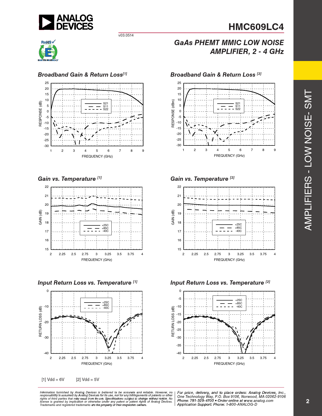

HMC609LC4. GaAs PHEMT MMIC LOW NOISE. AMPLIFIER, 2 - 4 GHz. Broadband Gain & Return Loss[1]
HMC609LC4 GaAs PHEMT MMIC LOW NOISE AMPLIFIER, 2 - 4 GHz Broadband Gain & Return Loss[1]
HMC609LC4
v03.0514
GaAs PHEMT MMIC LOW NOISE AMPLIFIER, 2 - 4 GHz Broadband Gain & Return Loss[1] Broadband Gain & Return Loss [2]
25 25 20 20 15 15 T 10 10 S21 S21 M (dB) 5 S11 5 S11 (dBm) S22 S22 0 0 - S -5 -5 E -10 -10 RESPONSE RESPONSE -15 -15 IS -20 -20 O -25 -25 -30 -30 1 2 3 4 5 6 7 8 9 1 2 3 4 5 6 7 8 9 FREQUENCY (GHz) W N FREQUENCY (GHz) O
Gain vs. Temperature [1] Gain vs. Temperature [2]
S - L 22 22 R 21 21 IE 20 20 LIF 19 19 (dB) (dB) P 18 GAIN 18 +25C GAIN +25C M +85C +85C 17 -40C 17 -40C A 16 16 15 15 2 2.25 2.5 2.75 3 3.25 3.5 3.75 4 2 2.25 2.5 2.75 3 3.25 3.5 3.75 4 FREQUENCY (GHz) FREQUENCY (GHz)
Input Return Loss vs. Temperature [1] Input Return Loss vs. Temperature [2]
0 0 -5 +25C +25C +85C -10 +85C -40C -10 -40C (dB) (dB) -15 LOSS -20 LOSS -20 -25 RETURN RETURN -30 -30 -35 -40 -40 2 2.25 2.5 2.75 3 3.25 3.5 3.75 4 2 2.25 2.5 2.75 3 3.25 3.5 3.75 4 FREQUENCY (GHz) FREQUENCY (GHz) [1] Vdd = 6V [2] Vdd = 5V I F nf o or r p mati r o in cfe ur , d nish e e l d iv b e y r A y a nalo n g d t Devi o p ces i la s c bele o ieve rd d t e o rbs e : H acc iutrtatite e M and ic reli rao bl w e. a H v o e C wever o , nrp o For price, delivery, and to place orders: Analog Devices, Inc., responsibility is assumed by Analog Devices for its use, nor for any infringements of patents or other oration, 2 Elizabeth Drive, Chelmsford, MA 01824 One Technology Way, P.O. Box 9106, Norwood, MA 02062-9106 Phone: 978-250-3343 Fax: 978-250-3373 O rights of third parties that may result from its use. Specifications subject to change without notice. No rd Phoe n r O e: 7 n- 81-li 3 n 2 e a 9-4 t w 70 ww 0 • O . rdh e itt r o it nle i . n co e a m license is granted by implication or otherwise under any patent or patent rights of Analog Devices. t www.analog.com
