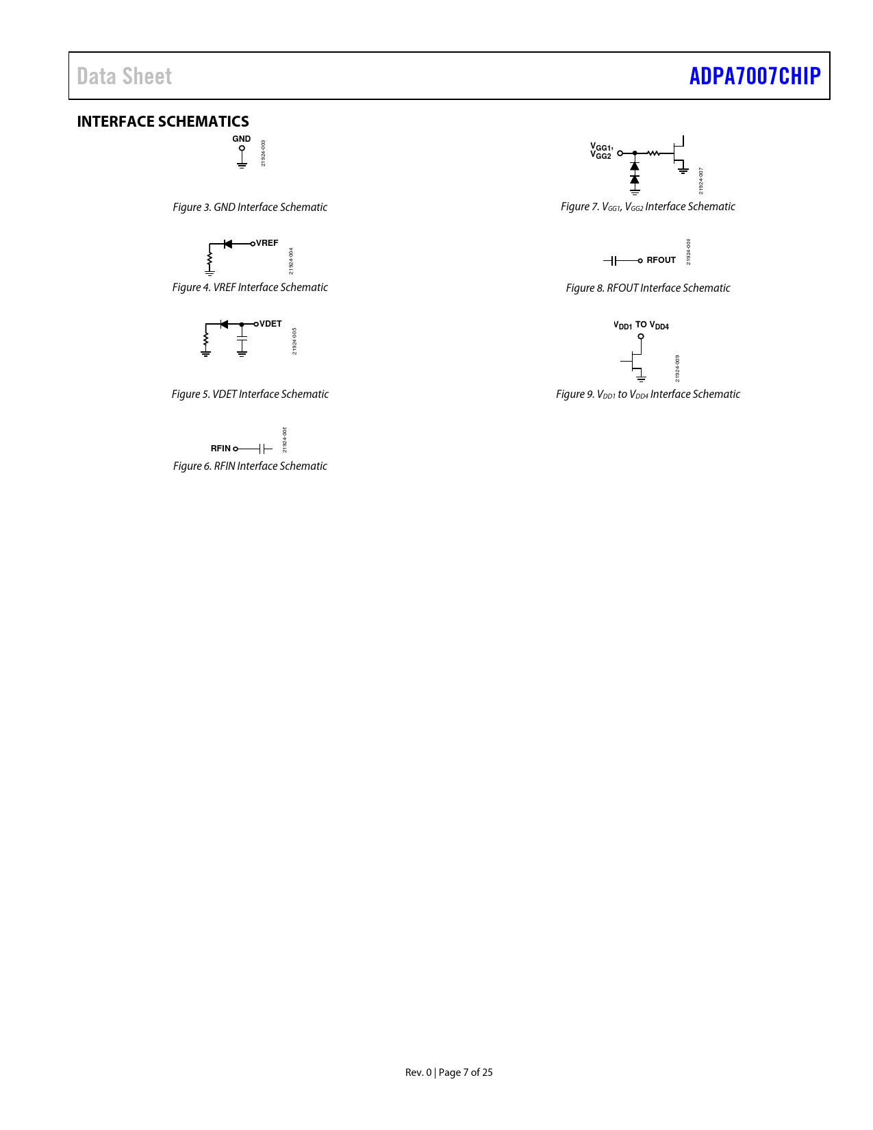

Data Sheet. ADPA7007CHIP. INTERFACE SCHEMATICS. GND. VGG1,. VGG2. VREF. RFOUT. VDET. VDD1 TO VDD4. RFIN
Data Sheet ADPA7007CHIP INTERFACE SCHEMATICS GND
003
VGG1, VGG2
21924- 007 21924- Figure 3. GND Interface Schematic Figure 7. VGG1, VGG2 Interface Schematic
VREF
008 004
RFOUT
21924- 21924- Figure 4. VREF Interface Schematic Figure 8. RFOUT Interface Schematic
VDET VDD1 TO VDD4
005 21924- 009 21924- Figure 5. VDET Interface Schematic Figure 9. VDD1 to VDD4 Interface Schematic 006
RFIN
