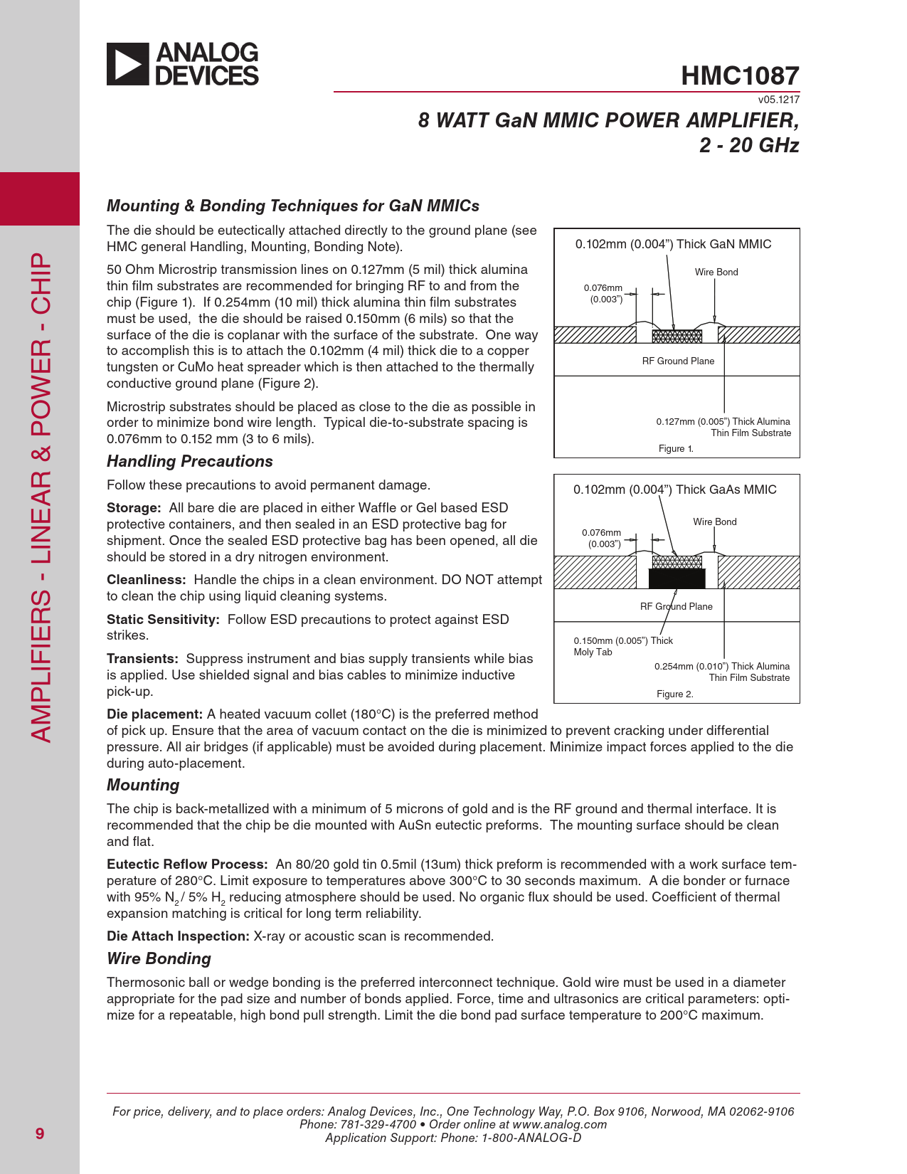

8 WATT GaN MMIC POWER AMPLIFIER, 2 - 20 GHz Mounting & Bonding Techniques for GaN MMICs
The die should be eutectical y attached directly to the ground plane (see HMC general Handling, Mounting, Bonding Note). 0.102mm (0.004”) Thick GaN MMIC IP 50 Ohm Microstrip transmission lines on 0.127mm (5 mil) thick alumina H Wire Bond thin film substrates are recommended for bringing RF to and from the 0.076mm (0.003”) chip (Figure 1). If 0.254mm (10 mil) thick alumina thin film substrates must be used, the die should be raised 0.150mm (6 mils) so that the R - C surface of the die is coplanar with the surface of the substrate. One way E to accomplish this is to attach the 0.102mm (4 mil) thick die to a copper RF Ground Plane tungsten or CuMo heat spreader which is then attached to the thermal y W conductive ground plane (Figure 2). O Microstrip substrates should be placed as close to the die as possible in 0.127mm (0.005”) Thick Alumina order to minimize bond wire length. Typical die-to-substrate spacing is Thin Film Substrate 0.076mm to 0.152 mm (3 to 6 mils). Figure 1.

All bare die are placed in either Waffle or Gel based ESD Wire Bond protective containers, and then sealed in an ESD protective bag for IN 0.076mm shipment. Once the sealed ESD protective bag has been opened, all die (0.003”) should be stored in a dry nitrogen environment.

Suppress instrument and bias supply transients while bias LIF 0.254mm (0.010”) Thick Alumina is applied. Use shielded signal and bias cables to minimize inductive Thin Film Substrate P pick-up. Figure 2. M
