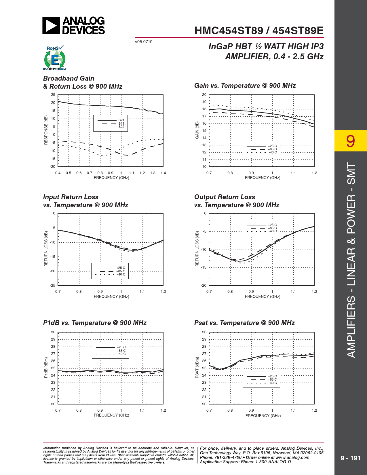

HMC454ST89 / 454ST89E. InGaP HBT ½ WATT HIGH IP3. AMPLIFIER, 0.4 - 2.5 GHz. Broadband Gain & Return Loss @ 900 MHz
HMC454ST89 / 454ST89E InGaP HBT ½ WATT HIGH IP3 AMPLIFIER, 0.4 - 2.5 GHz Broadband Gain & Return Loss @ 900 MHz
v05.0710
InGaP HBT ½ WATT HIGH IP3 AMPLIFIER, 0.4 - 2.5 GHz Broadband Gain & Return Loss @ 900 MHz Gain vs. Temperature @ 900 MHz
25 20 20 19 15 18 17 10 S21 S11 16 5 S22 (dB) 15 0 GAIN 14 -5 RESPONSE (dB) 13 +25 C 9 -10 +85 C 12 -40 C -15 11 -20 10 T 0.4 0.5 0.6 0.7 0.8 0.9 1 1.1 1.2 1.3 1.4 0.7 0.8 0.9 1 1.1 1.2 FREQUENCY (GHz) FREQUENCY (GHz)
Input Return Loss Output Return Loss
R - SM
vs. Temperature @ 900 MHz vs. Temperature @ 900 MHz
E 0 0 W +25 C O -5 +85 C -5 -40 C -10 -10 R & P -15 A RETURN LOSS (dB) RETURN LOSS (dB) +25 C -15 E -20 +85 C -40 C IN -25 -20 0.7 0.8 0.9 1 1.1 1.2 0.7 0.8 0.9 1 1.1 1.2 FREQUENCY (GHz) FREQUENCY (GHz) S - L R IE
P1dB vs. Temperature @ 900 MHz Psat vs. Temperature @ 900 MHz
IF 30 30 L 29 29 P 28 +25 C 28 +85 C M 27 -40 C 27 A 26 26 25 25 24 P1dB (dBm) 24 +25 C PSAT (dBm) +85 C 23 23 -40 C 22 22 21 21 20 20 0.7 0.8 0.9 1 1.1 1.2 0.7 0.8 0.9 1 1.1 1.2 FREQUENCY (GHz) FREQUENCY (GHz) Info F rmoatr pr ion f iurcne, de ished b ly iv A e n r al y o a g D n evd to p ices is bla eli c eve o ed t rde o be ras: H ccuratite tiatne M d reli iacr ble ow . Ho av wev e C er, n o o rpo Fora r t p iro ic n e ,, 2 d 0 eli A ve lrpha R y, and toad, C o place hoel rd m er s s fo : Ard, MA 01 nalog Devic 8 e 2 s 4 , Inc., responsibility is assumed by Analog Devices for its use, nor for any infringements of patents or other One Technology Way, P.O. Box 9106, Norwood, MA 02062-9106 Phone: 978-250-3343 Fax: 978-250-3373 O rights of third parties that may result from its use. Specifications subject to change without notice. No P rde hone r O : 7 n 81- -3li 2n 9 e a -47 t w 0 w 0 • O w rd .ehit r o t nilte in .c e ao t m license is granted by implication or otherwise under any patent or patent rights of Analog Devices. www.analog.com
