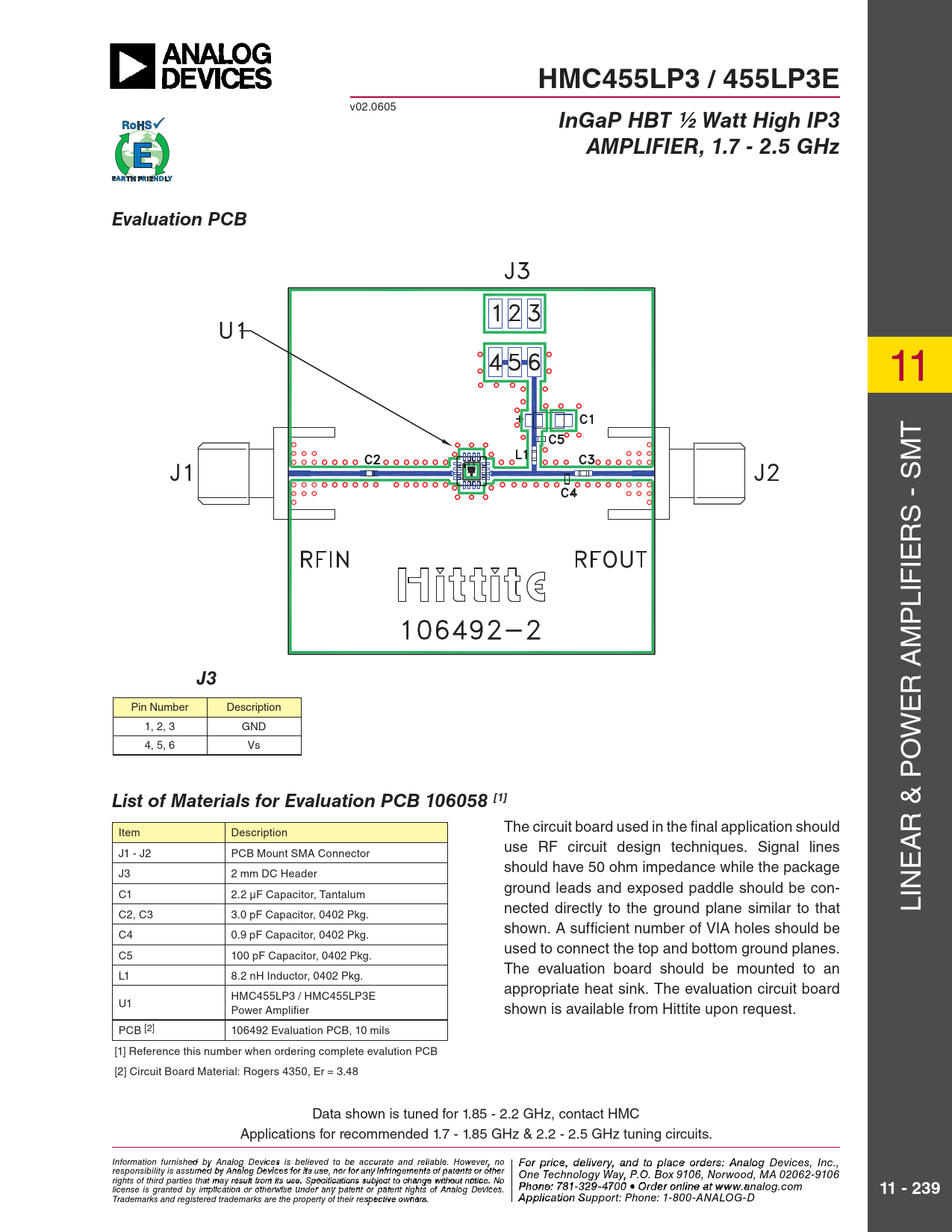

HMC455LP3 / 455LP3E. InGaP HBT ½ Watt High IP3. AMPLIFIER, 1.7 - 2.5 GHz. Evaluation PCB
HMC455LP3 / 455LP3E InGaP HBT ½ Watt High IP3 AMPLIFIER, 1.7 - 2.5 GHz Evaluation PCB
HMC455LP3 / 455LP3E
v02.0605
11 T - SM S R IE IF L P M
J3
R A Pin Number Description E 1, 2, 3 GND W 4, 5, 6 Vs O
List of Materials for Evaluation PCB 106058 [1]
& P The circuit board used in the fi nal application should Item Description R use RF circuit design techniques. Signal lines A J1 - J2 PCB Mount SMA Connector should have 50 ohm impedance while the package E J3 2 mm DC Header ground leads and exposed paddle should be con- C1 2.2 μF Capacitor, Tantalum IN nected directly to the ground plane similar to that L C2, C3 3.0 pF Capacitor, 0402 Pkg. shown. A sufficient number of VIA holes should be C4 0.9 pF Capacitor, 0402 Pkg. used to connect the top and bottom ground planes. C5 100 pF Capacitor, 0402 Pkg. The evaluation board should be mounted to an L1 8.2 nH Inductor, 0402 Pkg. appropriate heat sink. The evaluation circuit board HMC455LP3 / HMC455LP3E U1 Power Amplifi er shown is available from Hittite upon request. PCB [2] 106492 Evaluation PCB, 10 mils [1] Reference this number when ordering complete evalution PCB [2] Circuit Board Material: Rogers 4350, Er = 3.48 Data shown is tuned for 1.85 - 2.2 GHz, contact HMC Applications for recommended 1.7 - 1.85 GHz & 2.2 - 2.5 GHz tuning circuits. Information furnish F e o d r pri by An ce, de alog Devic leis vie s rbyeli, a eve nd to pla d to be accur ce o ate an r d der relia s ble , pl . Ho ease co wever, no For price, delivery, and to place orders: Analog Devices, Inc., responsibility is assumed by Analog Devices for its use, nor for any infringements of patents or other ntact Hittite Microwave Corporation: One Technology Way, P.O. Box 9106, Norwood, MA 02062-9106 20 Alpha Road, Chelmsford, MA 01824 Phone rights of third parties that may result from its use. Specifications subject to change without notice. No license is granted by implication or otherwise under any patent or patent rights of Analog Devices. : 978 Pho - n 25 e: 7 0- 81 33 2 4 9- 3 F 470 ax: 978 0 • Order o - n 25 lin 0 e a-t 3373 www.analog.com
