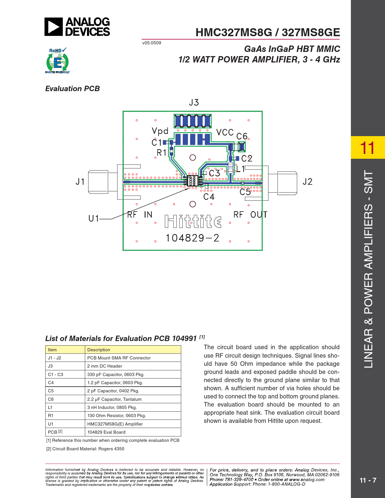

HMC327MS8G / 327MS8GE. GaAs InGaP HBT MMIC. 1/2 WATT POWER AMPLIFIER, 3 - 4 GHz. Evaluation PCB
HMC327MS8G / 327MS8GE GaAs InGaP HBT MMIC 1/2 WATT POWER AMPLIFIER, 3 - 4 GHz Evaluation PCB
v05.0509
11 T - SM S R IE IF L P M R A E W O & P R
List of Materials for Evaluation PCB 104991 [1]
A The circuit board used in the application should Item Description E use RF circuit design techniques. Signal lines sho- J1 - J2 PCB Mount SMA RF Connector IN uld have 50 Ohm impedance while the package J3 2 mm DC Header L ground leads and exposed paddle should be con- C1 - C3 330 pF Capacitor, 0603 Pkg. nected directly to the ground plane similar to that C4 1.2 pF Capacitor, 0603 Pkg. shown. A sufficient number of via holes should be C5 2 pF Capacitor, 0402 Pkg. used to connect the top and bottom ground planes. C6 2.2 μF Capacitor, Tantalum The evaluation board should be mounted to an L1 3 nH Inductor, 0805 Pkg. appropriate heat sink. The evaluation circuit board R1 130 Ohm Resistor, 0603 Pkg. shown is available from Hittite upon request. U1 HMC327MS8G(E) Amplifi er PCB [2] 104829 Eval Board [1] Reference this number when ordering complete evaluation PCB [2] Circuit Board Material: Rogers 4350 Information furnish F e o d r pri by An ce, de alog Devic leis vie s rby eli, a eve nd to pla d to be accur ce o ate an r d der relia s ble , pl . Ho ease co wever, no For price, delivery, and to place orders: Analog Devices, Inc., responsibility is assumed by Analog Devices for its use, nor for any infringements of patents or other ntact Hittite Microwave Corporation: One Technology Way, P.O. Box 9106, Norwood, MA 02062-9106 20 Alpha Road, Chelmsford, MA 01824 Phone rights of third parties that may result from its use. Specifications subject to change without notice. No : 978 Pho - n 25 e: 7 0- 81 3 3 3 2 4 9- 3 F 470 ax: 978 0 • Order o - n 25 lin 0 e a-t 3373 license is granted by implication or otherwise under any patent or patent rights of Analog Devices. www.analog.com
