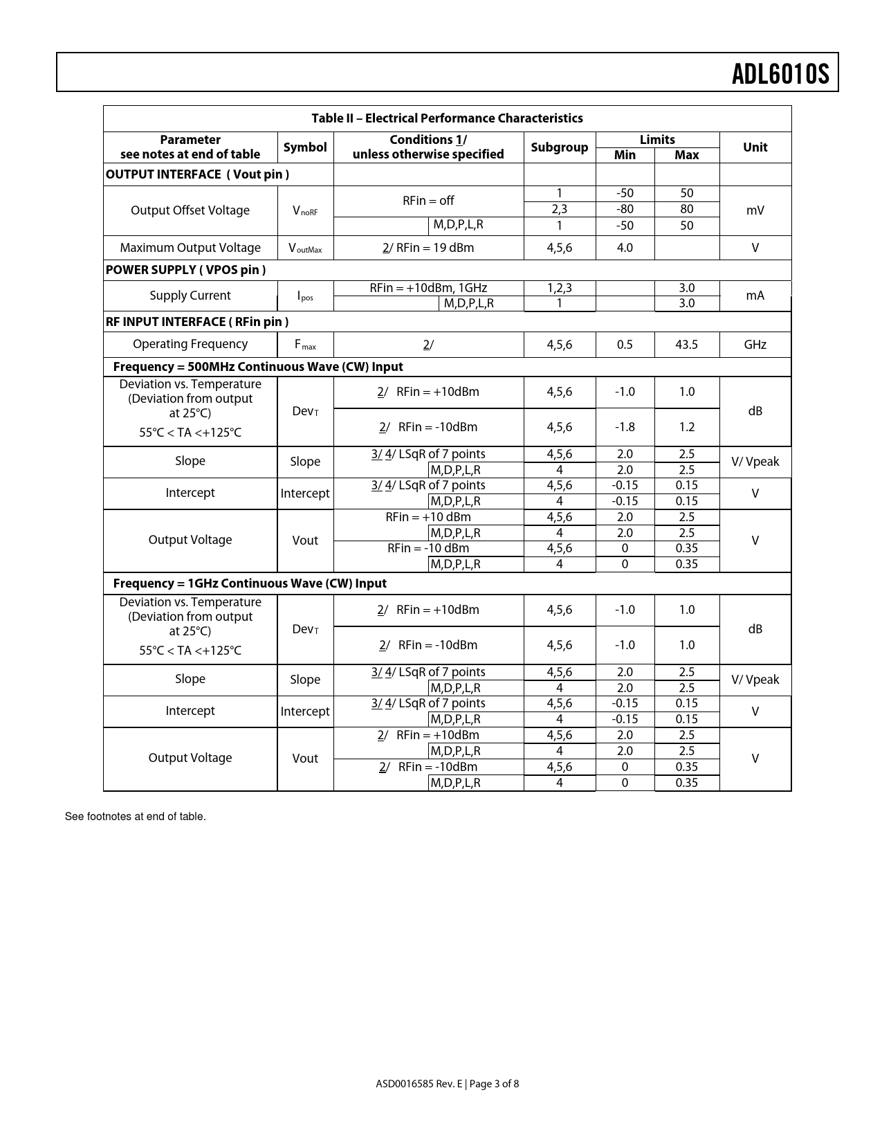

ADL6010S. Table II – Electrical Performance Characteristics. Parameter. Conditions 1/. Limits. see notes at end of table. Symbol
ADL6010S Table II – Electrical Performance Characteristics Parameter Conditions 1/ Limits see notes at end of table Symbol
ADL6010S Table II – Electrical Performance Characteristics Parameter Conditions 1/ Limits see notes at end of table Symbol unless otherwise specified Subgroup Unit Min Max OUTPUT INTERFACE ( Vout pin )
1 -50 50 RFin = off Output Offset Voltage VnoRF 2,3 -80 80 mV M,D,P,L,R 1 -50 50 Maximum Output Voltage VoutMax 2/ RFin = 19 dBm 4,5,6 4.0 V
POWER SUPPLY ( VPOS pin )
RFin = +10dBm, 1GHz 1,2,3 3.0 Supply Current Ipos mA M,D,P,L,R 1 3.0
RF INPUT INTERFACE ( RFin pin )
Operating Frequency Fmax 2/ 4,5,6 0.5 43.5 GHz
Frequency = 500MHz Continuous Wave (CW) Input
Deviation vs. Temperature (Deviation from output 2/ RFin = +10dBm 4,5,6 -1.0 1.0 at 25°C) DevT dB 55°C < TA <+125°C 2/ RFin = -10dBm 4,5,6 -1.8 1.2 Slope 3/ 4/ LSqR of 7 points 4,5,6 2.0 2.5 Slope V/ Vpeak M,D,P,L,R 4 2.0 2.5 Intercept 3/ 4/ LSqR of 7 points 4,5,6 -0.15 0.15 Intercept V M,D,P,L,R 4 -0.15 0.15 RFin = +10 dBm 4,5,6 2.0 2.5 Output Voltage M,D,P,L,R 4 2.0 2.5 Vout V RFin = -10 dBm 4,5,6 0 0.35 M,D,P,L,R 4 0 0.35
Frequency = 1GHz Continuous Wave (CW) Input
