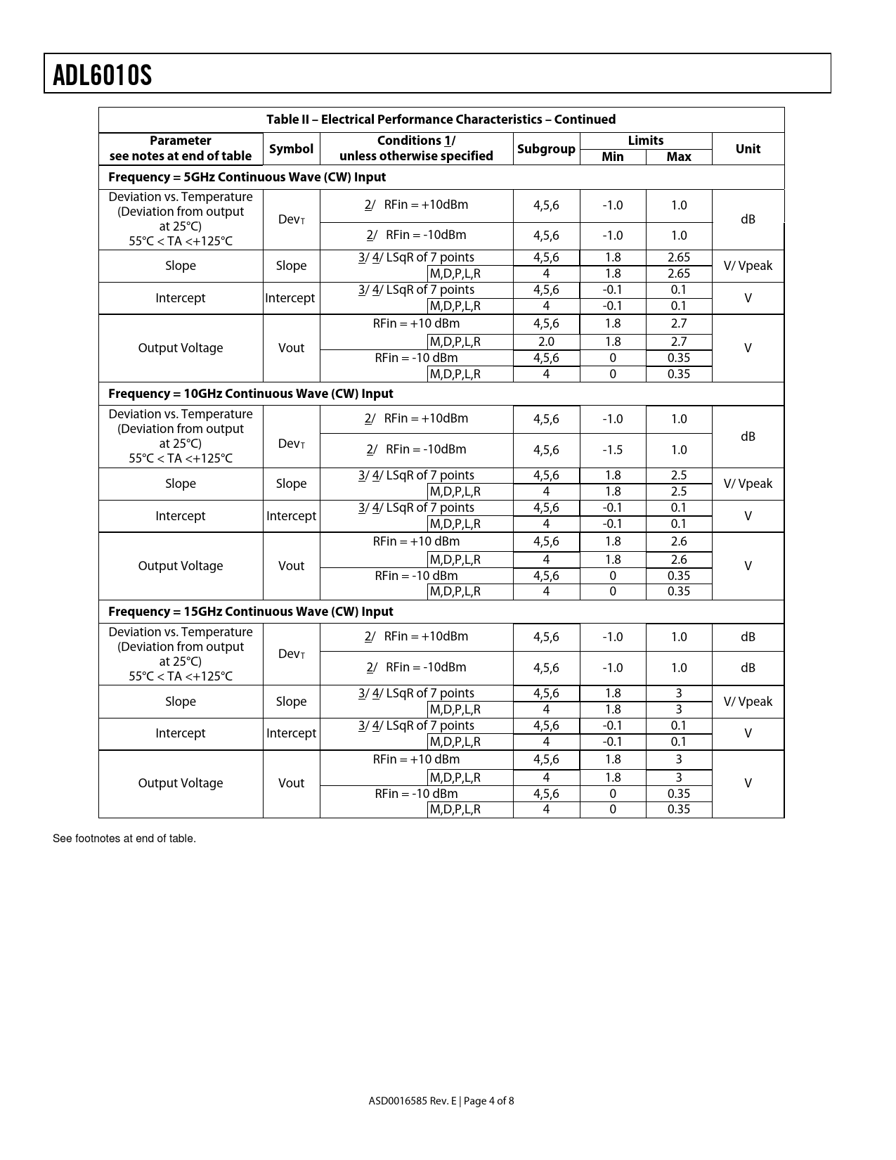

ADL6010S. Table II – Electrical Performance Characteristics – Continued. Parameter. Conditions 1/. Limits
ADL6010S Table II – Electrical Performance Characteristics – Continued Parameter Conditions 1/ Limits see notes at end of table Symbol unless otherwise specified Subgroup Unit Min Max Frequency = 5GHz Continuous Wave (CW) Input
Deviation vs. Temperature (Deviation from output 2/ RFin = +10dBm 4,5,6 -1.0 1.0 Dev dB at 25°C) T 55°C < TA <+125°C 2/ RFin = -10dBm 4,5,6 -1.0 1.0 3/ 4/ LSqR of 7 points 4,5,6 1.8 2.65 Slope Slope V/ Vpeak M,D,P,L,R 4 1.8 2.65 3/ 4/ LSqR of 7 points 4,5,6 -0.1 0.1 Intercept Intercept V M,D,P,L,R 4 -0.1 0.1 RFin = +10 dBm 4,5,6 1.8 2.7 Output Voltage Vout M,D,P,L,R 2.0 1.8 2.7 V RFin = -10 dBm 4,5,6 0 0.35 M,D,P,L,R 4 0 0.35
Frequency = 10GHz Continuous Wave (CW) Input
Deviation vs. Temperature 2/ RFin = +10dBm 4,5,6 -1.0 1.0 (Deviation from output dB at 25°C) DevT 2/ RFin = -10dBm 4,5,6 -1.5 1.0 55°C < TA <+125°C 3/ 4/ LSqR of 7 points 4,5,6 1.8 2.5 Slope Slope V/ Vpeak M,D,P,L,R 4 1.8 2.5 3/ 4/ LSqR of 7 points 4,5,6 -0.1 0.1 Intercept Intercept V M,D,P,L,R 4 -0.1 0.1 RFin = +10 dBm 4,5,6 1.8 2.6 Output Voltage Vout M,D,P,L,R 4 1.8 2.6 V RFin = -10 dBm 4,5,6 0 0.35 M,D,P,L,R 4 0 0.35
Frequency = 15GHz Continuous Wave (CW) Input
Deviation vs. Temperature 2/ RFin = +10dBm 4,5,6 -1.0 1.0 dB (Deviation from output Dev at 25°C) T 2/ RFin = -10dBm 4,5,6 -1.0 1.0 dB 55°C < TA <+125°C 3/ 4/ LSqR of 7 points 4,5,6 1.8 3 Slope Slope V/ Vpeak M,D,P,L,R 4 1.8 3 3/ 4/ LSqR of 7 points 4,5,6 -0.1 0.1 Intercept Intercept V M,D,P,L,R 4 -0.1 0.1 RFin = +10 dBm 4,5,6 1.8 3 Output Voltage Vout M,D,P,L,R 4 1.8 3 V RFin = -10 dBm 4,5,6 0 0.35 M,D,P,L,R 4 0 0.35 See footnotes at end of table. ASD0016585 Rev. E | Page 4 of 8 Document Outline AlCu (a) Qual Sample Size and Qual Acceptance Criteria – 10/0
