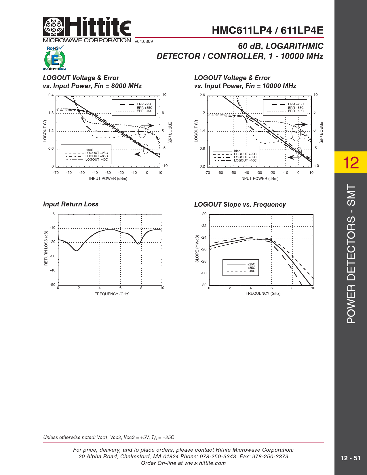

HMC611LP4 / 611LP4E. 60 dB, LOGARITHMIC. DETECTOR / CONTROLLER, 1 - 10000 MHz. LOGOUT Voltage & Error
HMC611LP4 / 611LP4E
v04.0309
60 dB, LOGARITHMIC DETECTOR / CONTROLLER, 1 - 10000 MHz LOGOUT Voltage & Error LOGOUT Voltage & Error vs. Input Power, Fin = 8000 MHz vs. Input Power, Fin = 10000 MHz
2.4 10 2.6 10 ERR +25C ERR +25C ERR +85C ERR +85C ERR -40C ERR -40C 1.8 5 2 5 ERROR (dB) ERROR (dB) 1.2 0 1.4 0 LOGOUT (V) LOGOUT (V) 0.6 -5 -5 Ideal 0.8 Ideal LOGOUT +25C LOGOUT +25C LOGOUT +85C LOGOUT +85C LOGOUT -40C LOGOUT -40C 0 -10 0.2 -10 12 -70 -60 -50 -40 -30 -20 -10 0 10 -70 -60 -50 -40 -30 -20 -10 0 10 INPUT POWER (dBm) INPUT POWER (dBm) T
Input Return Loss LOGOUT Slope vs. Frequency
0 -20 S - SM -22 -10 R -24 O -20 T -26 C -30 E SLOPE (mV/dB) -28 RETURN LOSS (dB) +25C T +85C -40 -40C -30 E -50 -32 0 2 4 6 8 10 0 2 4 6 8 10 R D FREQUENCY (GHz) FREQUENCY (GHz) E W O P Unless otherwise noted: Vcc1, Vcc2, Vcc3 = +5V, TA = +25C For price, delivery, and to place orders, please contact Hittite Microwave Corporation: 20 Alpha Road, Chelmsford, MA 01824 Phone: 978-250-3343 Fax: 978-250-3373
