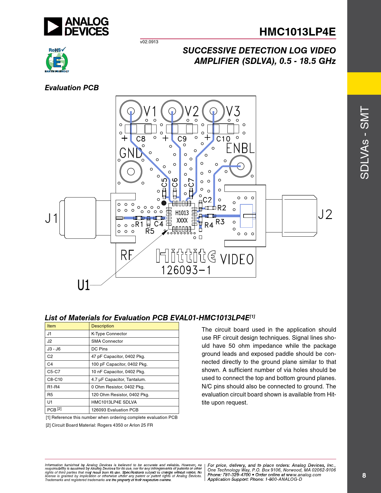

HMC1013LP4E. SUCCESSIVE DETECTION LOG VIDEO. AMPLIFIER (SDLVA), 0.5 - 18.5 GHz. Evaluation PCB
HMC1013LP4E SUCCESSIVE DETECTION LOG VIDEO AMPLIFIER (SDLVA), 0.5 - 18.5 GHz Evaluation PCB
HMC1013LP4E
v02.0913
T M S - As LV SD
List of Materials for Evaluation PCB EVAL01-HMC1013LP4E[1]
Item Description The circuit board used in the application should J1 K-Type Connector use RF circuit design techniques. Signal lines sho- J2 SMA Connector uld have 50 ohm impedance while the package J3 - J6 DC Pins ground leads and exposed paddle should be con- C2 47 pF Capacitor, 0402 Pkg. C4 100 pF Capacitor, 0402 Pkg. nected directly to the ground plane similar to that C5-C7 10 nF Capacitor, 0402 Pkg. shown. A sufficient number of via holes should be C8-C10 4.7 µF Capacitor, Tantalum. used to connect the top and bottom ground planes. R1-R4 0 Ohm Resistor, 0402 Pkg. N/C pins should also be connected to ground. The R5 120 Ohm Resistor, 0402 Pkg. evaluation circuit board shown is available from Hit- U1 HMC1013LP4E SDLVA tite upon request. PCB [2] 126093 Evaluation PCB [1] Reference this number when ordering complete evaluation PCB [2] Circuit Board Material: Rogers 4350 or Arlon 25 FR Inf F or o m r p atio r n ifc ur e n , d ishe e d lbiv y e A r n y a alog n D d t evic o p es is la beclie o eved rd to ebre sa: H ccur iattti e tae M nd re ilicarbloew . H a o ve C wever, o n rp o For price, delivery, and to place orders: Analog Devices, Inc., responsibility is assumed by Analog Devices for its use, nor for any infringements of patents or other oration, 2 Elizabeth Drive, Chelmsford, MA 01824 One Technology Way, P.O. Box 9106, Norwood, MA 02062-9106 Phone: 978-250-3343 Fax: 978-250-3373 O rights of third parties that may result from its use. Specifications subject to change without notice. No P rd hone e r O : 7 n 81- -3li 2n 9 e a -47 t w 0 w 0 • O w rd .h e it r o t niltie n .c e ao t m license is granted by implication or otherwise under any patent or patent rights of Analog Devices. www.analog.com
