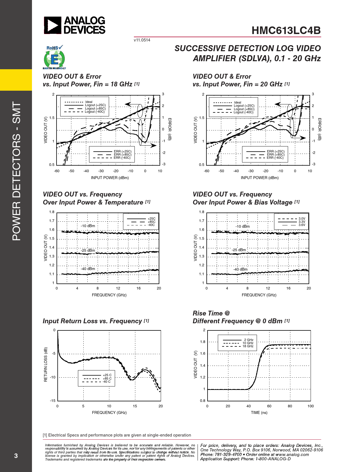

HMC613LC4B. SUCCESSIVE DETECTION LOG VIDEO. AMPLIFIER (SDLVA), 0.1 - 20 GHz. VIDEO OUT & Error
HMC613LC4B SUCCESSIVE DETECTION LOG VIDEO AMPLIFIER (SDLVA), 0.1 - 20 GHz VIDEO OUT & Error
HMC613LC4B
v11.0514
SUCCESSIVE DETECTION LOG VIDEO AMPLIFIER (SDLVA), 0.1 - 20 GHz VIDEO OUT & Error VIDEO OUT & Error vs. Input Power, Fin = 18 GHz [1] vs. Input Power, Fin = 20 GHz [1]
2 3 2 3 T Ideal Ideal Logout (+25C) 2 Logout (+25C) 2 M Logout (+85C) Logout (+85C) Logout (-40C) Logout (-40C) ERROR ERROR S 1.5 1 1.5 1 (V) (V) - OUT 0 OUT 0 (dB) (dB) RS 1 -1 VIDEO 1 -1 VIDEO O ERR (+25C) -2 ERR (+25C) -2 T ERR (+85C) ERR (+85C) ERR (-40C) ERR (-40C) C 0.5 -3 0.5 -3 E -60 -50 -40 -30 -20 -10 0 10 -60 -50 -40 -30 -20 -10 0 10 T INPUT POWER (dBm) INPUT POWER (dBm) E D
VIDEO OUT vs. Frequency VIDEO OUT vs. Frequency
R
Over Input Power & Temperature [1] Over Input Power & Bias Voltage [1]
E 1.8 1.8 W +25C 3.0V 1.7 +85C 1.7 3.3V O -40C -10 dBm 3.6V -10 dBm 1.6 1.6 P (V) 1.5 (V) 1.5 OUT 1.4 OUT 1.4 -25 dBm -25 dBm 1.3 1.3 VIDEO VIDEO 1.2 1.2 -40 dBm -40 dBm 1.1 1.1 1 1 0 4 8 12 16 20 0 4 8 12 16 20 FREQUENCY (GHz) FREQUENCY (GHz)
Rise Time @ Input Return Loss vs. Frequency [1] Different Frequency @ 0 dBm [1]
0 2 1.8 2 GHz 10 GHz 18 GHz (dB) -5 1.6 (V) LOSS OUT 1.4 -10 +25 C VIDEO 1.2 +85 C RETURN -40 C 1 -15 0.8 0 5 10 15 20 0 20 40 60 80 100 FREQUENCY (GHz) TIME (ns) [1] Electrical Specs and performance plots are given at single-ended operation I F nf o or r p mati r o in cfe ur , d nish e e l d iv b e y r A y a nalo n g d t Devi o p ces i la s c bele o ieve rd d t e o rbs e : H acc iutrtatite e M and ic reli rao bl w e. a H v o e C wever o , nrp o For price, delivery, and to place orders: Analog Devices, Inc., responsibility is assumed by Analog Devices for its use, nor for any infringements of patents or other oration, 2 Elizabeth Drive, Chelmsford, MA 01824 One Technology Way, P.O. Box 9106, Norwood, MA 02062-9106 Phone: 978-250-3343 Fax: 978-250-3373 O rights of third parties that may result from its use. Specifications subject to change without notice. No rd Phoe n r O e: 7 n- 81-li 3 n 2 e a 9-4 t w 70 ww 0 • O . rdh e itt r o it nle i . n co e a m
