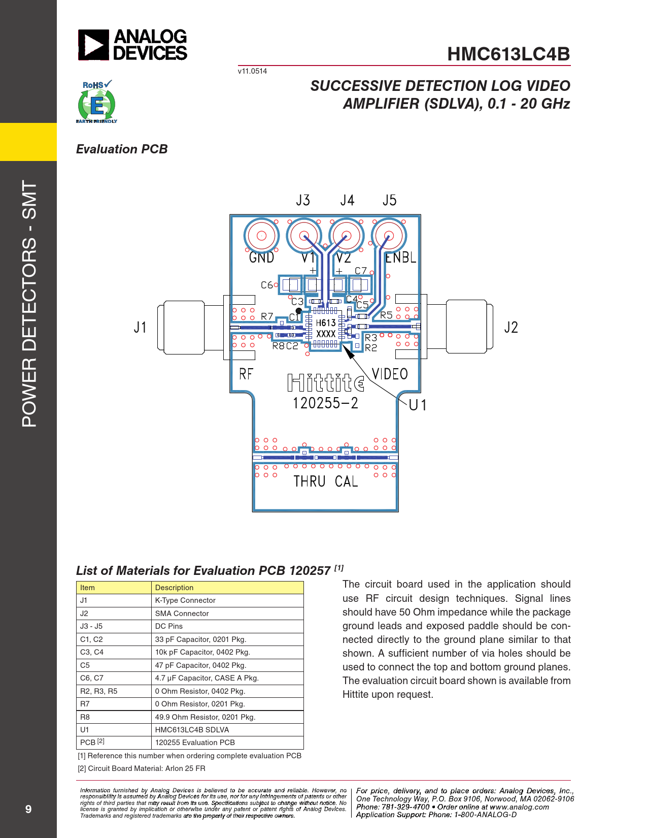

HMC613LC4B. SUCCESSIVE DETECTION LOG VIDEO. AMPLIFIER (SDLVA), 0.1 - 20 GHz. Evaluation PCB
HMC613LC4B SUCCESSIVE DETECTION LOG VIDEO AMPLIFIER (SDLVA), 0.1 - 20 GHz Evaluation PCB
HMC613LC4B
v11.0514
T M S - RS O T C E T E D R E W O P
List of Materials for Evaluation PCB 120257 [1]
Item Description The circuit board used in the application should J1 K-Type Connector use RF circuit design techniques. Signal lines J2 SMA Connector should have 50 Ohm impedance while the package J3 - J5 DC Pins ground leads and exposed paddle should be con- C1, C2 33 pF Capacitor, 0201 Pkg. nected directly to the ground plane similar to that C3, C4 10k pF Capacitor, 0402 Pkg. shown. A sufficient number of via holes should be C5 47 pF Capacitor, 0402 Pkg. used to connect the top and bottom ground planes. C6, C7 4.7 µF Capacitor, CASE A Pkg. The evaluation circuit board shown is available from R2, R3, R5 0 Ohm Resistor, 0402 Pkg. Hittite upon request. R7 0 Ohm Resistor, 0201 Pkg. R8 49.9 Ohm Resistor, 0201 Pkg. U1 HMC613LC4B SDLVA PCB [2] 120255 Evaluation PCB [1] Reference this number when ordering complete evaluation PCB [2] Circuit Board Material: Arlon 25 FR I F nf o or r p mati r o in cfe ur , d nish e e l d iv b e y r A y a nalo n g d t Devi o p ces i la s c bele o ieve rd d t e o rbs e : H acc iutrtatite e M and ic reli rao bl w e. a H v o e C wever o , nrp o For price, delivery, and to place orders: Analog Devices, Inc., responsibility is assumed by Analog Devices for its use, nor for any infringements of patents or other oration, 2 Elizabeth Drive, Chelmsford, MA 01824 One Technology Way, P.O. Box 9106, Norwood, MA 02062-9106 Phone: 978-250-3343 Fax: 978-250-3373 O rights of third parties that may result from its use. Specifications subject to change without notice. No rd Phoe n r O e: 7 n- 81-li 3 n 2 e a 9-4 t w 70 ww 0 • O . rdh e itt r o it nle i . n co e a m
