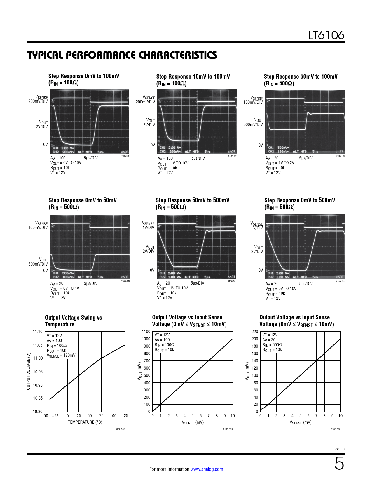

TYPICAL PERFORMANCE CHARACTERISTICS. Step Response 0mV to 100mV. Step Response 10mV to 100mV. Step Response 50mV to 100mV
LT6106
TYPICAL PERFORMANCE CHARACTERISTICS Step Response 0mV to 100mV Step Response 10mV to 100mV Step Response 50mV to 100mV (RIN = 100Ω) (RIN = 100Ω) (RIN = 500Ω)
VSENSE VSENSE VSENSE 200mV/DIV 200mV/DIV 100mV/DIV V V V OUT OUT OUT 2V/DIV 2V/DIV 500mV/DIV 0V 0V 0V A 6106 G12 6106 G13 6106 G15 V = 100 5μs/DIV AV = 100 5µs/DIV AV = 20 5µs/DIV VOUT = 0V TO 10V VOUT = 1V TO 10V VOUT = 1V TO 2V ROUT = 10k ROUT = 10k ROUT = 10k V+ = 12V V+ = 12V V+ = 12V
Step Response 0mV to 50mV Step Response 50mV to 500mV Step Response 0mV to 500mV (RIN = 500Ω) (RIN = 500Ω) (RIN = 500Ω)
VSENSE VSENSE VSENSE 100mV/DIV 1V/DIV 1V/DIV VOUT VOUT 2V/DIV 2V/DIV VOUT 500mV/DIV 0V 0V 0V A 6106 G16 6106 G17 6106 G18 V = 20 5µs/DIV AV = 20 5µs/DIV AV = 20 5µs/DIV VOUT = 0V TO 1V VOUT = 1V TO 10V VOUT = 0V TO 10V ROUT = 10k ROUT = 10k ROUT = 10k V+ = 12V V+ = 12V V+ = 12V
Output Voltage Swing vs Output Voltage vs Input Sense Output Voltage vs Input Sense Temperature Voltage (0mV ≤ VSENSE ≤ 10mV) Voltage (0mV ≤ VSENSE ≤ 10mV)
11.10 1100 220 V+ = 12V V+ = 12V V+ = 12V A 1000 200 V = 100 AV = 100 AV = 20 11.05 RIN = 100Ω 900 RIN = 100Ω 180 RIN = 500Ω ROUT = 10k ROUT = 10k ROUT = 10k V 800 160 11.00 SENSE = 120mV 700 140 TAGE (V) 10.95 (mV) 600 (mV) 120 500 100 V OUT V OUT 400 80 10.90 OUTPUT VOL 300 60 10.85 200 40 100 20 10.80 0 0 –50 –25 0 25 50 75 100 125 0 1 2 3 4 5 6 7 8 9 10 0 1 2 3 4 5 6 7 8 9 10 TEMPERATURE (°C) VSENSE (mV) VSENSE (mV) 6106 G07 6106 G19 6106 G20 Rev. C For more information www.analog.com 5 Document Outline Features Applications Typical Application Description Absolute Maximum Ratings Order Information Electrical Characteristics Pin Configuration Typical Performance Characteristics Pin Functions Block Diagram Applications Information Package Description Revision History Typical Application Related Parts
