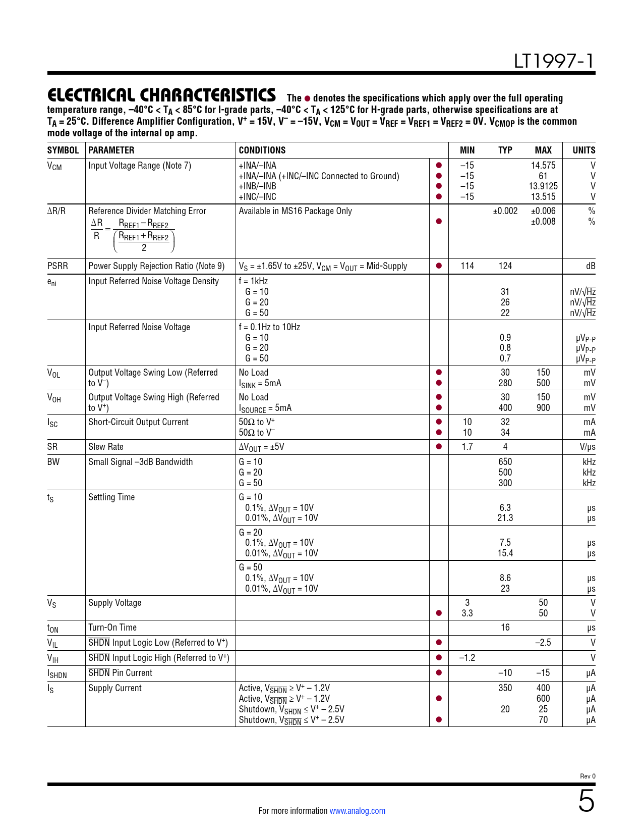

DescriptionPrecision, High Voltage, Gain Selectable Difference/Current Sense Amplifier
Pages / Page30 / 5 — ELECTRICAL CHARACTERISTICS. The. denotes the specifications which apply …
LT1997-1
l
denotes the specifications which apply over the full operating temperature range, –40°C < TA < 85°C for I-grade parts, –40°C < TA < 125°C for H-grade parts, otherwise specifications are at TA = 25°C. Difference Amplifier Configuration, V+ = 15V, V– = –15V, VCM = VOUT = VREF = VREF1 = VREF2 = 0V. VCMOP is the common mode voltage of the internal op amp. SYMBOL PARAMETER CONDITIONS MIN TYP MAX UNITS
VCM Input Voltage Range (Note 7) +INA/–INA l –15 14.575 V +INA/–INA (+INC/–INC Connected to Ground) l –15 61 V +INB/–INB l –15 13.9125 V +INC/–INC l –15 13.515 V ∆R/R Reference Divider Matching Error Available in MS16 Package Only ±0.002 ±0.006 % ∆R R l ±0.008 % = REF1 – RREF2 R ⎛ RREF1+RREF2 ⎞ ⎝⎜ 2 ⎠⎟ PSRR Power Supply Rejection Ratio (Note 9) VS = ±1.65V to ±25V, VCM = VOUT = Mid-Supply l 114 124 dB eni Input Referred Noise Voltage Density f = 1kHz G = 10 31 nV/√Hz G = 20 26 nV/√Hz G = 50 22 nV/√Hz Input Referred Noise Voltage f = 0.1Hz to 10Hz G = 10 0.9 µVP-P G = 20 0.8 µVP-P G = 50 0.7 µVP-P VOL Output Voltage Swing Low (Referred No Load l 30 150 mV to V–) ISINK = 5mA l 280 500 mV VOH Output Voltage Swing High (Referred No Load l 30 150 mV to V+) ISOURCE = 5mA l 400 900 mV ISC Short-Circuit Output Current 50Ω to V+ l 10 32 mA 50Ω to V– l 10 34 mA SR Slew Rate ∆VOUT = ±5V l 1.7 4 V/µs BW Small Signal –3dB Bandwidth G = 10 650 kHz G = 20 500 kHz G = 50 300 kHz tS Settling Time G = 10 0.1%, ∆VOUT = 10V 6.3 µs 0.01%, ∆VOUT = 10V 21.3 µs G = 20 0.1%, ∆VOUT = 10V 7.5 µs 0.01%, ∆VOUT = 10V 15.4 µs G = 50 0.1%, ∆VOUT = 10V 8.6 µs 0.01%, ∆VOUT = 10V 23 µs VS Supply Voltage 3 50 V l 3.3 50 V tON Turn-On Time 16 µs VIL SHDN Input Logic Low (Referred to V+) l –2.5 V VIH SHDN Input Logic High (Referred to V+) l –1.2 V ISHDN SHDN Pin Current l –10 –15 µA IS Supply Current Active, VSHDN ≥ V+ – 1.2V 350 400 µA Active, VSHDN ≥ V+ – 1.2V l 600 µA Shutdown, VSHDN ≤ V+ – 2.5V 20 25 µA Shutdown, VSHDN ≤ V+ – 2.5V l 70 µA Rev 0 For more information www.analog.com 5 Document Outline Features Applications Typical Application Description Absolute Maximum Ratings Pin Configuration Order Information Electrical Characteristics Typical Performance Characteristics Block Diagram Applications Information Package Description Typical Application Related Parts Features Applications Typical Application Description Absolute Maximum Ratings Pin Configuration Order Information Electrical Characteristics Typical Performance Characteristics Pin Functions Block Diagram Applications Information Package Description Typical Application Related Parts
