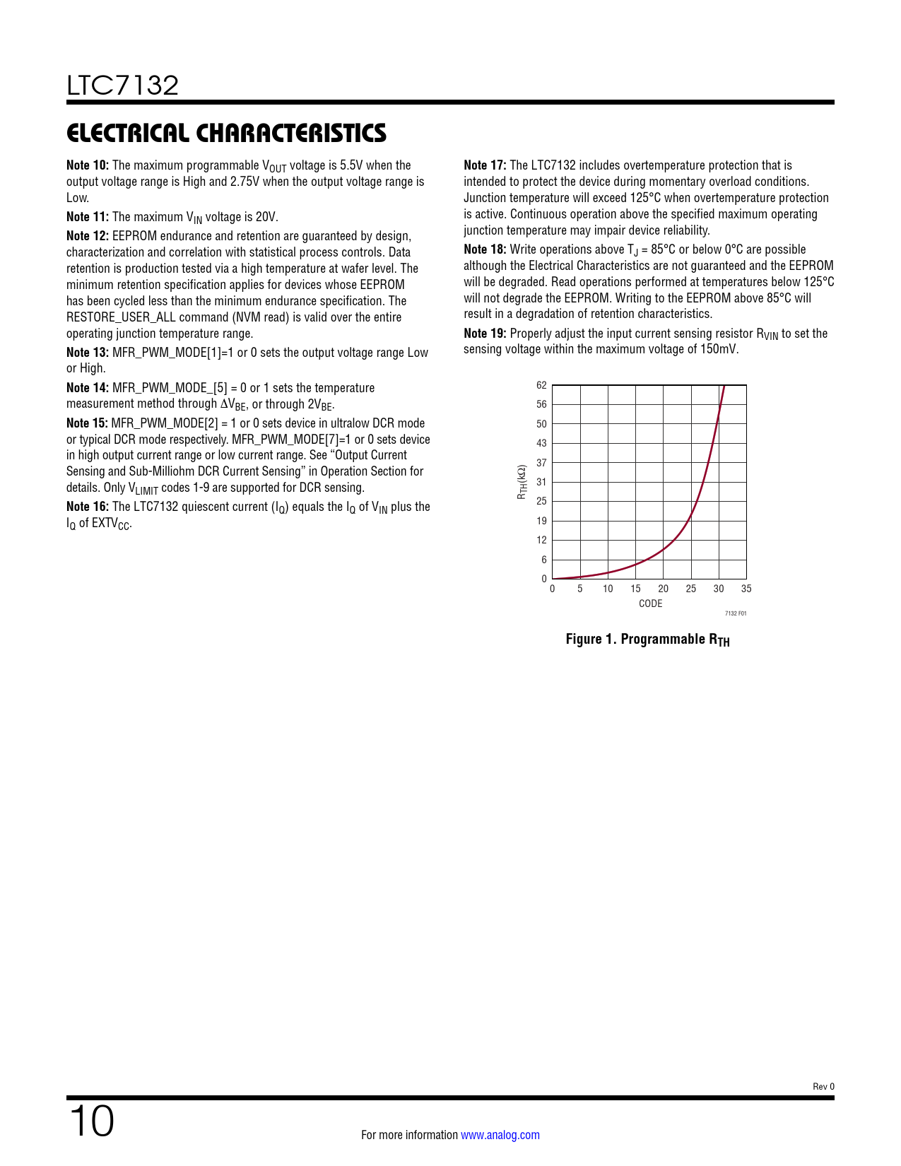

ELECTRICAL CHARACTERISTICS Note 10:
The maximum programmable VOUT voltage is 5.5V when the
Note 17:
The LTC7132 includes overtemperature protection that is output voltage range is High and 2.75V when the output voltage range is intended to protect the device during momentary overload conditions. Low. Junction temperature will exceed 125°C when overtemperature protection
Note 11:
The maximum V is active. Continuous operation above the specified maximum operating IN voltage is 20V.
Note 12:
EEPROM endurance and retention are guaranteed by design, junction temperature may impair device reliability. characterization and correlation with statistical process controls. Data
Note 18:
Write operations above TJ = 85°C or below 0°C are possible retention is production tested via a high temperature at wafer level. The although the Electrical Characteristics are not guaranteed and the EEPROM minimum retention specification applies for devices whose EEPROM will be degraded. Read operations performed at temperatures below 125°C has been cycled less than the minimum endurance specification. The will not degrade the EEPROM. Writing to the EEPROM above 85°C will RESTORE_USER_ALL command (NVM read) is valid over the entire result in a degradation of retention characteristics. operating junction temperature range.
Note 19:
Properly adjust the input current sensing resistor RVIN to set the
Note 13:
MFR_PWM_MODE[1]=1 or 0 sets the output voltage range Low sensing voltage within the maximum voltage of 150mV. or High.
Note 14:
MFR_PWM_MODE_[5] = 0 or 1 sets the temperature 62 measurement method through ∆VBE, or through 2VBE. 56
Note 15:
MFR_PWM_MODE[2] = 1 or 0 sets device in ultralow DCR mode 50 or typical DCR mode respectively. MFR_PWM_MODE[7]=1 or 0 sets device 43 in high output current range or low current range. See “Output Current 37 Sensing and Sub-Milliohm DCR Current Sensing” in Operation Section for details. Only V (kΩ) 31 LIMIT codes 1-9 are supported for DCR sensing. R TH
Note 16:
The LTC7132 quiescent current (I 25 Q) equals the IQ of VIN plus the IQ of EXTVCC. 19 12 6 0 0 5 10 15 20 25 30 35 CODE 7132 F01
Figure 1. Programmable RTH
