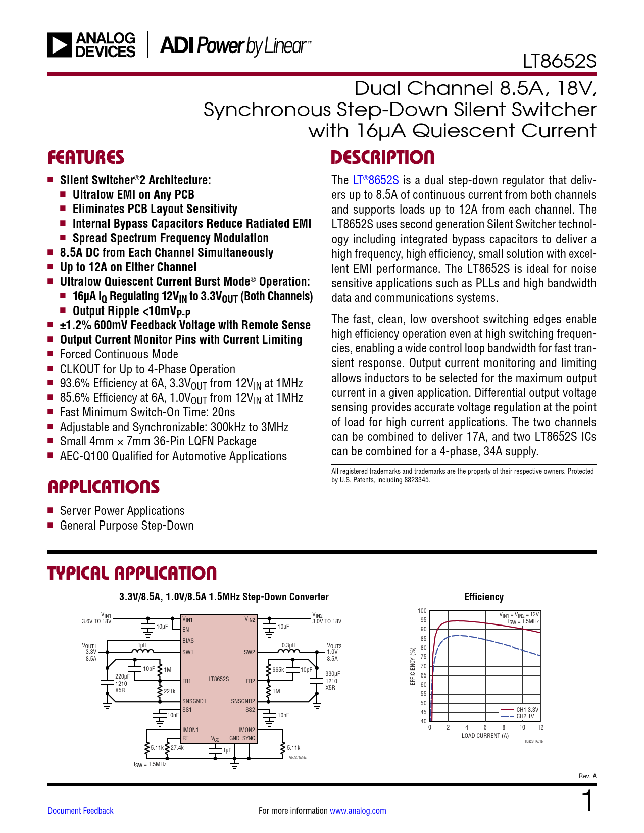

DescriptionDual Channel 8.5A, 18V, Synchronous Step-Down Silent Switcher with 16µA Quiescent Current

FEATURES DESCRIPTION
n
Silent Switcher
2 Architecture:
The LT®8652S is a dual step-down regulator that deliv- n
Ultralow EMI on Any PCB
ers up to 8.5A of continuous current from both channels n
Eliminates PCB Layout Sensitivity
and supports loads up to 12A from each channel. The n
Internal Bypass Capacitors Reduce Radiated EMI
LT8652S uses second generation Silent Switcher technol- n
Spread Spectrum Frequency Modulation
ogy including integrated bypass capacitors to deliver a n
8.5A DC from Each Channel Simultaneously
high frequency, high efficiency, small solution with excel- n
Up to 12A on Either Channel
lent EMI performance. The LT8652S is ideal for noise n
Ultralow Quiescent Current Burst Mode
Operation:
sensitive applications such as PLLs and high bandwidth n
16µA IQ Regulating 12VIN to 3.3VOUT (Both Channels)
data and communications systems. n
Output Ripple <10mVP-P
The fast, clean, low overshoot switching edges enable n
±1.2% 600mV Feedback Voltage with Remote Sense
n high efficiency operation even at high switching frequen-
Output Current Monitor Pins with Current Limiting
n cies, enabling a wide control loop bandwidth for fast tran- Forced Continuous Mode n sient response. Output current monitoring and limiting CLKOUT for Up to 4-Phase Operation n allows inductors to be selected for the maximum output 93.6% Efficiency at 6A, 3.3VOUT from 12VIN at 1MHz n current in a given application. Differential output voltage 85.6% Efficiency at 6A, 1.0VOUT from 12VIN at 1MHz n sensing provides accurate voltage regulation at the point Fast Minimum Switch-On Time: 20ns n of load for high current applications. The two channels Adjustable and Synchronizable: 300kHz to 3MHz n can be combined to deliver 17A, and two LT8652S ICs Small 4mm × 7mm 36-Pin LQFN Package n can be combined for a 4-phase, 34A supply. AEC-Q100 Qualified for Automotive Applications All registered trademarks and trademarks are the property of their respective owners. Protected by U.S. Patents, including 8823345.
APPLICATIONS
n Server Power Applications n General Purpose Step-Down
TYPICAL APPLICATION 3.3V/8.5A, 1.0V/8.5A 1.5MHz Step-Down Converter Efficiency
