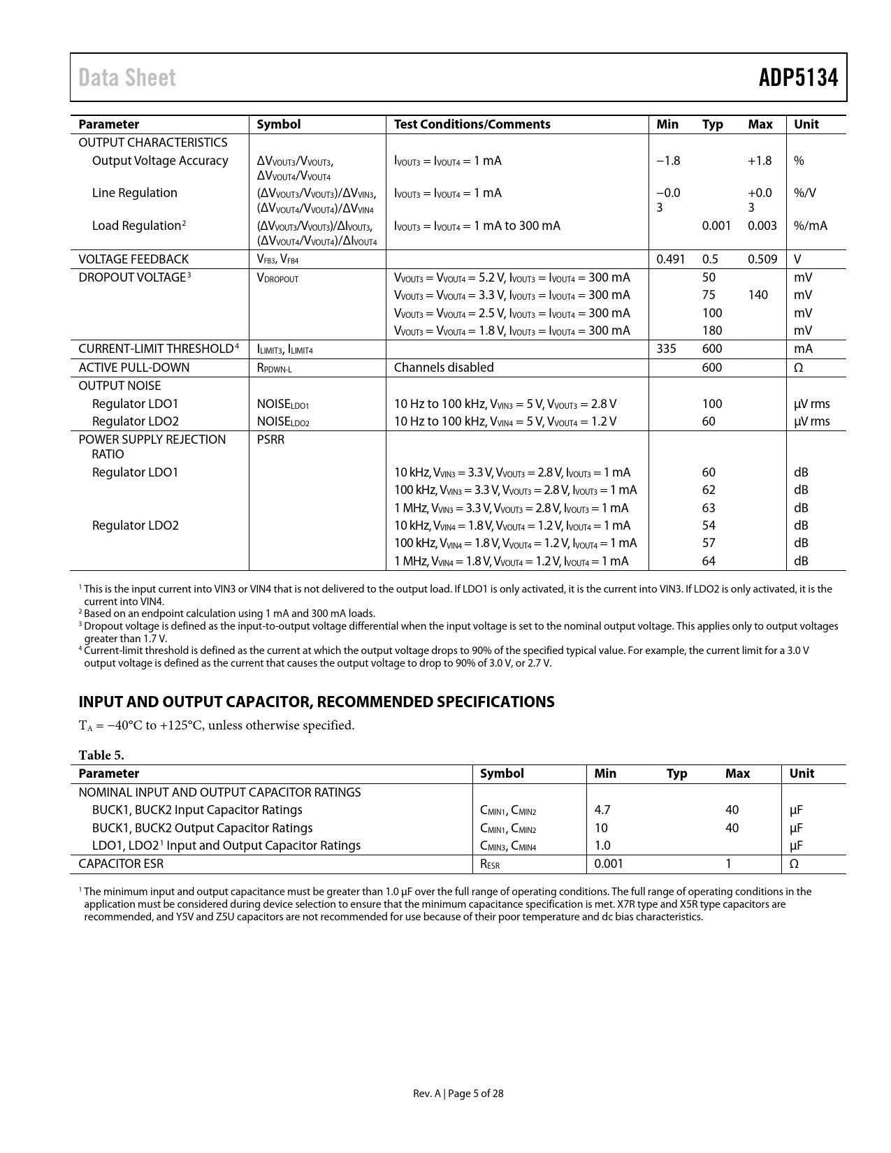

OUTPUT CHARACTERISTICS Output Voltage Accuracy ΔVVOUT3/VVOUT3, IVOUT3 = IVOUT4 = 1 mA −1.8 +1.8 % ΔVVOUT4/VVOUT4 Line Regulation (ΔVVOUT3/VVOUT3)/ΔVVIN3, IVOUT3 = IVOUT4 = 1 mA −0.0 +0.0 %/V (ΔVVOUT4/VVOUT4)/ΔVVIN4 3 3 Load Regulation2 (ΔVVOUT3/VVOUT3)/ΔIVOUT3, IVOUT3 = IVOUT4 = 1 mA to 300 mA 0.001 0.003 %/mA (ΔVVOUT4/VVOUT4)/ΔIVOUT4 VOLTAGE FEEDBACK VFB3, VFB4 0.491 0.5 0.509 V DROPOUT VOLTAGE3 VDROPOUT VVOUT3 = VVOUT4 = 5.2 V, IVOUT3 = IVOUT4 = 300 mA 50 mV VVOUT3 = VVOUT4 = 3.3 V, IVOUT3 = IVOUT4 = 300 mA 75 140 mV VVOUT3 = VVOUT4 = 2.5 V, IVOUT3 = IVOUT4 = 300 mA 100 mV VVOUT3 = VVOUT4 = 1.8 V, IVOUT3 = IVOUT4 = 300 mA 180 mV CURRENT-LIMIT THRESHOLD4 ILIMIT3, ILIMIT4 335 600 mA ACTIVE PULL-DOWN RPDWN-L Channels disabled 600 Ω OUTPUT NOISE Regulator LDO1 NOISELDO1 10 Hz to 100 kHz, VVIN3 = 5 V, VVOUT3 = 2.8 V 100 µV rms Regulator LDO2 NOISELDO2 10 Hz to 100 kHz, VVIN4 = 5 V, VVOUT4 = 1.2 V 60 µV rms POWER SUPPLY REJECTION PSRR RATIO Regulator LDO1 10 kHz, VVIN3 = 3.3 V, VVOUT3 = 2.8 V, IVOUT3 = 1 mA 60 dB 100 kHz, VVIN3 = 3.3 V, VVOUT3 = 2.8 V, IVOUT3 = 1 mA 62 dB 1 MHz, VVIN3 = 3.3 V, VVOUT3 = 2.8 V, IVOUT3 = 1 mA 63 dB Regulator LDO2 10 kHz, VVIN4 = 1.8 V, VVOUT4 = 1.2 V, IVOUT4 = 1 mA 54 dB 100 kHz, VVIN4 = 1.8 V, VVOUT4 = 1.2 V, IVOUT4 = 1 mA 57 dB 1 MHz, VVIN4 = 1.8 V, VVOUT4 = 1.2 V, IVOUT4 = 1 mA 64 dB 1 This is the input current into VIN3 or VIN4 that is not delivered to the output load. If LDO1 is only activated, it is the current into VIN3. If LDO2 is only activated, it is the current into VIN4. 2 Based on an endpoint calculation using 1 mA and 300 mA loads. 3 Dropout voltage is defined as the input-to-output voltage differential when the input voltage is set to the nominal output voltage. This applies only to output voltages greater than 1.7 V. 4 Current-limit threshold is defined as the current at which the output voltage drops to 90% of the specified typical value. For example, the current limit for a 3.0 V output voltage is defined as the current that causes the output voltage to drop to 90% of 3.0 V, or 2.7 V.

Table 5. Parameter Symbol Min Typ Max Unit
NOMINAL INPUT AND OUTPUT CAPACITOR RATINGS BUCK1, BUCK2 Input Capacitor Ratings CMIN1, CMIN2 4.7 40 µF BUCK1, BUCK2 Output Capacitor Ratings CMIN1, CMIN2 10 40 µF LDO1, LDO21 Input and Output Capacitor Ratings CMIN3, CMIN4 1.0 µF CAPACITOR ESR RESR 0.001 1 Ω 1 The minimum input and output capacitance must be greater than 1.0 µF over the full range of operating conditions. The full range of operating conditions in the application must be considered during device selection to ensure that the minimum capacitance specification is met. X7R type and X5R type capacitors are recommended, and Y5V and Z5U capacitors are not recommended for use because of their poor temperature and dc bias characteristics. Rev. A | Page 5 of 28 Document Outline FEATURES APPLICATIONS TYPICAL APPLICATION CIRCUIT GENERAL DESCRIPTION REVISION HISTORY SPECIFICATIONS GENERAL SPECIFICATIONS BUCK1 AND BUCK2 SPECIFICATIONS LDO1 AND LDO2 SPECIFICATIONS INPUT AND OUTPUT CAPACITOR, RECOMMENDED SPECIFICATIONS ABSOLUTE MAXIMUM RATINGS THERMAL RESISTANCE ESD CAUTION PIN CONFIGURATION AND FUNCTION DESCRIPTIONS TYPICAL PERFORMANCE CHARACTERISTICS THEORY OF OPERATION POWER MANAGEMENT UNIT Power-Good Output Thermal Protection Undervoltage Lockout Precision Enable and Shutdown Control BUCK1 AND BUCK2 Control Scheme PWM Mode Power Save Mode (PSM) PSM Current Threshold Oscillator and Phasing of Inductor Switching Short-Circuit Protection Buck Regulator Soft Start Current Limit 100% Duty Operation Active Pull-Down Resistors LDO1 AND LDO2 LDO Regulator Soft Start APPLICATIONS INFORMATION BUCK REGULATOR EXTERNAL COMPONENT SELECTION Feedback Resistors Inductor Output Capacitor Input Capacitor LDO REGULATOR EXTERNAL COMPONENT SELECTION Feedback Resistors Output Capacitor Input Bypass Capacitor Input and Output Capacitor Properties POWER DISSIPATION AND THERMAL CONSIDERATIONS BUCK REGULATOR POWER DISSIPATION LDO Regulator Power Dissipation JUNCTION TEMPERATURE PCB LAYOUT GUIDELINES TYPICAL APPLICATION SCHEMATICS BILL OF MATERIALS OUTLINE DIMENSIONS ORDERING GUIDE
