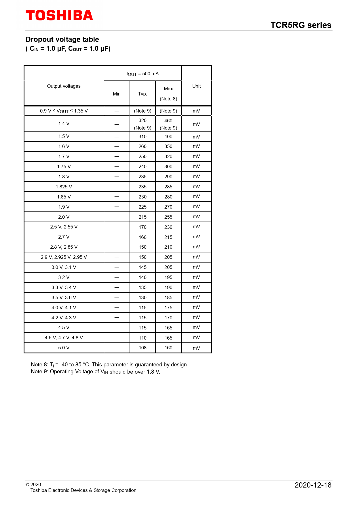

TCR5RG series. Dropout voltage table. ( CIN = 1.0 μF, COUT = 1.0 μF)
TCR5RG series Dropout voltage table ( CIN = 1.0 μF, COUT = 1.0 μF)
IOUT = 500 mA Output voltages Unit Min Typ. Max (Note 8) 0.9 V ≤ VOUT ≤ 1.35 V ― (Note 9) (Note 9) mV 1.4 V 320 460 ― mV (Note 9) (Note 9) 1.5 V ― 310 400 mV 1.6 V ― 260 350 mV 1.7 V ― 250 320 mV 1.75 V ― 240 300 mV 1.8 V ― 235 290 mV 1.825 V ― 235 285 mV 1.85 V ― 230 280 mV 1.9 V ― 225 270 mV 2.0 V ― 215 255 mV 2.5 V, 2.55 V ― 170 230 mV 2.7 V ― 160 215 mV 2.8 V, 2.85 V ― 150 210 mV 2.9 V, 2.925 V, 2.95 V ― 150 205 mV 3.0 V, 3.1 V ― 145 205 mV 3.2 V ― 140 195 mV 3.3 V, 3.4 V ― 135 190 mV 3.5 V, 3.6 V ― 130 185 mV 4.0 V, 4.1 V ― 115 175 mV 4.2 V, 4.3 V ― 115 170 mV 4.5 V 115 165 mV 4.6 V, 4.7 V, 4.8 V 110 165 mV 5.0 V ― 108 160 mV Note 8: Tj = -40 to 85 °C. This parameter is guaranteed by design Note 9: Operating Voltage of VIN should be over 1.8 V. © 2020 2020-12-18 Toshiba Electronic Devices & Storage Corporation
