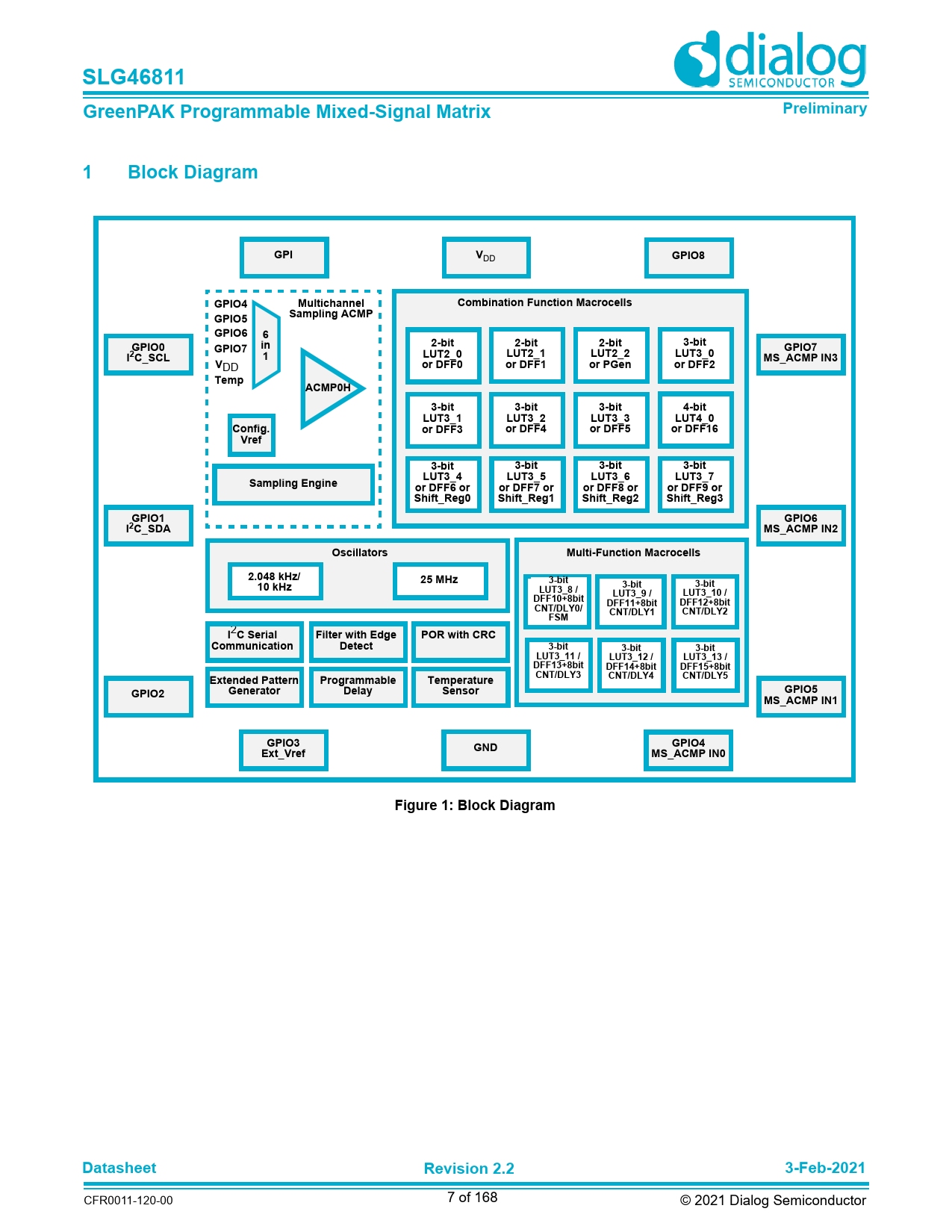

SLG46811. GreenPAK Programmable Mixed-Signal Matrix. Preliminary. Block Diagram. GPI. GPIO8. GPIO4. Multichannel
SLG46811 GreenPAK Programmable Mixed-Signal Matrix Preliminary 1 Block Diagram GPI V
DD
GPIO8 GPIO4 Multichannel Combination Function Macrocells Sampling ACMP GPIO5 GPIO6 6 GPIO0 2-bit 2-bit 2-bit 3-bit in GPIO7 GPIO7 I2C_SCL LUT2_0 LUT2_1 LUT2_2 LUT3_0 1 MS_ACMP IN3 V or DFF0 or DFF1 or PGen or DFF2
DD
Temp ACMP0H 3-bit 3-bit 3-bit 4-bit LUT3_1 LUT3_2 LUT3_3 LUT4_0 Config. or DFF3 or DFF4 or DFF5 or DFF16 Vref 3-bit 3-bit 3-bit 3-bit LUT3_4 LUT3_5 LUT3_6 LUT3_7 Sampling Engine or DFF6 or or DFF7 or or DFF8 or or DFF9 or Shift_Reg0 Shift_Reg1 Shift_Reg2 Shift_Reg3 GPIO1 GPIO6 I2C_SDA MS_ACMP IN2 Oscillators Multi-Function Macrocells 2.048 kHz/ 25 MHz 3-bit 3-bit 3-bit 10 kHz LUT3_8 / LUT3_9 / LUT3_10 / DFF10+8bit DFF11+8bit DFF12+8bit CNT/DLY0/ CNT/DLY1 CNT/DLY2 FSM
2
I C Serial Filter with Edge POR with CRC Communication Detect 3-bit 3-bit 3-bit LUT3_11 / LUT3_12 / LUT3_13 / DFF13+8bit DFF14+8bit DFF15+8bit CNT/DLY3 CNT/DLY4 CNT/DLY5 Extended Pattern Programmable Temperature GPIO2 Generator Delay Sensor GPIO5 MS_ACMP IN1 GPIO3 GND GPIO4 Ext_Vref MS_ACMP IN0 Figure 1: Block Diagram Datasheet Revision 2.2 3-Feb-2021
