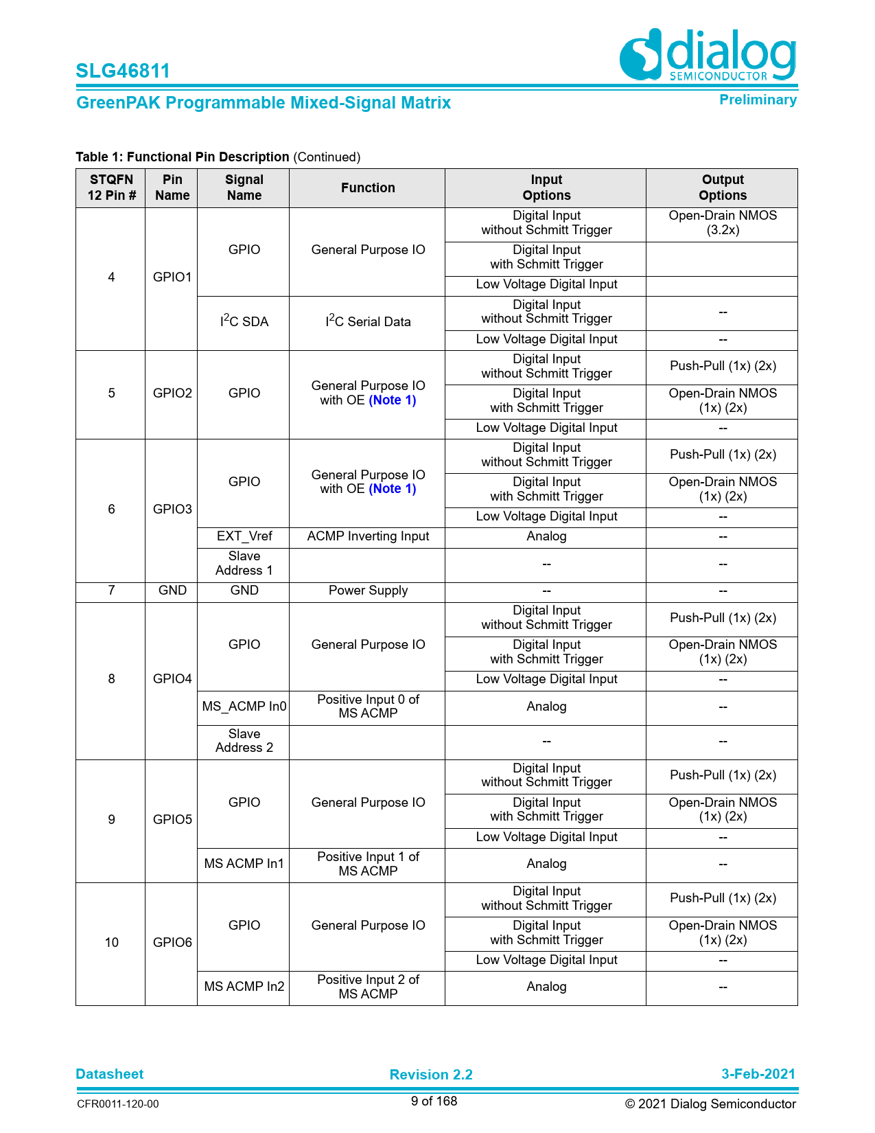

SLG46811. GreenPAK Programmable Mixed-Signal Matrix. Preliminary. Table 1: Functional Pin Description. STQFN. Pin. Signal. Input
link to page 10 link to page 10
SLG46811 GreenPAK Programmable Mixed-Signal Matrix Preliminary Table 1: Functional Pin Description
(Continued)
STQFN Pin Signal Input Output Function 12 Pin # Name Name Options Options
Digital Input Open-Drain NMOS without Schmitt Trigger (3.2x) GPIO General Purpose IO Digital Input with Schmitt Trigger 4 GPIO1 Low Voltage Digital Input Digital Input -- I2C SDA I2C Serial Data without Schmitt Trigger Low Voltage Digital Input -- Digital Input Push-Pull (1x) (2x) without Schmitt Trigger General Purpose IO 5 GPIO2 GPIO Digital Input Open-Drain NMOS with OE
(Note 1)
with Schmitt Trigger (1x) (2x) Low Voltage Digital Input -- Digital Input Push-Pull (1x) (2x) without Schmitt Trigger General Purpose IO GPIO Digital Input Open-Drain NMOS with OE
(Note 1)
with Schmitt Trigger (1x) (2x) 6 GPIO3 Low Voltage Digital Input -- EXT_Vref ACMP Inverting Input Analog -- Slave -- -- Address 1 7 GND GND Power Supply -- -- Digital Input Push-Pull (1x) (2x) without Schmitt Trigger GPIO General Purpose IO Digital Input Open-Drain NMOS with Schmitt Trigger (1x) (2x) 8 GPIO4 Low Voltage Digital Input -- Positive Input 0 of MS_ACMP In0 Analog -- MS ACMP Slave -- -- Address 2 Digital Input Push-Pull (1x) (2x) without Schmitt Trigger GPIO General Purpose IO Digital Input Open-Drain NMOS 9 GPIO5 with Schmitt Trigger (1x) (2x) Low Voltage Digital Input -- Positive Input 1 of MS ACMP In1 Analog -- MS ACMP Digital Input Push-Pull (1x) (2x) without Schmitt Trigger GPIO General Purpose IO Digital Input Open-Drain NMOS 10 GPIO6 with Schmitt Trigger (1x) (2x) Low Voltage Digital Input -- Positive Input 2 of MS ACMP In2 Analog -- MS ACMP
