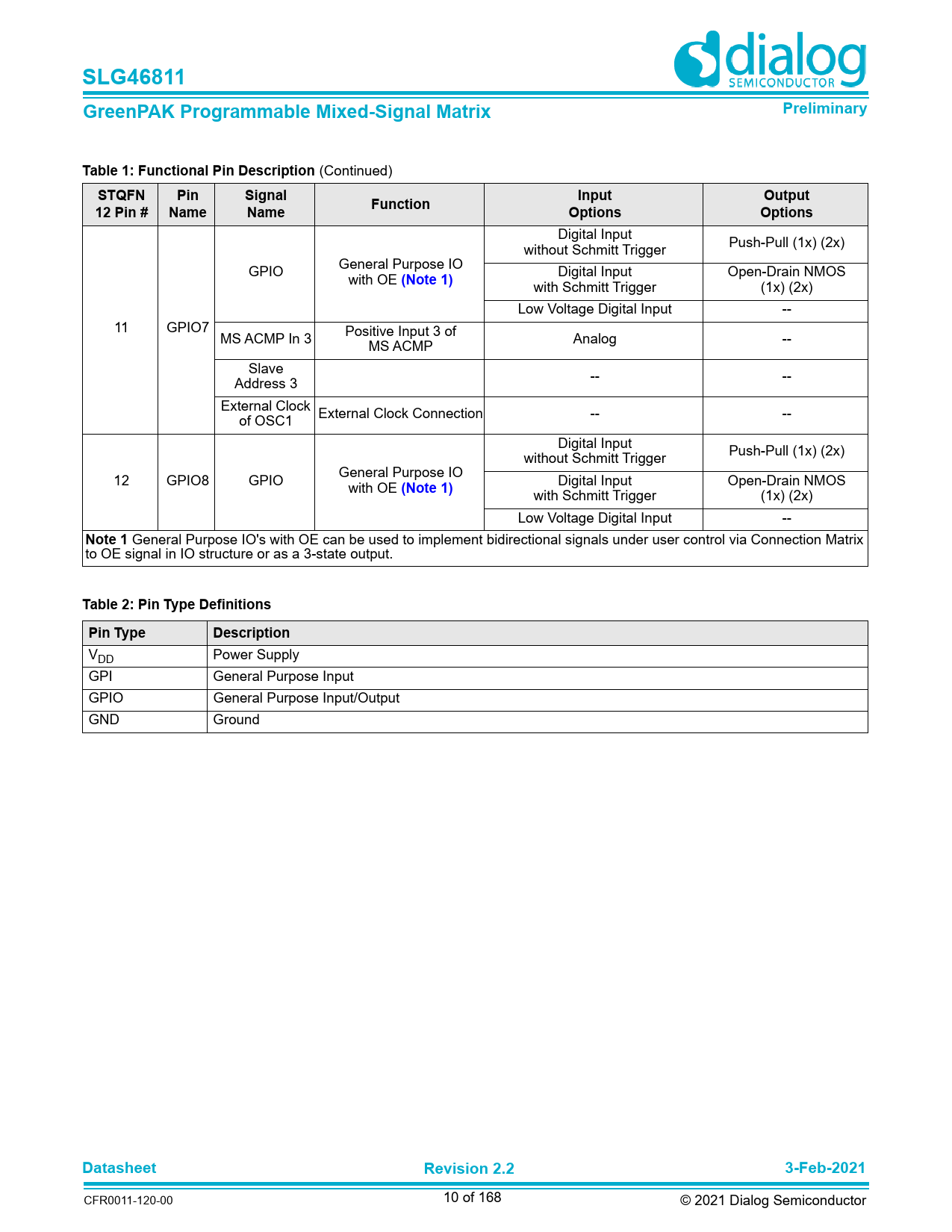

SLG46811. GreenPAK Programmable Mixed-Signal Matrix. Preliminary. Table 1: Functional Pin Description. STQFN. Pin. Signal. Input
SLG46811 GreenPAK Programmable Mixed-Signal Matrix Preliminary Table 1: Functional Pin Description STQFN Pin Signal Input
link to page 10 link to page 10
(Continued)
STQFN Pin Signal Input Output Function 12 Pin # Name Name Options Options
Digital Input Push-Pull (1x) (2x) without Schmitt Trigger General Purpose IO GPIO Digital Input Open-Drain NMOS with OE
(Note 1)
with Schmitt Trigger (1x) (2x) Low Voltage Digital Input -- 11 GPIO7 Positive Input 3 of MS ACMP In 3 Analog -- MS ACMP Slave -- -- Address 3 External Clock External Clock Connection -- -- of OSC1 Digital Input Push-Pull (1x) (2x) without Schmitt Trigger General Purpose IO 12 GPIO8 GPIO Digital Input Open-Drain NMOS with OE
(Note 1)
Note 1
General Purpose IO's with OE can be used to implement bidirectional signals under user control via Connection Matrix to OE signal in IO structure or as a 3-state output.
Table 2: Pin Type Definitions Pin Type Description
VDD Power Supply GPI General Purpose Input GPIO General Purpose Input/Output GND Ground
