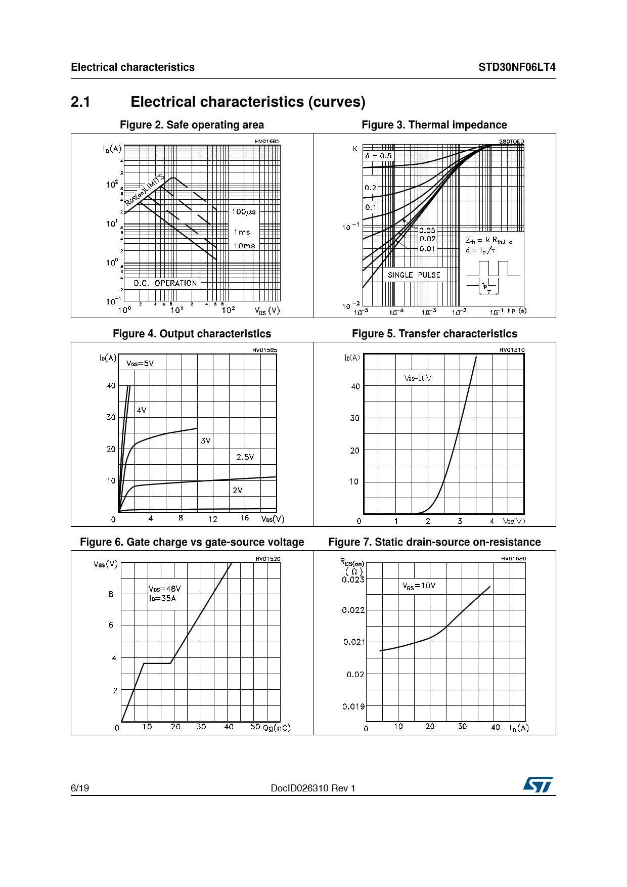

Electrical characteristics. STD30NF06LT4. 2.1. Electrical characteristics (curves). Figure 2. Safe operating area
Electrical characteristics STD30NF06LT4 2.1 Electrical characteristics (curves) Figure 2 Safe operating area
Electrical characteristics STD30NF06LT4 2.1 Electrical characteristics (curves) Figure 2. Safe operating area Figure 3. Thermal impedance Figure 4. Output characteristics Figure 5. Transfer characteristics Figure 6. Gate charge vs gate-source voltage Figure 7. Static drain-source on-resistance
