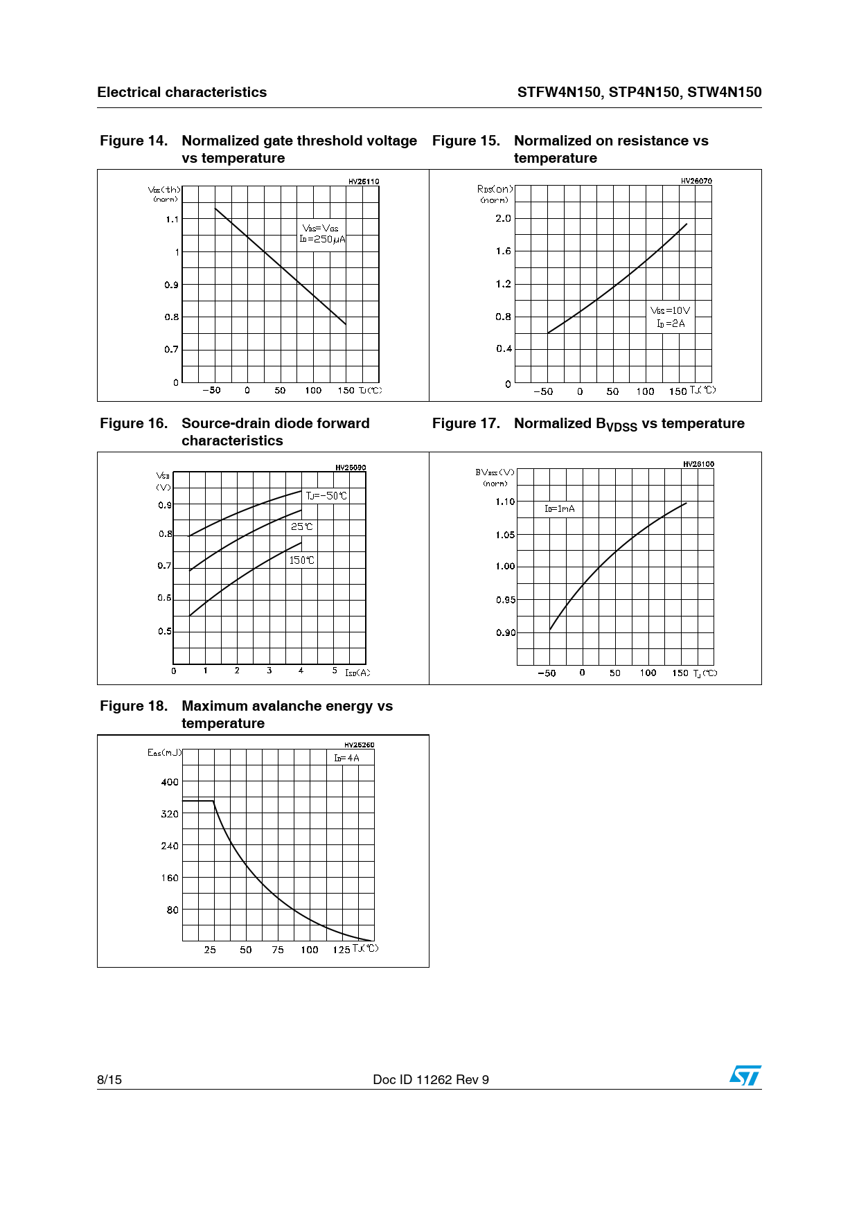

Electrical characteristics. STFW4N150, STP4N150, STW4N150
Electrical characteristics STFW4N150, STP4N150, STW4N150 Figure 14. Normalized gate threshold voltage Figure 15. Normalized on resistance vs vs temperature temperature Figure 16. Source-drain diode forward Figure 17. Normalized BVDSS vs temperature characteristics Figure 18. Maximum avalanche energy vs temperature
