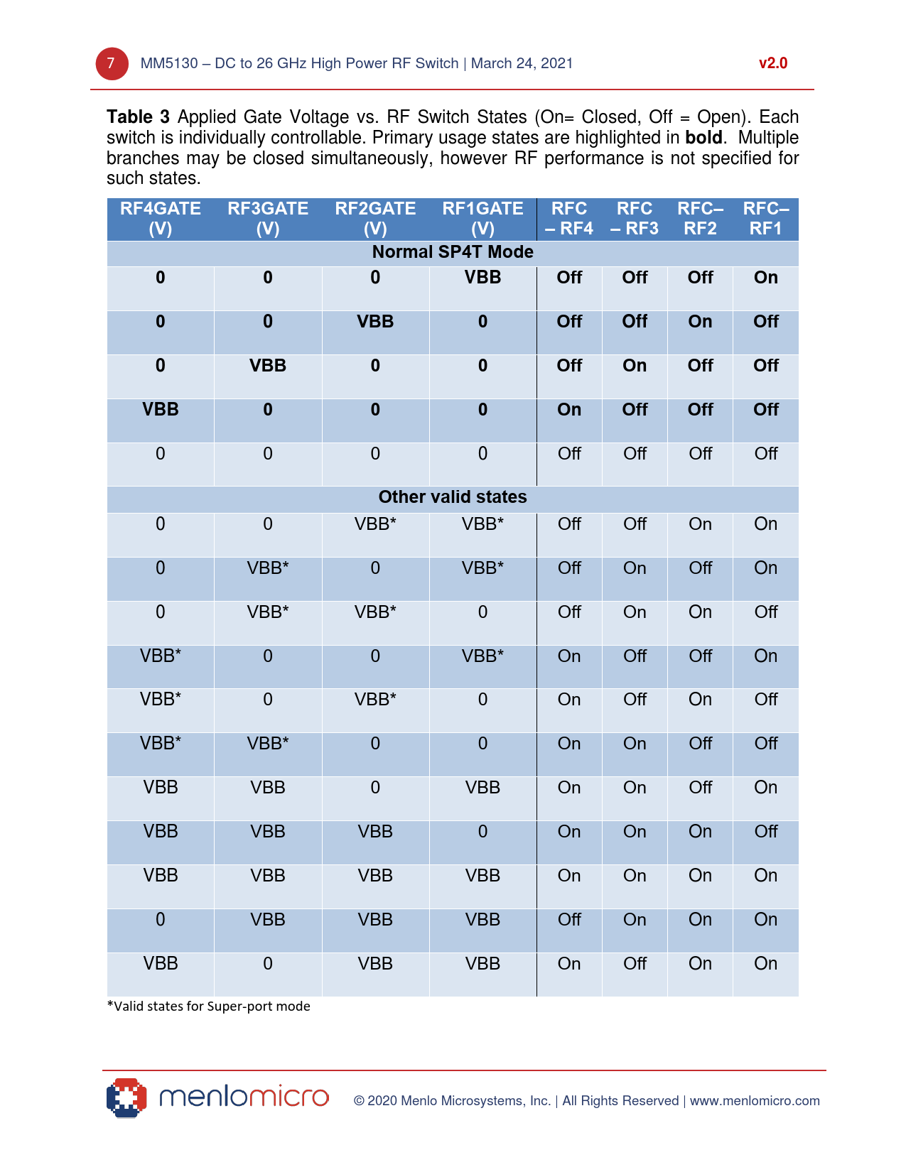

v2.0 Table 3
Applied Gate Voltage vs. RF Switch States (On= Closed, Off = Open). Each switch is individually controllable. Primary usage states are highlighted in
bold
. Multiple branches may be closed simultaneously, however RF performance is not specified for such states.
RF4GATE RF3GATE RF2GATE RF1GATE RFC RFC RFC– RFC– (V) (V) (V) (V) – RF4 – RF3 RF2 RF1 Normal SP4T Mode 0 0 0 VBB Off Off Off On 0 0 VBB 0 Off Off On Off 0 VBB 0 0 Off On Off Off VBB 0 0 0 On Off Off Off
0 0 0 0 Off Off Off Off
Other valid states
0 0 VBB* VBB* Off Off On On 0 VBB* 0 VBB* Off On Off On 0 VBB* VBB* 0 Off On On Off VBB* 0 0 VBB* On Off Off On VBB* 0 VBB* 0 On Off On Off VBB* VBB* 0 0 On On Off Off VBB VBB 0 VBB On On Off On VBB VBB VBB 0 On On On Off VBB VBB VBB VBB On On On On 0 VBB VBB VBB Off On On On VBB 0 VBB VBB On Off On On *Valid states for Super-port mode © 2020 Menlo Microsystems, Inc. | All Rights Reserved | www.menlomicro.com
