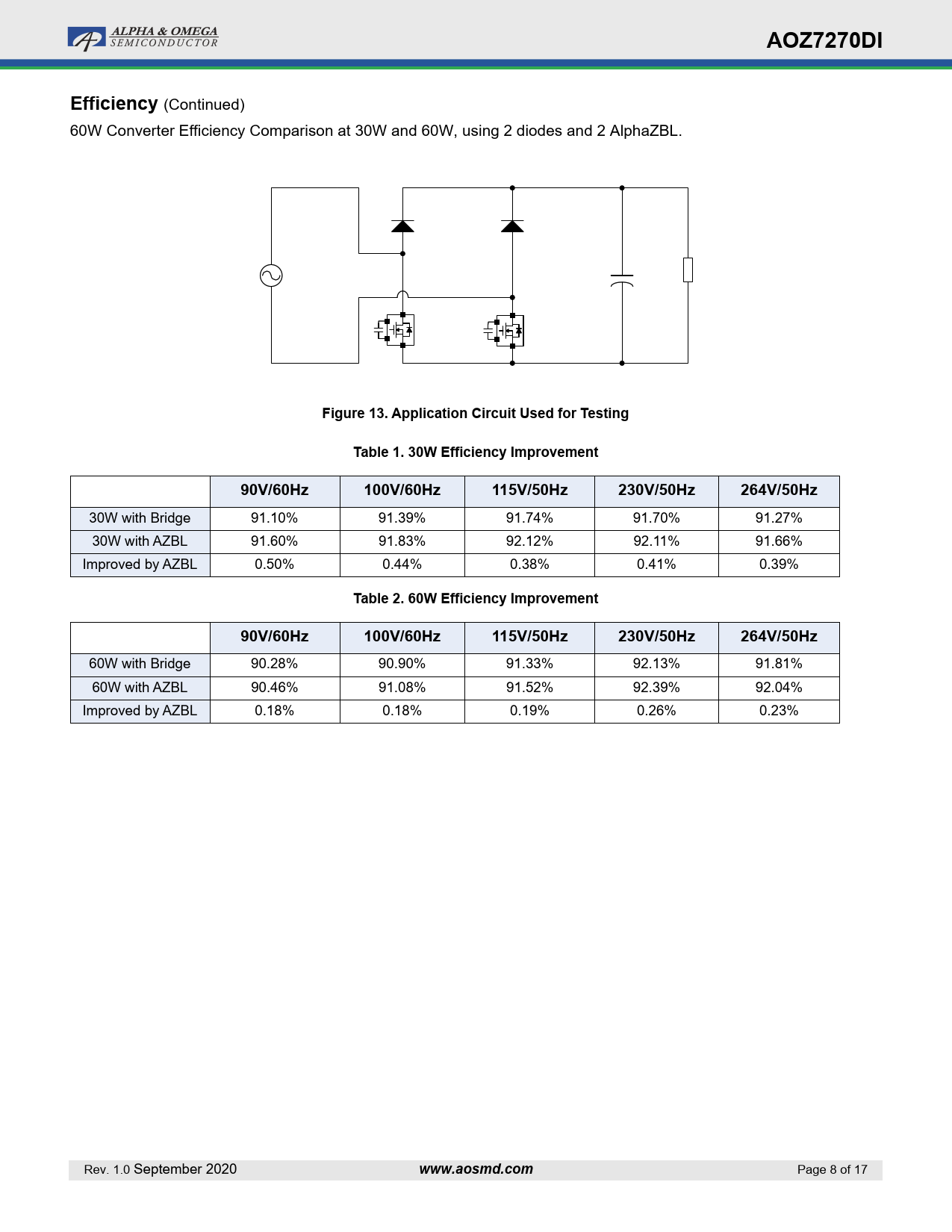

AOZ7270DI. Efficiency. Figure 13. Application Circuit Used for Testing. Table 1. 30W Efficiency Improvement. 90V/60Hz. 100V/60Hz
AOZ7270DI Efficiency Figure 13 Application Circuit Used for Testing Table 1 30W Efficiency Improvement 90V/60Hz 100V/60Hz
(Continued) 60W Converter Efficiency Comparison at 30W and 60W, using 2 diodes and 2 AlphaZBL.
Figure 13. Application Circuit Used for Testing Table 1. 30W Efficiency Improvement 90V/60Hz 100V/60Hz 115V/50Hz 230V/50Hz 264V/50Hz
30W with Bridge 91.10% 91.39% 91.74% 91.70% 91.27% 30W with AZBL 91.60% 91.83% 92.12% 92.11% 91.66% Improved by AZBL 0.50% 0.44% 0.38% 0.41% 0.39%
Table 2. 60W Efficiency Improvement 90V/60Hz 100V/60Hz 115V/50Hz 230V/50Hz 264V/50Hz
60W with Bridge 90.28% 90.90% 91.33% 92.13% 91.81% 60W with AZBL 90.46% 91.08% 91.52% 92.39% 92.04% Improved by AZBL 0.18% 0.18% 0.19% 0.26% 0.23% Rev. 1.0 September 2020
