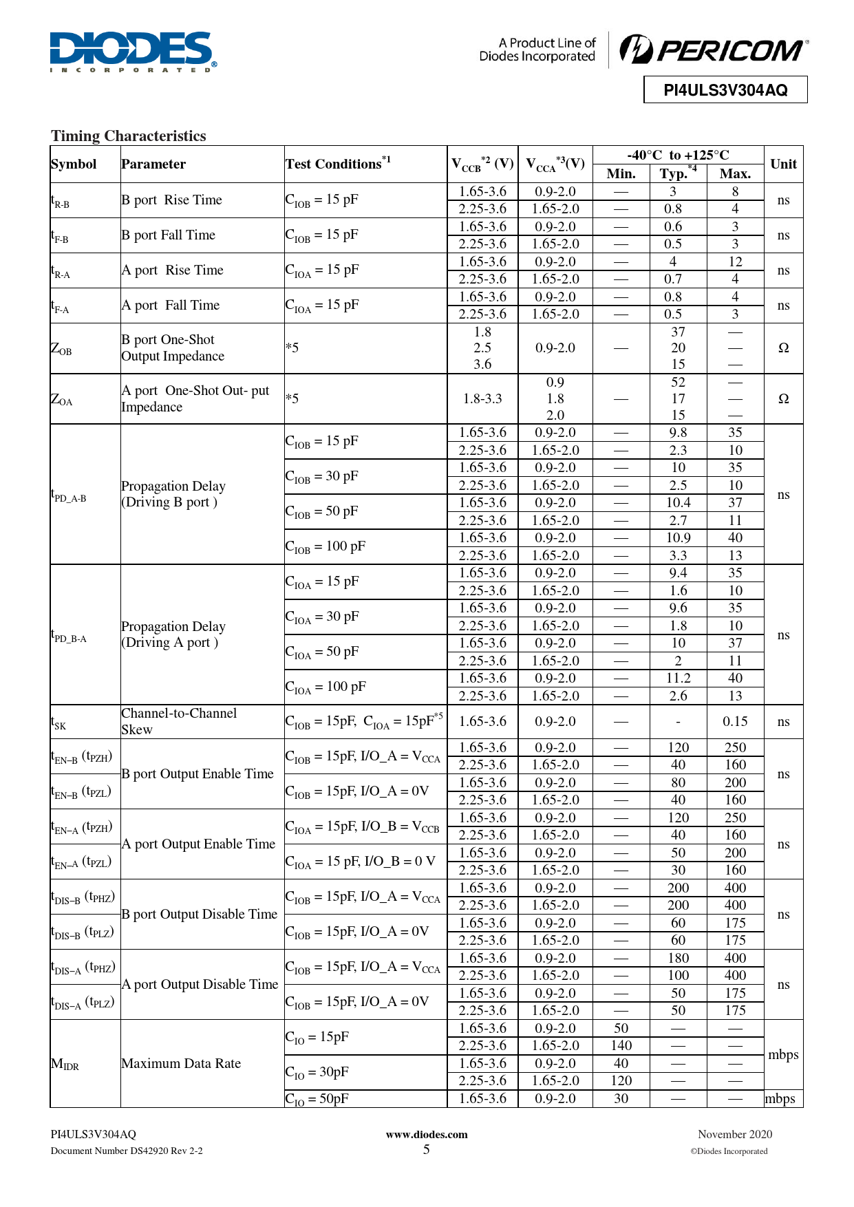

PI4ULS3V304AQ. Timing Characteristics. -40°C to +125°C. Symbol. Parameter. Test Conditions*1. *3(V). CCB. (V). VCCA. Unit. Min. Typ.*4. Max
PI4ULS3V304AQ Timing Characteristics -40°C to +125°C Symbol Parameter Test Conditions*1 V *2 *3(V) CCB (V) VCCA Unit Min. Typ.*4 Max.
1.65-3.6 0.9-2.0 — 3 8 t ns R-B B port Rise Time CIOB = 15 pF 2.25-3.6 1.65-2.0 — 0.8 4 1.65-3.6 0.9-2.0 — 0.6 3 t ns F-B B port Fall Time CIOB = 15 pF 2.25-3.6 1.65-2.0 — 0.5 3 1.65-3.6 0.9-2.0 — 4 12 t ns R-A A port Rise Time CIOA = 15 pF 2.25-3.6 1.65-2.0 — 0.7 4 1.65-3.6 0.9-2.0 — 0.8 4 t ns F-A A port Fall Time CIOA = 15 pF 2.25-3.6 1.65-2.0 — 0.5 3 1.8 37 — B port One-Shot Z — Ω OB *5 2.5 0.9-2.0 — 20 Output Impedance 3.6 15 — 0.9 52 — A port One-Shot Out- put Z — — Ω OA *5 1.8-3.3 1.8 17 Impedance 2.0 15 — 1.65-3.6 0.9-2.0 — 9.8 35 CIOB = 15 pF 2.25-3.6 1.65-2.0 — 2.3 10 1.65-3.6 0.9-2.0 — 10 35 C Propagation Delay IOB = 30 pF 2.25-3.6 1.65-2.0 — 2.5 10 t ns PD_A-B (Driving B port ) 1.65-3.6 0.9-2.0 — 10.4 37 CIOB = 50 pF 2.25-3.6 1.65-2.0 — 2.7 11 1.65-3.6 0.9-2.0 — 10.9 40 CIOB = 100 pF 2.25-3.6 1.65-2.0 — 3.3 13 1.65-3.6 0.9-2.0 — 9.4 35 CIOA = 15 pF 2.25-3.6 1.65-2.0 — 1.6 10 1.65-3.6 0.9-2.0 — 9.6 35 C Propagation Delay IOA = 30 pF 2.25-3.6 1.65-2.0 — 1.8 10 t ns PD_B-A (Driving A port ) 1.65-3.6 0.9-2.0 — 10 37 CIOA = 50 pF 2.25-3.6 1.65-2.0 — 2 11 1.65-3.6 0.9-2.0 — 11.2 40 CIOA = 100 pF 2.25-3.6 1.65-2.0 — 2.6 13 Channel-to-Channel t C SK Skew IOB = 15pF, CIOA = 15pF*5 1.65-3.6 0.9-2.0 — - 0.15 ns 1.65-3.6 0.9-2.0 — 120 250 t (t C EN−B PZH) IOB = 15pF, I/O_A = VCCA 2.25-3.6 1.65-2.0 — 40 160 B port Output Enable Time ns 1.65-3.6 0.9-2.0 — 80 200 t (t EN−B PZL) CIOB = 15pF, I/O_A = 0V 2.25-3.6 1.65-2.0 — 40 160 1.65-3.6 0.9-2.0 — 120 250 t C EN−A (tPZH) IOA = 15pF, I/O_B = VCCB 2.25-3.6 1.65-2.0 — 40 160 A port Output Enable Time ns 1.65-3.6 0.9-2.0 — 50 200 tEN−A (tPZL) CIOA = 15 pF, I/O_B = 0 V 2.25-3.6 1.65-2.0 — 30 160 1.65-3.6 0.9-2.0 — 200 400 t (t C DIS−B PHZ) IOB = 15pF, I/O_A = VCCA 2.25-3.6 1.65-2.0 — 200 400 B port Output Disable Time ns 1.65-3.6 0.9-2.0 — 60 175 t (t DIS−B PLZ) CIOB = 15pF, I/O_A = 0V 2.25-3.6 1.65-2.0 — 60 175 1.65-3.6 0.9-2.0 — 180 400 t (t C DIS−A PHZ) IOB = 15pF, I/O_A = VCCA 2.25-3.6 1.65-2.0 — 100 400 A port Output Disable Time ns 1.65-3.6 0.9-2.0 — 50 175 t (t DIS−A PLZ) CIOB = 15pF, I/O_A = 0V 2.25-3.6 1.65-2.0 — 50 175 1.65-3.6 0.9-2.0 50 — — CIO = 15pF 2.25-3.6 1.65-2.0 140 — — mbps MIDR Maximum Data Rate 1.65-3.6 0.9-2.0 40 — — CIO = 30pF 2.25-3.6 1.65-2.0 120 — — CIO = 50pF 1.65-3.6 0.9-2.0 30 — — mbps PI4ULS3V304AQ
