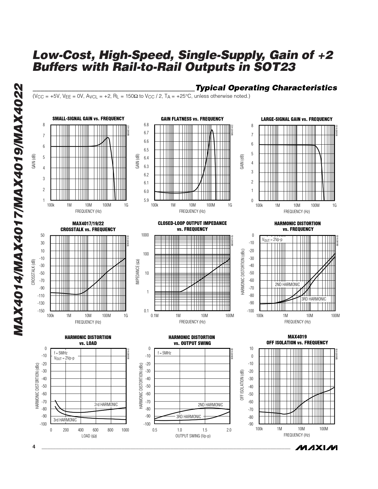

Low-Cost, High-Speed, Single-Supply, Gain of +2 Buffers with Rail-to-Rail Outputs in SOT23 __________________________________________Typical Operating Characteristics
(VCC = +5V, VEE = 0V, AVCL = +2, RL = 150Ω to VCC / 2, TA = +25°C, unless otherwise noted.)
SMALL-SIGNAL GAIN vs. FREQUENCY GAIN FLATNESS vs. FREQUENCY LARGE-SIGNAL GAIN vs. FREQUENCY
8 6.8 8 6.7 MAX4014-01 7 MAX4014-02 7 MAX4014-03 6.6 6 6 6.5 5 5 6.4 4 GAIN (dB) 4 GAIN (dB) 6.3 GAIN (dB) 3 6.2 3 6.1 2 2 6.0 1 1 5.9 0 100k 1M 10M 100M 1G 100k 1M 10M 100M 1G 100k 1M 10M 100M 1G FREQUENCY (Hz) FREQUENCY (Hz) FREQUENCY (Hz)
MAX4017/19/22 CLOSED-LOOP OUTPUT IMPEDANCE HARMONIC DISTORTION CROSSTALK vs. FREQUENCY vs. FREQUENCY vs. FREQUENCY
50 1000 0 VOUT = 2Vp-p 30 -10 MAX4014-04 MAX4014-05 MAX4014-06 10 -20 100 -10 ) -30 Ω -30 -40 -50 10 -50 -70 -60 CROSSTALK (dB) IMPEDANCE ( 2ND HARMONIC -90 -70 1 HARMONIC DISTORTION (dBc) -110 -80 3RD HARMONIC -130 -90 -150 0.1 -100 100k 1M 10M 100M 1G 0.1M 1M 10M 100M 100k 1M 10M 100M FREQUENCY (Hz) FREQUENCY (Hz) FREQUENCY (Hz)
MAX4014/MAX4017/MAX4019/MAX4022 HARMONIC DISTORTION HARMONIC DISTORTION MAX4019 vs. LOAD vs. OUTPUT SWING OFF ISOLATION vs. FREQUENCY
0 0 10 f = 5MHz f = 5MHz -10 -10 V 0 MAX4014-07 OUT = 2Vp-p MAX4014-08 MAX4014-09 -20 -20 -10 -30 -30 -20 -40 -40 -30 -50 -50 -40 -60 -60 -50 OFF ISOLATION (dB) -70 -70 -60 2rd HARMONIC 2ND HARMONIC HARMONIC DISTORTION (dBc) -80 HARMONIC DISTORTION (dBc) -80 -70 -90 -90 3RD HARMONIC -80 3rd HARMONIC -100 -100 -90 0 200 400 600 800 1000 0.5 1.0 1.5 2.0 100k 1M 10M 100M LOAD (Ω) OUTPUT SWING (Vp-p) FREQUENCY (Hz)
