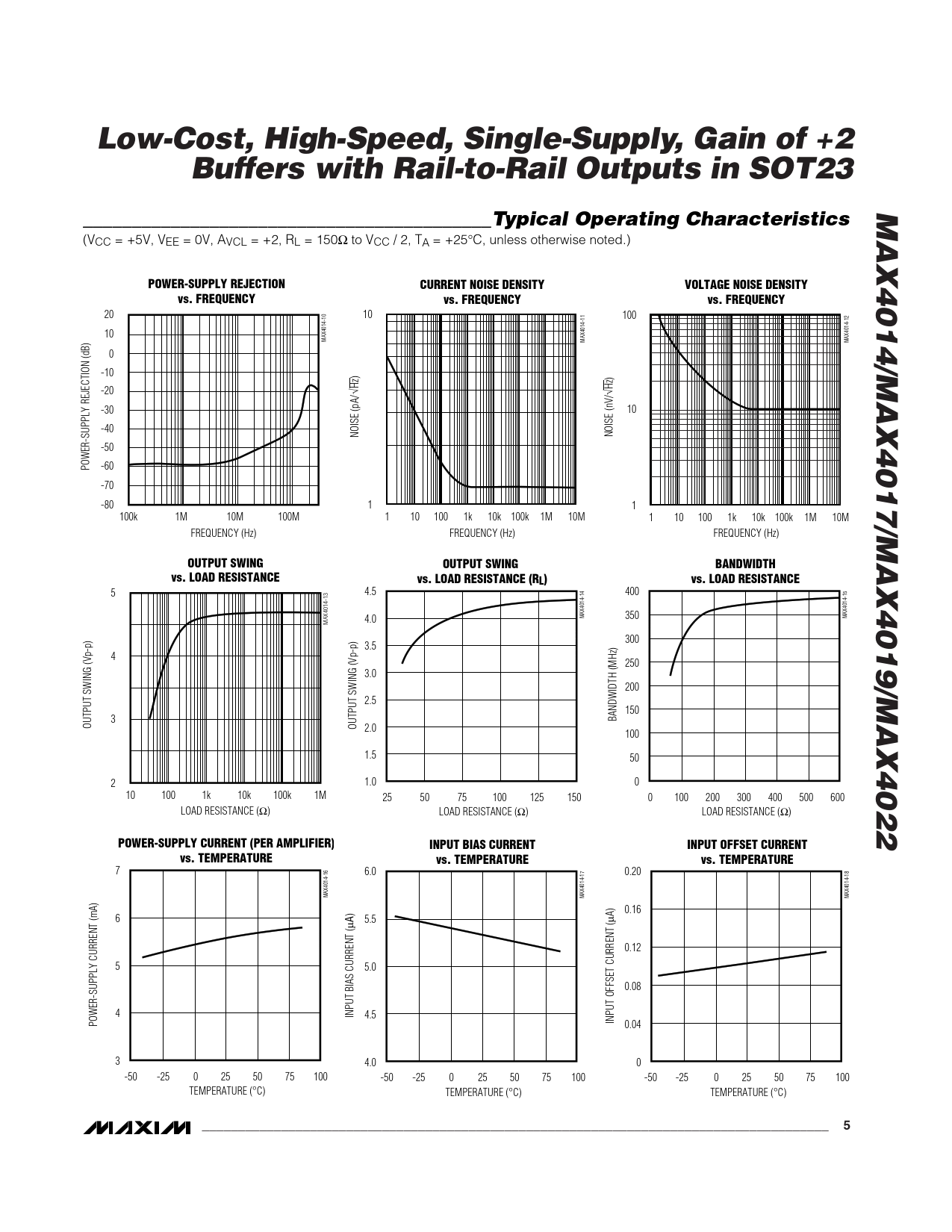

Low-Cost, High-Speed, Single-Supply, Gain of +2 Buffers with Rail-to-Rail Outputs in SOT23 MAX4014/MAX4017/MAX4019/MAX4022 __________________________________________Typical Operating Characteristics
(VCC = +5V, VEE = 0V, AVCL = +2, RL = 150Ω to VCC / 2, TA = +25°C, unless otherwise noted.)
POWER-SUPPLY REJECTION CURRENT NOISE DENSITY VOLTAGE NOISE DENSITY vs. FREQUENCY vs. FREQUENCY vs. FREQUENCY
20 10 100 10 MAX4014-10 MAX4014-11 MAX4014-12 0 -10 -20 √Hz) √Hz) -30 10 -40 NOISE (pA/ NOISE (nV/ -50 POWER-SUPPLY REJECTION (dB) -60 -70 -80 1 1 100k 1M 10M 100M 1 10 100 1k 10k 100k 1M 10M 1 10 100 1k 10k 100k 1M 10M FREQUENCY (Hz) FREQUENCY (Hz) FREQUENCY (Hz)
OUTPUT SWING OUTPUT SWING BANDWIDTH vs. LOAD RESISTANCE vs. LOAD RESISTANCE (RL) vs. LOAD RESISTANCE
5 4.5 400 4.0 MAX4014-14 350 MAX4014-15 MAX4014-13 300 3.5 4 250 3.0 200 2.5 150 3 BANDWIDTH (MHz) OUTPUT SWING (Vp-p) OUTPUT SWING (Vp-p) 2.0 100 1.5 50 2 1.0 0 10 100 1k 10k 100k 1M 25 50 75 100 125 150 0 100 200 300 400 500 600 LOAD RESISTANCE (Ω) LOAD RESISTANCE (Ω) LOAD RESISTANCE (Ω)
POWER-SUPPLY CURRENT (PER AMPLIFIER) INPUT BIAS CURRENT INPUT OFFSET CURRENT vs. TEMPERATURE vs. TEMPERATURE vs. TEMPERATURE
7 6.0 0.20 MAX4014-16 MAX4014-17 MAX4014-18 ) 0.16 6 5.5 µA µA) 0.12 5 5.0 0.08 4 INPUT BIAS CURRENT ( 4.5 POWER-SUPPLY CURRENT (mA) INPUT OFFSET CURRENT ( 0.04 3 4.0 0 -50 -25 0 25 50 75 100 -50 -25 0 25 50 75 100 -50 -25 0 25 50 75 100 TEMPERATURE (°C) TEMPERATURE (°C) TEMPERATURE (°C)
