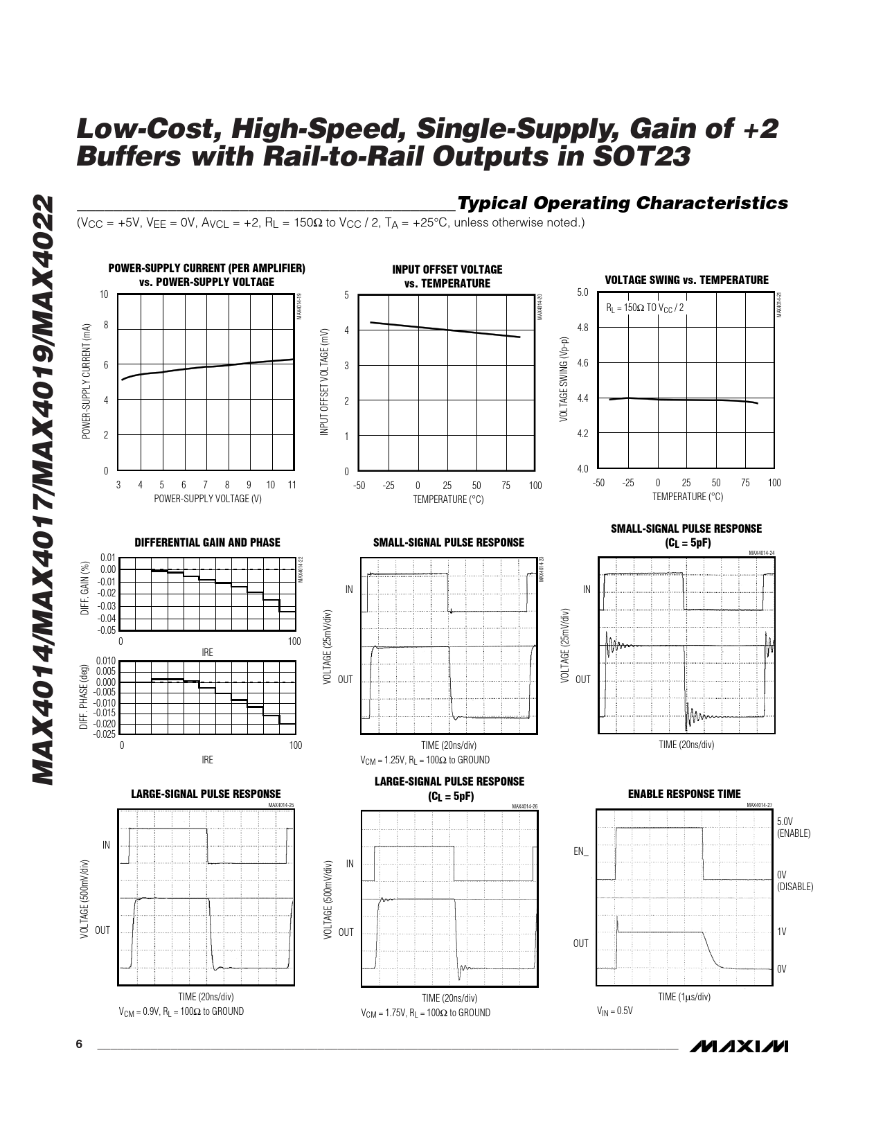

Low-Cost, High-Speed, Single-Supply, Gain of +2 Buffers with Rail-to-Rail Outputs in SOT23
Low-Cost, High-Speed, Single-Supply, Gain of +2 Buffers with Rail-to-Rail Outputs in SOT23 __________________________________________Typical Operating Characteristics
(VCC = +5V, VEE = 0V, AVCL = +2, RL = 150Ω to VCC / 2, TA = +25°C, unless otherwise noted.)
POWER-SUPPLY CURRENT (PER AMPLIFIER) INPUT OFFSET VOLTAGE vs. POWER-SUPPLY VOLTAGE VOLTAGE SWING vs. TEMPERATURE vs. TEMPERATURE
10 5.0 5 RL = 150Ω TO VCC / 2 MAX4014-19 MAX4014-21 MAX4014-20 8 4.8 4 6 4.6 3 4 4.4 2 VOLTAGE SWING (Vp-p) POWER-SUPPLY CURRENT (mA) 2 INPUT OFFSET VOLTAGE (mV) 4.2 1 0 4.0 0 3 4 5 6 7 8 9 10 11 -50 -25 0 25 50 75 100 -50 -25 0 25 50 75 100 POWER-SUPPLY VOLTAGE (V) TEMPERATURE (°C) TEMPERATURE (°C)
SMALL-SIGNAL PULSE RESPONSE DIFFERENTIAL GAIN AND PHASE SMALL-SIGNAL PULSE RESPONSE (CL = 5pF)
0.01 MAX4014-24 0.00 -0.01 MAX4014-22 MAX4014-23 -0.02 IN IN -0.03 DIFF. GAIN (%) -0.04 -0.05 0 100 IRE 0.010 0.005 0.000 VOLTAGE (25mV/div) OUT VOLTAGE (25mV/div) OUT -0.005 -0.010 -0.015 -0.020 DIFF. PHASE (deg) -0.025 0 100 TIME (20ns/div) TIME (20ns/div) IRE VCM = 1.25V, RL = 100Ω to GROUND
MAX4014/MAX4017/MAX4019/MAX4022 LARGE-SIGNAL PULSE RESPONSE LARGE-SIGNAL PULSE RESPONSE (CL = 5pF) ENABLE RESPONSE TIME
MAX4014-25 MAX4014-26 MAX4014-27 5.0V (ENABLE) IN EN_ IN 0V (DISABLE) OUT VOLTAGE (500mV/div) OUT VOLTAGE (500mV/div) 1V OUT 0V TIME (20ns/div) TIME (20ns/div) TIME (1µs/div) VCM = 0.9V, RL = 100Ω to GROUND V V CM = 1.75V, RL = 100Ω to GROUND IN = 0.5V
