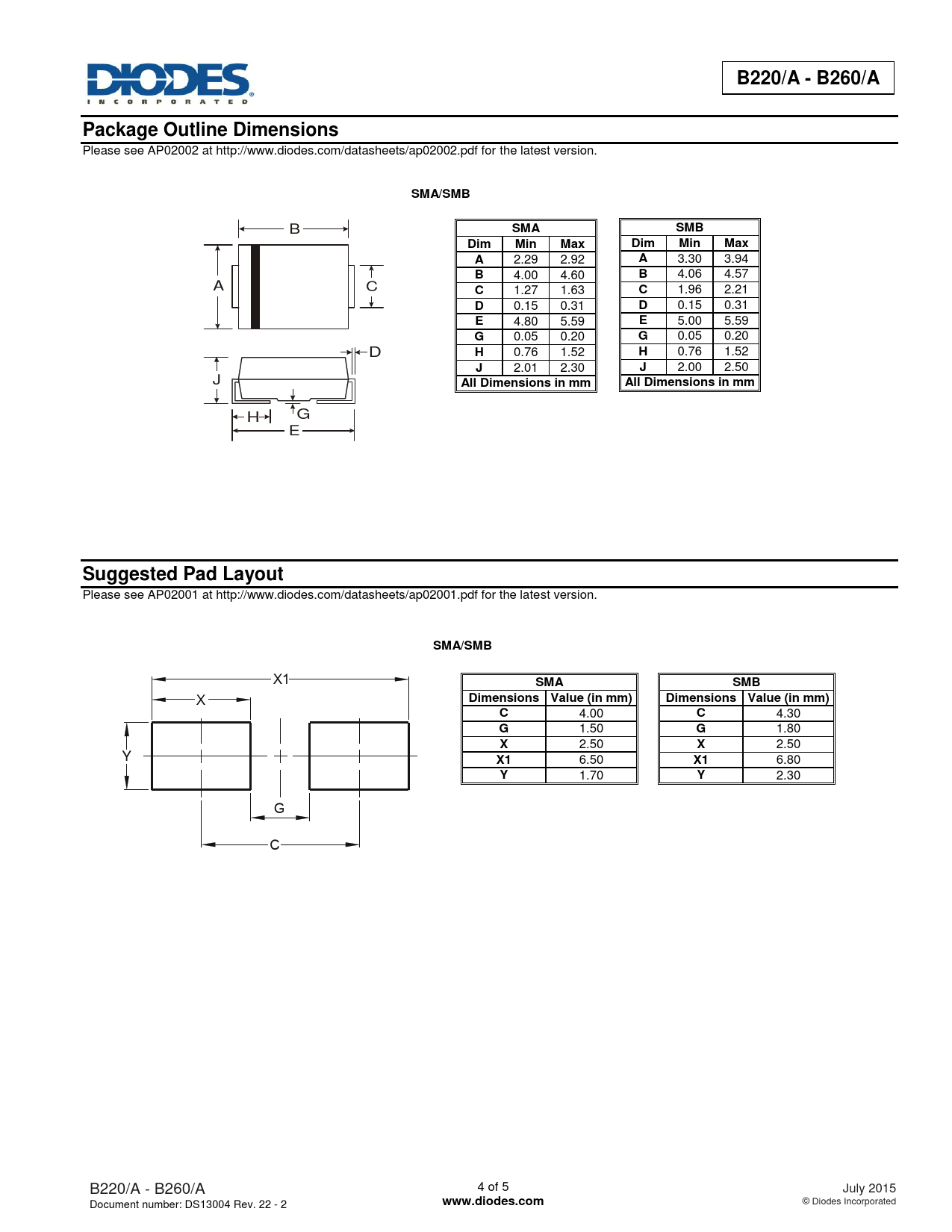

B220/A - B260/A. Package Outline Dimensions. SMA/SMB. SMA. SMB. Dim. Min. Max. All Dimensions in mm. Suggested Pad Layout
B220/A - B260/A Package Outline Dimensions
Please see AP02002 at http://www.diodes.com/datasheets/ap02002.pdf for the latest version.
SMA/SMB
B
SMA SMB Dim Min Max Dim Min Max A
2.29 2.92
A
3.30 3.94
B B
4.00 4.60 4.06 4.57 A C
C
1.27 1.63
C
1.96 2.21
D
0.15 0.31
D
0.15 0.31
E
4.80 5.59
E
5.00 5.59
G
0.05 0.20
G
0.05 0.20 D
H
0.76 1.52
H
0.76 1.52
J
2.01 2.30
J
2.00 2.50 J
All Dimensions in mm All Dimensions in mm
G H E
Please see AP02001 at http://www.diodes.com/datasheets/ap02001.pdf for the latest version.
SMA/SMB
X1
SMA SMB
X
Dimensions Value (in mm) Dimensions Value (in mm) C
4.00
C
4.30
G
1.50
G
1.80
X
2.50
X
2.50 Y
X1
6.50
X1
6.80
Y
1.70
Y
2.30 G C B220/A - B260/A 4 of 5 July 2015 Document number: DS13004 Rev. 22 - 2
