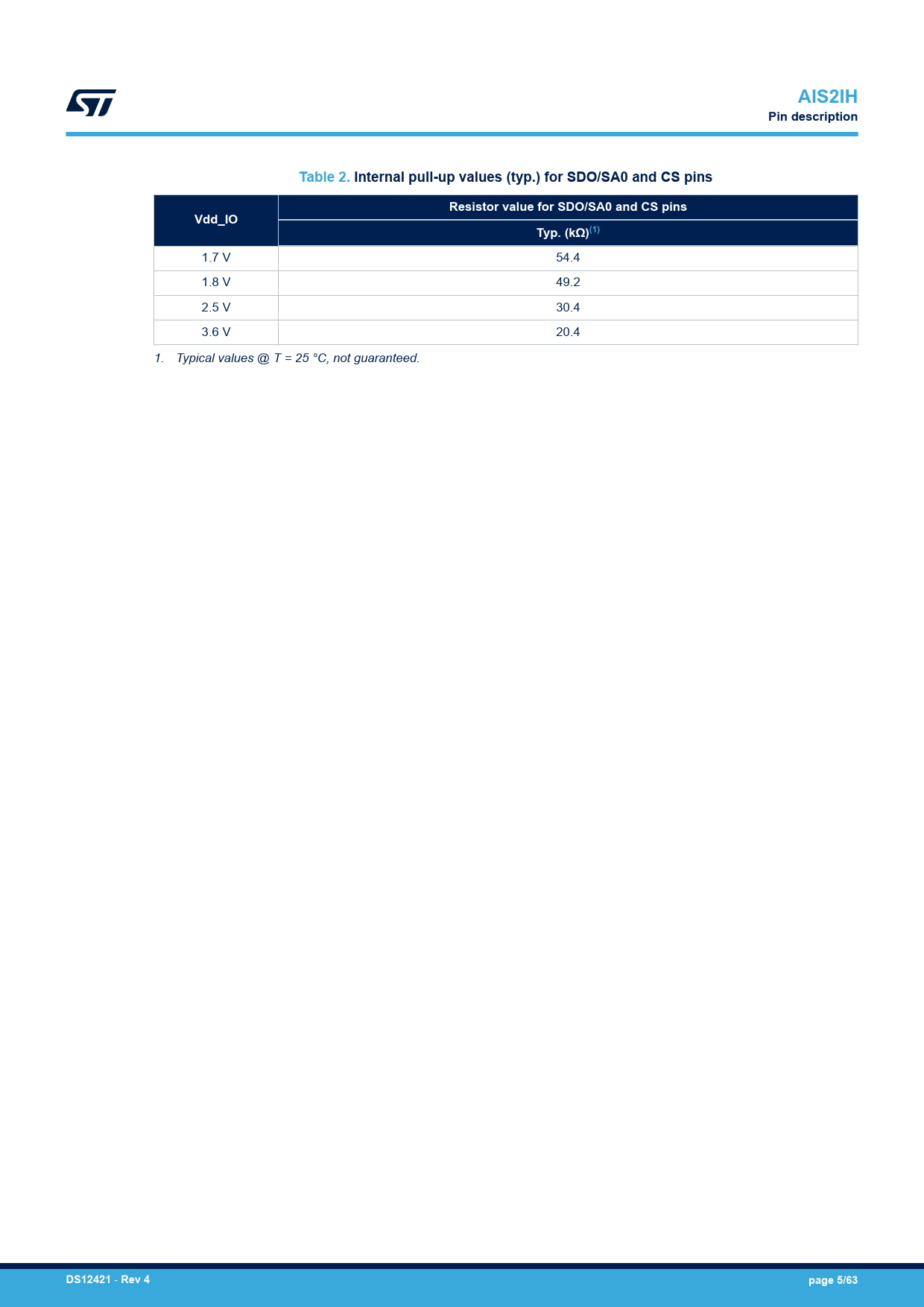

AIS2IH. Pin description. Table 2. Internal pull-up values (typ.) for SDO/SA0 and CS pins
AIS2IH Pin description Table 2 Internal pull-up values (typ.) for SDO/SA0 and CS pins
link to page 5
AIS2IH Pin description Table 2. Internal pull-up values (typ.) for SDO/SA0 and CS pins Resistor value for SDO/SA0 and CS pins Vdd_IO Typ. (kΩ)(1)
1.7 V 54.4 1.8 V 49.2 2.5 V 30.4 3.6 V 20.4 1. Typical values @ T = 25 °C, not guaranteed.
