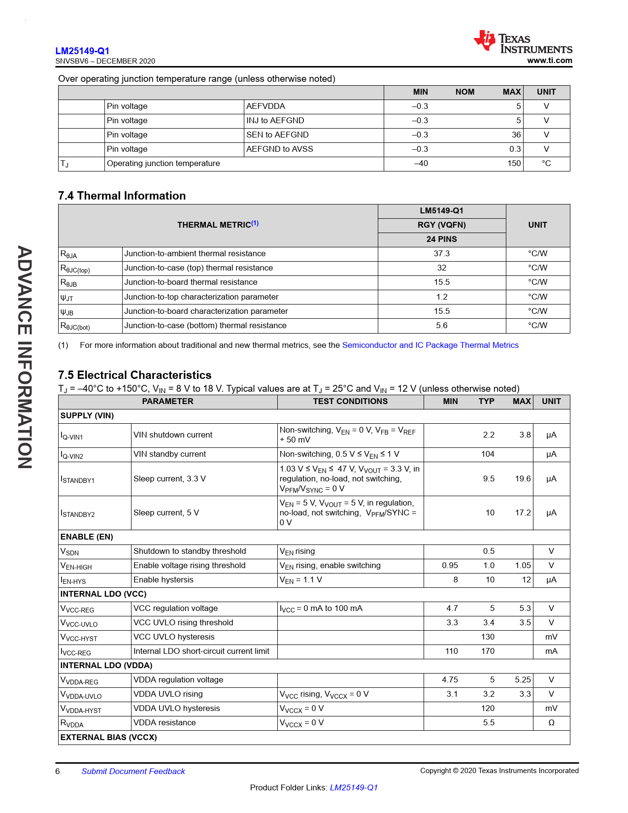

Over operating junction temperature range (unless otherwise noted)
MIN NOM MAX UNIT
Pin voltage AEFVDDA –0.3 5 V Pin voltage INJ to AEFGND –0.3 5 V Pin voltage SEN to AEFGND –0.3 36 V Pin voltage AEFGND to AVSS –0.3 0.3 V TJ Operating junction temperature –40 150 °C
7.4 Thermal Information LM5149-Q1 THERMAL METRIC(1) RGY (VQFN) UNIT 24 PINS AD
RθJA Junction-to-ambient thermal resistance 37.3 °C/W
V
RθJC(top) Junction-to-case (top) thermal resistance 32 °C/W
A
RθJB Junction-to-board thermal resistance 15.5 °C/W
NCE INFO
ψJT Junction-to-top characterization parameter 1.2 °C/W ψJB Junction-to-board characterization parameter 15.5 °C/W RθJC(bot) Junction-to-case (bottom) thermal resistance 5.6 °C/W (1) For more information about traditional and new thermal metrics, see the Semiconductor and IC Package Thermal Metrics
7.5 Electrical Characteristics R
TJ = –40°C to +150°C, VIN = 8 V to 18 V. Typical values are at TJ = 25°C and VIN = 12 V (unless otherwise noted)
MA PARAMETER TEST CONDITIONS MIN TYP MAX UNIT SUPPLY (VIN) TION
Non-switching, V I EN = 0 V, VFB = VREF Q-VIN1 VIN shutdown current 2.2 3.8 µA + 50 mV IQ-VIN2 VIN standby current Non-switching, 0.5 V ≤ VEN ≤ 1 V 104 µA 1.03 V ≤ VEN ≤ 47 V, VVOUT = 3.3 V, in ISTANDBY1 Sleep current, 3.3 V regulation, no-load, not switching, 9.5 19.6 µA VPFM/VSYNC = 0 V VEN = 5 V, VVOUT = 5 V, in regulation, ISTANDBY2 Sleep current, 5 V no-load, not switching, VPFM/SYNC = 10 17.2 µA 0 V
ENABLE (EN)
VSDN Shutdown to standby threshold VEN rising 0.5 V VEN-HIGH Enable voltage rising threshold VEN rising, enable switching 0.95 1.0 1.05 V IEN-HYS Enable hystersis VEN = 1.1 V 8 10 12 µA
INTERNAL LDO (VCC)
VVCC-REG VCC regulation voltage IVCC = 0 mA to 100 mA 4.7 5 5.3 V VVCC-UVLO VCC UVLO rising threshold 3.3 3.4 3.5 V VVCC-HYST VCC UVLO hysteresis 130 mV IVCC-REG Internal LDO short-circuit current limit 110 170 mA
INTERNAL LDO (VDDA)
VVDDA-REG VDDA regulation voltage 4.75 5 5.25 V VVDDA-UVLO VDDA UVLO rising VVCC rising, VVCCX = 0 V 3.1 3.2 3.3 V VVDDA-HYST VDDA UVLO hysteresis VVCCX = 0 V 120 mV RVDDA VDDA resistance VVCCX = 0 V 5.5 Ω
