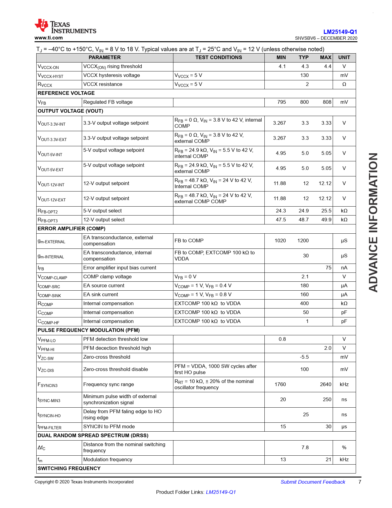

LM25149-Q1. www.ti.com. PARAMETER. TEST CONDITIONS. MIN. TYP. MAX. UNIT. REFERENCE VOLTAGE. OUTPUT VOLTAGE (VOUT). TION
LM25149-Q1 www.ti.com
SNVSBV6 – DECEMBER 2020 TJ = –40°C to +150°C, VIN = 8 V to 18 V. Typical values are at TJ = 25°C and VIN = 12 V (unless otherwise noted)
PARAMETER TEST CONDITIONS MIN TYP MAX UNIT
VVCCX-ON VCCX(ON) rising threshold 4.1 4.3 4.4 V VVCCX-HYST VCCX hysteresis voltage VVCCX = 5 V 130 mV RVCCX VCCX resistance VVCCX = 5 V 2 Ω
REFERENCE VOLTAGE
VFB Regulated FB voltage 795 800 808 mV
R V FB = 0 Ω, VIN = 3.8 V to 42 V, internal OUT-3.3V-INT 3.3-V output voltage setpoint 3.267 3.3 3.33 V COMP R V FB = 0 Ω, VIN = 3.8 V to 42 V, OUT-3.3V-EXT 3.3-V output voltage setpoint 3.267 3.3 3.33 V external COMP 5-V output voltage setpoint R V FB = 24.9 kΩ, VIN = 5.5 V to 42 V, OUT-5V-INT 4.95 5.0 5.05 V internal COMP 5-V output voltage setpoint R V FB = 24.9 kΩ, VIN = 5.5 V to 42 V, OUT-5V-EXT 4.95 5.0 5.05 V external COMP
TION
R V FB = 48.7 kΩ, VIN = 24 V to 42 V, OUT-12V-INT 12-V output setpoint 11.88 12 12.12 V Internal COMP R
MA
V FB = 48.7 kΩ, VIN = 24 V to 42 V, OUT-12V-EXT 12-V output setpoint 11.88 12 12.12 V external COMP COMP
R
RFB-OPT2 5-V output select 24.3 24.9 25.5 kΩ RFB-OPT3 12-V output select 47.5 48.7 49.9 kΩ
ERROR AMPLIFIER (COMP)
EA transconductance, external gm-EXTERNAL FB to COMP 1020 1200 µS compensation EA transconductance, internal FB to COMP, EXTCOMP 100 kΩ to gm-INTERNAL 30 µS compensation VDDA
NCE INFO
I
A
FB Error amplifier input bias current 75 nA
V
VCOMP-CLAMP COMP clamp voltage VFB = 0 V 2.1 V ICOMP-SRC EA source current VCOMP = 1 V, VFB = 0.4 V 180 µA
AD
ICOMP-SINK EA sink current VCOMP = 1 V, VFB = 0.8 V 160 µA RCOMP Internal compensation EXTCOMP 100 kΩ to VDDA 400 kΩ CCOMP Internal compensation EXTCOMP 100 kΩ to VDDA 50 pF CCOMP-HF Internal compensation EXTCOMP 100 kΩ to VDDA 1 pF
PULSE FREQUENCY MODULATION (PFM)
VPFM-LO PFM detection threshold low 0.8 V VPFM-HI PFM decection threshold high 2.0 V VZC-SW Zero-cross threshold -5.5 mV PFM = VDDA, 1000 SW cycles after VZC-DIS Zero-cross threshold disable 100 mV first HO pulse R F RT = 10 kΩ, ± 20% of the nominal SYNCIN3 Frequency sync range 1760 2640 kHz oscillator frequency Minimum pulse width of external tSYNC-MIN3 20 250 ns synchronization signal Delay from PFM faling edge to HO tSYNCIN-HO 25 ns rising edge tPFM-FILTER SYNCIN to PFM mode 15 30 µs
DUAL RANDOM SPREAD SPECTRUM (DRSS)
Distance from the nominal switching ΔfC 7.8 % frequency fm Modulation frequency 13 21 kHz
SWITCHING FREQUENCY
