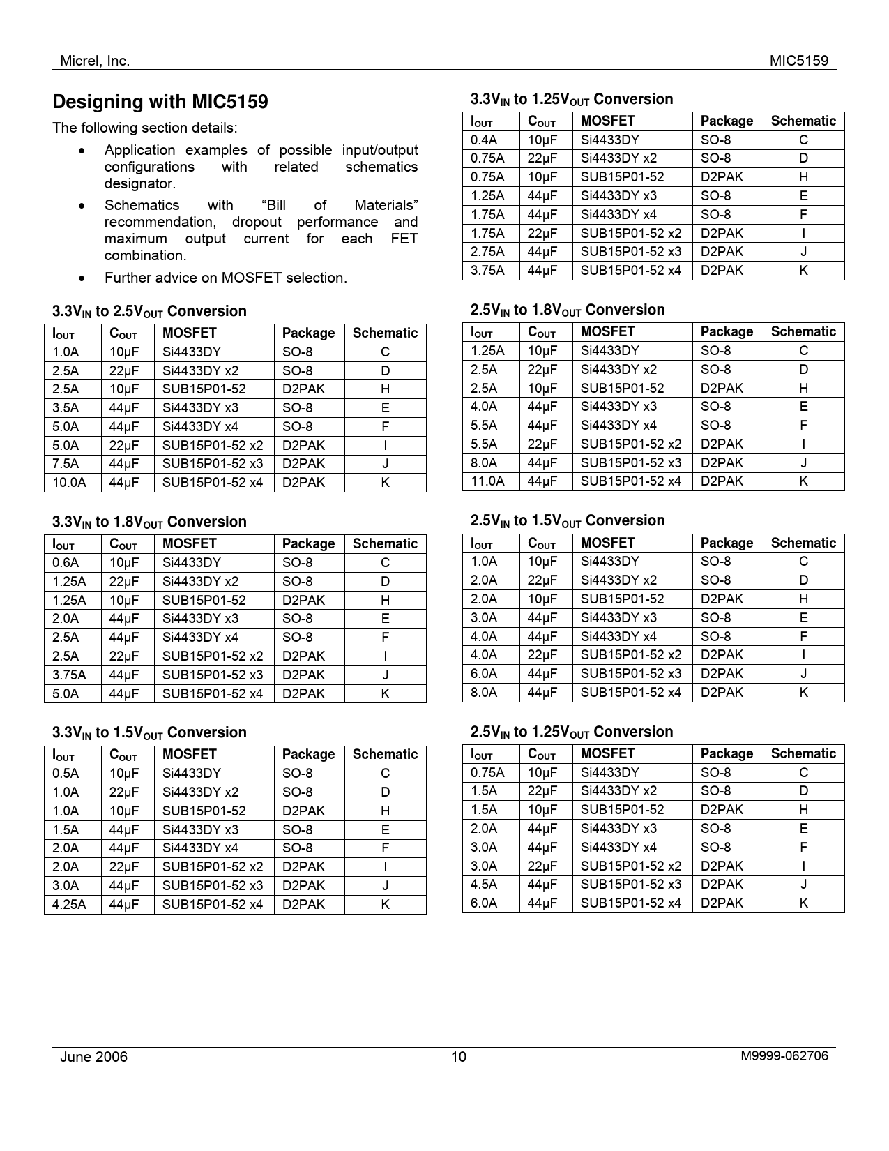

Micrel, Inc. MIC5159
Designing with MIC5159 3.3VIN to 1.25VOUT Conversion
The following section details:
IOUT COUT MOSFET Package Schematic
0.4A 10µF Si4433DY SO-8 C • Application examples of possible input/output configurations with related schematics 0.75A 22µF Si4433DY x2 SO-8 D designator. 0.75A 10µF SUB15P01-52 D2PAK H • 1.25A 44µF Si4433DY x3 SO-8 E Schematics with “Bill of Materials” recommendation, dropout performance and 1.75A 44µF Si4433DY x4 SO-8 F maximum output current for each FET 1.75A 22µF SUB15P01-52 x2 D2PAK I combination. 2.75A 44µF SUB15P01-52 x3 D2PAK J • Further advice on MOSFET selection. 3.75A 44µF SUB15P01-52 x4 D2PAK K
3.3V 2.5V IN to 2.5VOUT Conversion IN to 1.8VOUT Conversion IOUT COUT MOSFET Package Schematic IOUT COUT MOSFET Package Schematic
1.0A 10µF Si4433DY SO-8 C 1.25A 10µF Si4433DY SO-8 C 2.5A 22µF Si4433DY x2 SO-8 D 2.5A 22µF Si4433DY x2 SO-8 D 2.5A 10µF SUB15P01-52 D2PAK H 2.5A 10µF SUB15P01-52 D2PAK H 3.5A 44µF Si4433DY x3 SO-8 E 4.0A 44µF Si4433DY x3 SO-8 E 5.0A 44µF Si4433DY x4 SO-8 F 5.5A 44µF Si4433DY x4 SO-8 F 5.0A 22µF SUB15P01-52 x2 D2PAK I 5.5A 22µF SUB15P01-52 x2 D2PAK I 7.5A 44µF SUB15P01-52 x3 D2PAK J 8.0A 44µF SUB15P01-52 x3 D2PAK J 10.0A 44µF SUB15P01-52 x4 D2PAK K 11.0A 44µF SUB15P01-52 x4 D2PAK K
3.3V 2.5V IN to 1.8VOUT Conversion IN to 1.5VOUT Conversion IOUT COUT MOSFET Package Schematic IOUT COUT MOSFET Package Schematic
0.6A 10µF Si4433DY SO-8 C 1.0A 10µF Si4433DY SO-8 C 1.25A 22µF Si4433DY x2 SO-8 D 2.0A 22µF Si4433DY x2 SO-8 D 1.25A 10µF SUB15P01-52 D2PAK H 2.0A 10µF SUB15P01-52 D2PAK H 2.0A 44µF Si4433DY x3 SO-8 E 3.0A 44µF Si4433DY x3 SO-8 E 2.5A 44µF Si4433DY x4 SO-8 F 4.0A 44µF Si4433DY x4 SO-8 F 2.5A 22µF SUB15P01-52 x2 D2PAK I 4.0A 22µF SUB15P01-52 x2 D2PAK I 3.75A 44µF SUB15P01-52 x3 D2PAK J 6.0A 44µF SUB15P01-52 x3 D2PAK J 5.0A 44µF SUB15P01-52 x4 D2PAK K 8.0A 44µF SUB15P01-52 x4 D2PAK K
3.3V 2.5V IN to 1.5VOUT Conversion IN to 1.25VOUT Conversion IOUT COUT MOSFET Package Schematic IOUT COUT MOSFET Package Schematic
0.5A 10µF Si4433DY SO-8 C 0.75A 10µF Si4433DY SO-8 C 1.0A 22µF Si4433DY x2 SO-8 D 1.5A 22µF Si4433DY x2 SO-8 D 1.0A 10µF SUB15P01-52 D2PAK H 1.5A 10µF SUB15P01-52 D2PAK H 1.5A 44µF Si4433DY x3 SO-8 E 2.0A 44µF Si4433DY x3 SO-8 E 2.0A 44µF Si4433DY x4 SO-8 F 3.0A 44µF Si4433DY x4 SO-8 F 2.0A 22µF SUB15P01-52 x2 D2PAK I 3.0A 22µF SUB15P01-52 x2 D2PAK I 3.0A 44µF SUB15P01-52 x3 D2PAK J 4.5A 44µF SUB15P01-52 x3 D2PAK J 4.25A 44µF SUB15P01-52 x4 D2PAK K 6.0A 44µF SUB15P01-52 x4 D2PAK K June 2006 10 M9999-062706
