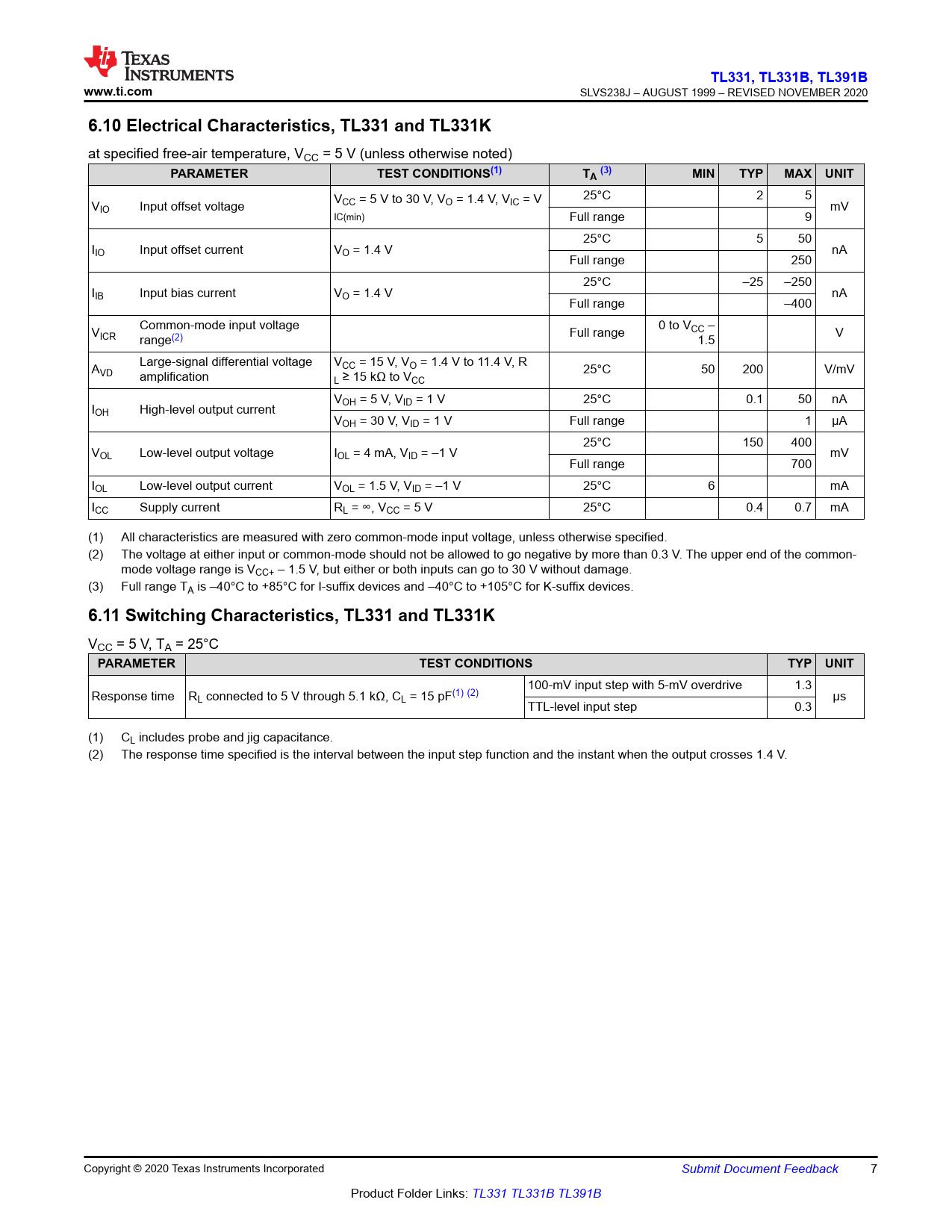

TL331, TL331B, TL391B. www.ti.com. 6.10 Electrical Characteristics, TL331 and TL331K. PARAMETER. TEST CONDITIONS(1). TA (3). MIN. TYP
link to page 7 link to page 7 link to page 7 link to page 7 link to page 7
TL331, TL331B, TL391B www.ti.com
SLVS238J – AUGUST 1999 – REVISED NOVEMBER 2020
at specified free-air temperature, VCC = 5 V (unless otherwise noted)
PARAMETER TEST CONDITIONS(1) TA (3) MIN TYP MAX UNIT
V 25°C 2 5 V CC = 5 V to 30 V, VO = 1.4 V, VIC = V IO Input offset voltage mV IC(min) Full range 9 25°C 5 50 IIO Input offset current VO = 1.4 V nA Full range 250 25°C –25 –250 IIB Input bias current VO = 1.4 V nA Full range –400 Common-mode input voltage 0 to V V CC – ICR V range(2) Full range 1.5 Large-signal differential voltage V A CC = 15 V, VO = 1.4 V to 11.4 V, R VD 25°C 50 200 V/mV amplification L ≥ 15 kΩ to VCC VOH = 5 V, VID = 1 V 25°C 0.1 50 nA IOH High-level output current VOH = 30 V, VID = 1 V Full range 1 μA 25°C 150 400 VOL Low-level output voltage IOL = 4 mA, VID = –1 V mV Full range 700 IOL Low-level output current VOL = 1.5 V, VID = –1 V 25°C 6 mA ICC Supply current RL = ∞, VCC = 5 V 25°C 0.4 0.7 mA (1) All characteristics are measured with zero common-mode input voltage, unless otherwise specified. (2) The voltage at either input or common-mode should not be allowed to go negative by more than 0.3 V. The upper end of the common- mode voltage range is VCC+ – 1.5 V, but either or both inputs can go to 30 V without damage. (3) Full range TA is –40°C to +85°C for I-suffix devices and –40°C to +105°C for K-suffix devices.
6.11 Switching Characteristics, TL331 and TL331K
VCC = 5 V, TA = 25°C
PARAMETER TEST CONDITIONS TYP UNIT
100-mV input step with 5-mV overdrive 1.3 Response time RL connected to 5 V through 5.1 kΩ, CL = 15 pF(1) (2) μs TTL-level input step 0.3 (1) CL includes probe and jig capacitance. (2) The response time specified is the interval between the input step function and the instant when the output crosses 1.4 V. Copyright © 2020 Texas Instruments Incorporated Submit Document Feedback 7 Product Folder Links: TL331 TL331B TL391B Document Outline 1 Features 2 Applications 3 Description Table of Contents 4 Revision History 5 Pin Configuration and Functions Pin Functions 6 Specifications 6.1 Absolute Maximum Ratings, TL331 and TL331K 6.2 Absolute Maximum Ratings, TL331B and TL391B 6.3 ESD Ratings, TL331 and TL331K 6.4 ESD Ratings, TL331B and TL391B 6.5 Recommended Operating Conditions, TL331 and TL331K 6.6 Recommended Operating Conditions, TL331B and TL391B 6.7 Thermal Information 6.8 Electrical Characteristics, TL331B and TL391B 6.9 Switching Characteristics, TL331B and TL391B 6.10 Electrical Characteristics, TL331 and TL331K 6.11 Switching Characteristics, TL331 and TL331K 6.12 Typical Characteristics, TL331 and TL331K 6.13 Typical Characteristics, TL331B and TL391B 7 Detailed Description 7.1 Overview 7.2 Functional Block Diagram 7.3 Feature Description 7.4 Device Functional Modes 7.4.1 Voltage Comparison 8 Application and Implementation 8.1 Application Information 8.2 Typical Application 8.2.1 Design Requirements 8.2.2 Detailed Design Procedure 8.2.2.1 Input Voltage Range 8.2.2.2 Minimum Overdrive Voltage 8.2.2.3 Output and Drive Current 8.2.2.4 TL331B & TL391B ESD Protection 8.2.2.5 Response Time 8.2.3 Application Curves 9 Power Supply Recommendations 10 Layout 10.1 Layout Guidelines 10.2 Layout Example 11 Device and Documentation Support 11.1 Documentation Support 11.1.1 Related Documentation 11.2 Receiving Notification of Documentation Updates 11.3 Support Resources 11.4 Trademarks 11.5 Electrostatic Discharge Caution 11.6 Glossary 12 Mechanical, Packaging, and Orderable Information
