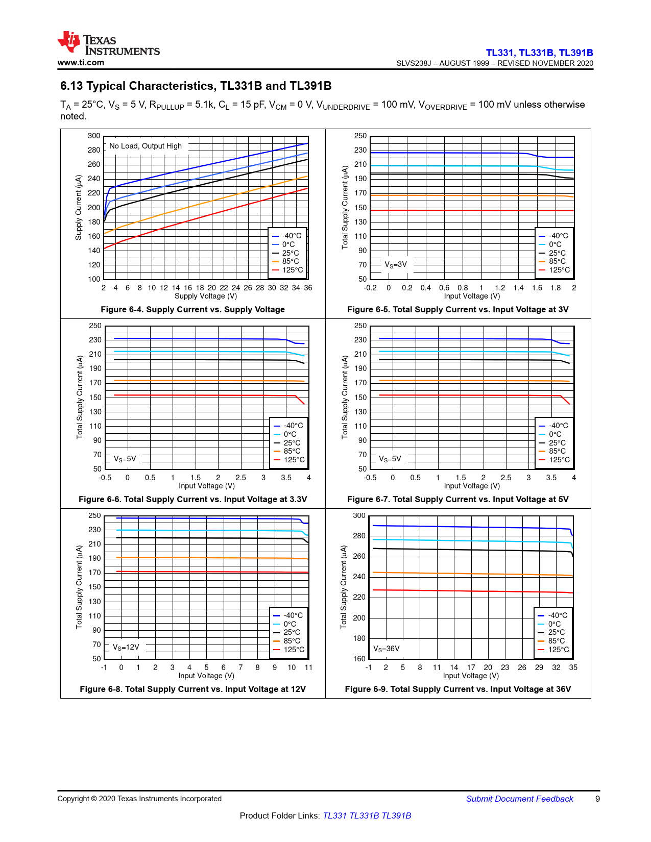

TL331, TL331B, TL391B. www.ti.com. 6.13 Typical Characteristics, TL331B and TL391B
TL331, TL331B, TL391B www.ti.com
SLVS238J – AUGUST 1999 – REVISED NOVEMBER 2020
TA = 25°C, VS = 5 V, RPULLUP = 5.1k, CL = 15 pF, VCM = 0 V, VUNDERDRIVE = 100 mV, VOVERDRIVE = 100 mV unless otherwise noted. 300 250 No Load, Output High 280 230 260 ) 210 A ) A 240 t (P 190 P n nt ( 220 rre 170 u 200 C 150 Curre ly p 180 p u 130 pply l S Su 160 -40°C ta 110 -40°C 0°C o 0°C 140 T 25°C 90 25°C 120 85°C 70 V 85°C 125°C S=3V 125°C 100 50 2 4 6 8 10 12 14 16 18 20 22 24 26 28 30 32 34 36 -0.2 0 0.2 0.4 0.6 0.8 1 1.2 1.4 1.6 1.8 2 Supply Voltage (V) Input Voltage (V)
Figure 6-4. Supply Current vs. Supply Voltage Figure 6-5. Total Supply Current vs. Input Voltage at 3V
250 250 230 230 ) 210 ) 210 A A t (P 190 t (P 190 n n rre 170 rre 170 u u C C ly 150 ly 150 p p p p u 130 u 130 l S l S ta 110 -40°C ta 110 -40°C o o T 0°C 0°C 90 T 25°C 90 25°C 70 85°C 70 85°C VS=5V 125°C VS=5V 125°C 50 50 -0.5 0 0.5 1 1.5 2 2.5 3 3.5 4 -0.5 0 0.5 1 1.5 2 2.5 3 3.5 4 Input Voltage (V) Input Voltage (V)
Figure 6-6. Total Supply Current vs. Input Voltage at 3.3V Figure 6-7. Total Supply Current vs. Input Voltage at 5V
250 300 230 280 ) 210 ) A A 260 t (P 190 t (P n n rre 170 rre u u 240 C C ly 150 ly p p p p 220 u 130 u l S l S ta 110 -40°C ta 200 -40°C o o T 0°C 0°C 90 T 25°C 25°C 180 70 85°C 85°C VS=12V 125°C VS=36V 125°C 50 160 -1 0 1 2 3 4 5 6 7 8 9 10 11 -1 2 5 8 11 14 17 20 23 26 29 32 35 Input Voltage (V) Input Voltage (V)
Figure 6-8. Total Supply Current vs. Input Voltage at 12V Figure 6-9. Total Supply Current vs. Input Voltage at 36V
